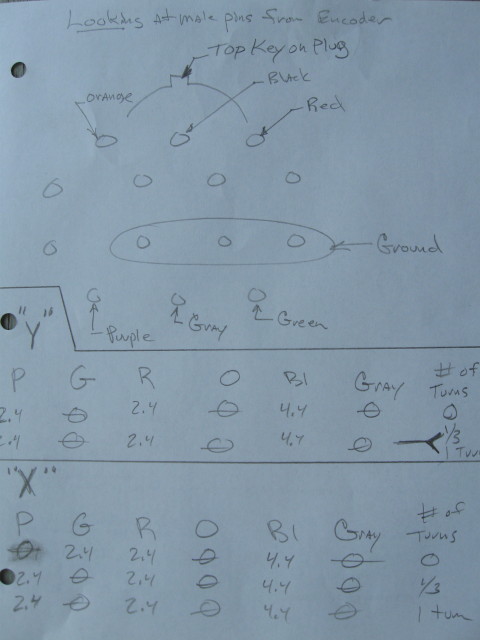

The black is the one wire I am pretty certain of, It is the one wire trace visible on the front of the differential signal chips board,

I may have access to an oscope but it would be take my stuff there, but I have a 6 VDC 140mA charger for flash light, would this work or should I get batteries? I am ok with testing and respond with results.

Attached is the raw data from the powered up mode. The volt meter was attached to ground and each wire's voltage was recorded(the number does not represent the true voltage just the area of the scale I read), the pic shows to far right side # of turns, under each letter of the color of the wire (R=red; G=green) is the value for that # of turns (note Y axes all the turns were the same reading like the 2 last turns of X axes) .
The top is a sketch of the plug looking from end of cable coming from encoder (male pins coming toward you) with square key at top, some of the openings were not used, notice the 3 pins to the right in the center are grounded pins, have wires to the pins. Is there any other info I need from the powered up temp assembly, would like to get it out of the way if we are finished.

Pretty obvious Purple and Green is one pair Red and Orange is the other.
So you'll connect the black to the 5v+ on the 7i77, grey to the ground, orange to A, red to A/, green to B, and purple to B/. If the encoder counts in the wrong direction all you need to do is swap any one of the pairs at the 7i77 (such as purple for green).

I think you probably have a 500 count encoder (2000 quadrature). That will be useful info later when your setting up Linuxcnc.

If I may ask to clarify referencing the "7i77 connector location and default jumper positions" (sheet contained in the 7i77man.pdf ) shows Encoder 0 Encoder 1 Encoder 2; is this where the A or the A/ needs to be connected, I see where the 5v+ connection is.

Yes TB3 is where all the encoder wires should be connected.
| TB3 Pin# | Function | Wire |
| 1 | QA0 | Orange X |
| 2 | /QA0 | Red X |
| 3 | GND | Grey X |
| 4 | QB0 | Green X |
| 5 | /QB0 | Purple X |
| 6 | +5V | Black X |
| 7 | IDX0 | NC |
| 8 | /IDX0 | NC |
| 9 | QA0 | Orange Y |
| 10 | /QA0 | Red Y |
| 11 | GND | Grey Y |
| 12 | QB0 | Green Y |
| 13 | /QB0 | Purple Y |
| 14 | +5V | Black Y |
| 15 | IDX0 | NC |
| 16 | /IDX0 | NC |
