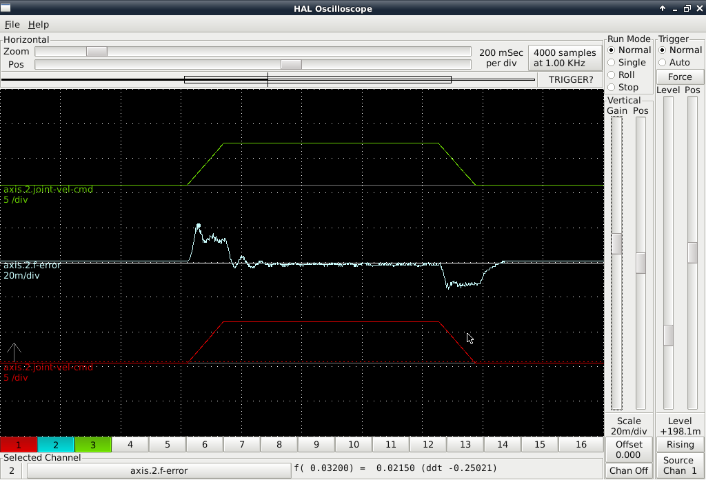

PID tuning Z went smoothly, once I relearned the use of the HALOscilloscope. The Z reference mark of the Heidenhain is at the bottom of travel and it's set up worked first time.

what are your final PID-Values after tuning the axis?
I followed the tutorial gnipsel.com/linuxcnc/tuning/servo.html but don't get the following down without oscilation (P at a max. Value of 4,5). I can also change FF1 in every direction, i got no change of behavior. i can do what i want, i have always a following error of about 0,3mm with 500mm/min.

Hello Bernd. Here is what I have at present. I am not completely happy with the Y axis. I had to limit its top speed a little as it starts oscillating at higher speeds and occasionally would trigger a following error. I played around a lot with various P, FF1 and FF2 settings, but do not yet have anything better than the following. I and D values are 0:
| X | Y | Z
P | 6.5 | 5.5 | 7.5
FF1 |0.22 | 0.228 | 0.218
FF2 |0.0021 |0.0015| 0.002
Max | 45 | 40 | 45
Acc | 50 | 50 | 50
Please let me know what values you settle on.
