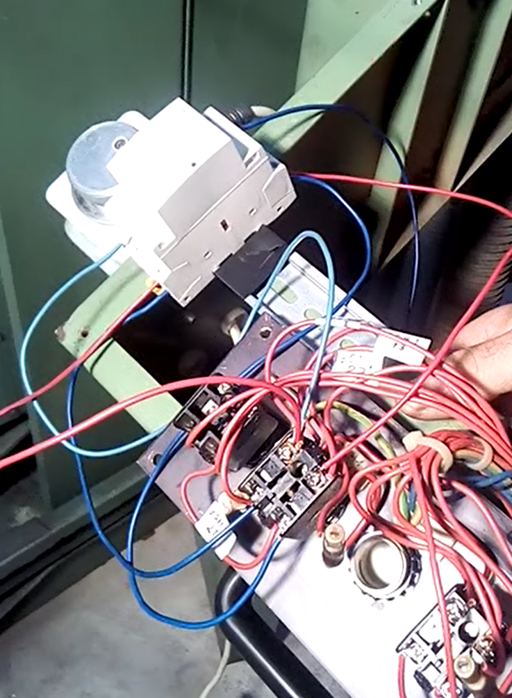

I'm sorry if I'm going to bring up a last subject again. I'm starting now.
I read this page and others before, and after seeing that in my case the SH-1 has an open contact and a closed contact, I decided to put a small contactor that also had one open contact and one closed to "replace" the Clear with coil fed by a stage of his own, turned out to work, but I'm not sure if the method is appropriate, but resulted

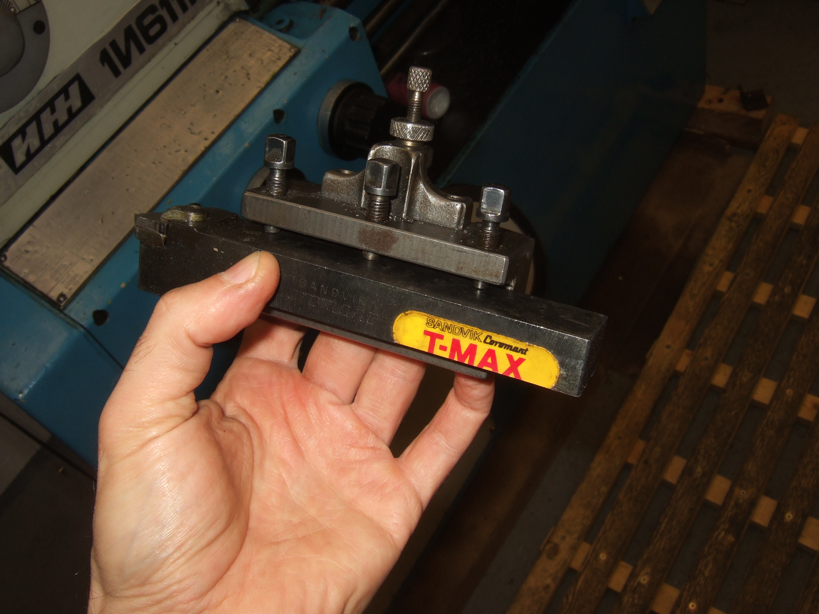

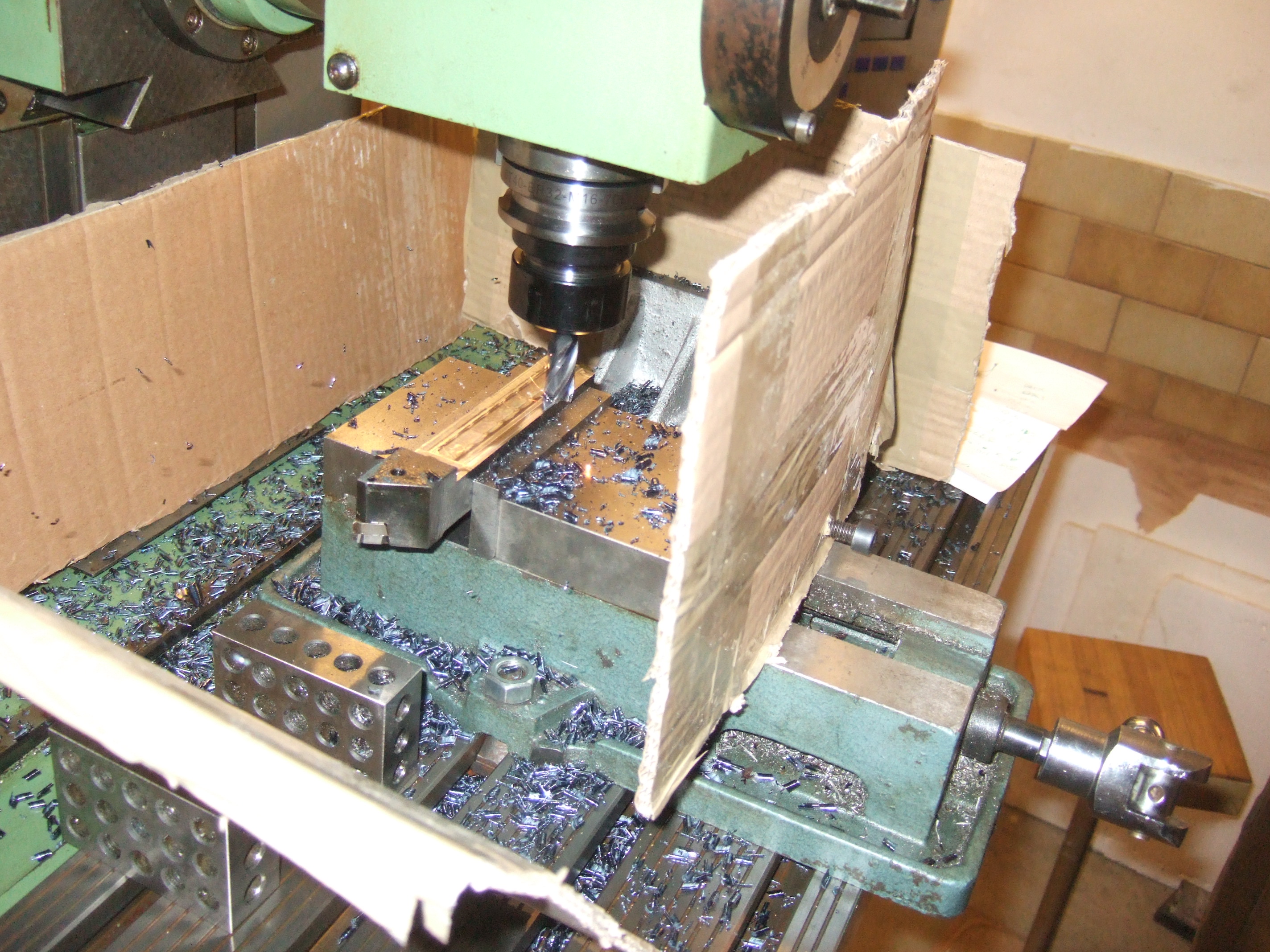

23 Nov 2018 09:40 - 23 Nov 2018 10:18 #121253
by RotarySMP
Sergey who programmed the gearbox comp for me, needed a couple of Sanvik 25x25mm insert lathe tool shanks milled down to 17mm to fit the multi-fix on his lathe.
Since I don't have the guards on, and can't use coolant, my long suffering 1/2" (12.7mm) four flute carbide end mill (bought at Boeing surplus a decade before I had the mill), was used. This mill is in pretty bad shape, from being misused as a counterbore on the lathe. It was already resharped by me on the Clarkson.
We did the first shank using a single layer program, and kept editing it and rerunning it for a lower Z. Actually the first pass, I wanted to try 0.5mm Ap, but screwed up typing and cut 5mm deep. Dumb mistake number 1. The MAHO chomped through like a champ though.
Once the first one was done, I cut/paste the code to make a gcode program to cut down the second shank in four passes.
This feeds and speed calculator feeds and speeds calculator[/url] was used, but I selected low carbon steel, rather than alloy steel. Dumb mistake number 2. Made for some fireworks, but the 1/2" (12.7mm) four flute carbide end mill was also a champ.
Unfortunately, I had an unwanted plunge cut in there. Dumb mistake number 3. This was obviously one mistake more than the mill would forgive, so the end mill gave up an edge, and is now back in the container of things needing resharpening. At least I got my stupidity on video. It seems stupidity on video is a big thing these days. I had used the LinuxCNC backplot to look for errors, and had clicked through the various views, but missed this.
Also picked up up a couple of other issues which will need to be addressed.

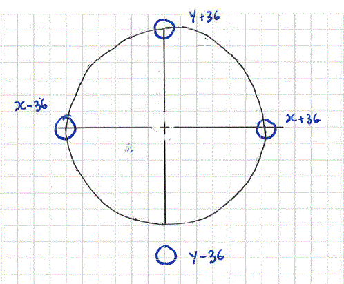

2/ The next job was to drill a 6 bolt holes for a chuck adaptor. Used a hole finder to set up pthe middle point. It turns out there is still some flakiness in the Y axis encoder. X-axis is correct, but as you can see, the scaling of the Y axis is out. It is not an INI scaling issue as the LS-403's have micron output from the EXE, and the INI is set at 1000.
Since this Y axis encoder was flakey in the past when its supply voltage was below 5V, and last week I'd wired the active USB Hub to be powered by that same little 5V PSU, that is where troubleshooting will start.
