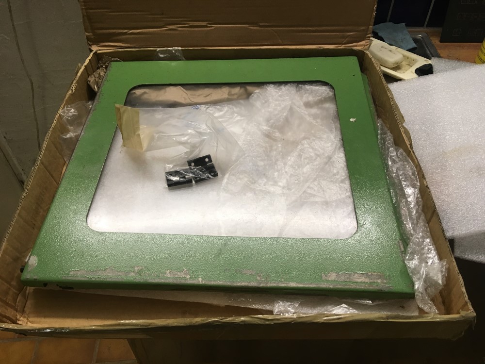

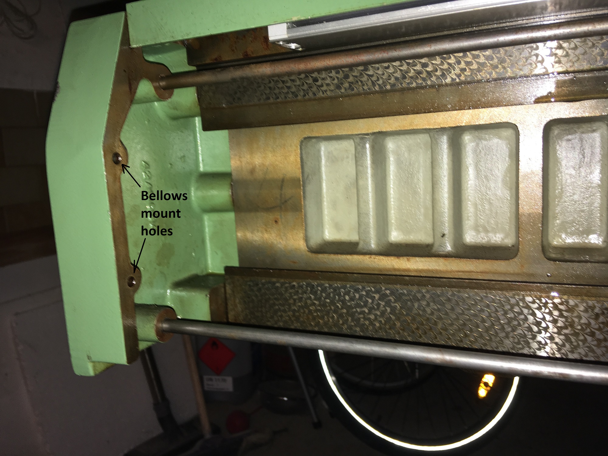

Lately I have been working on a number of different things with respect to the MAHO. None are quite finished.

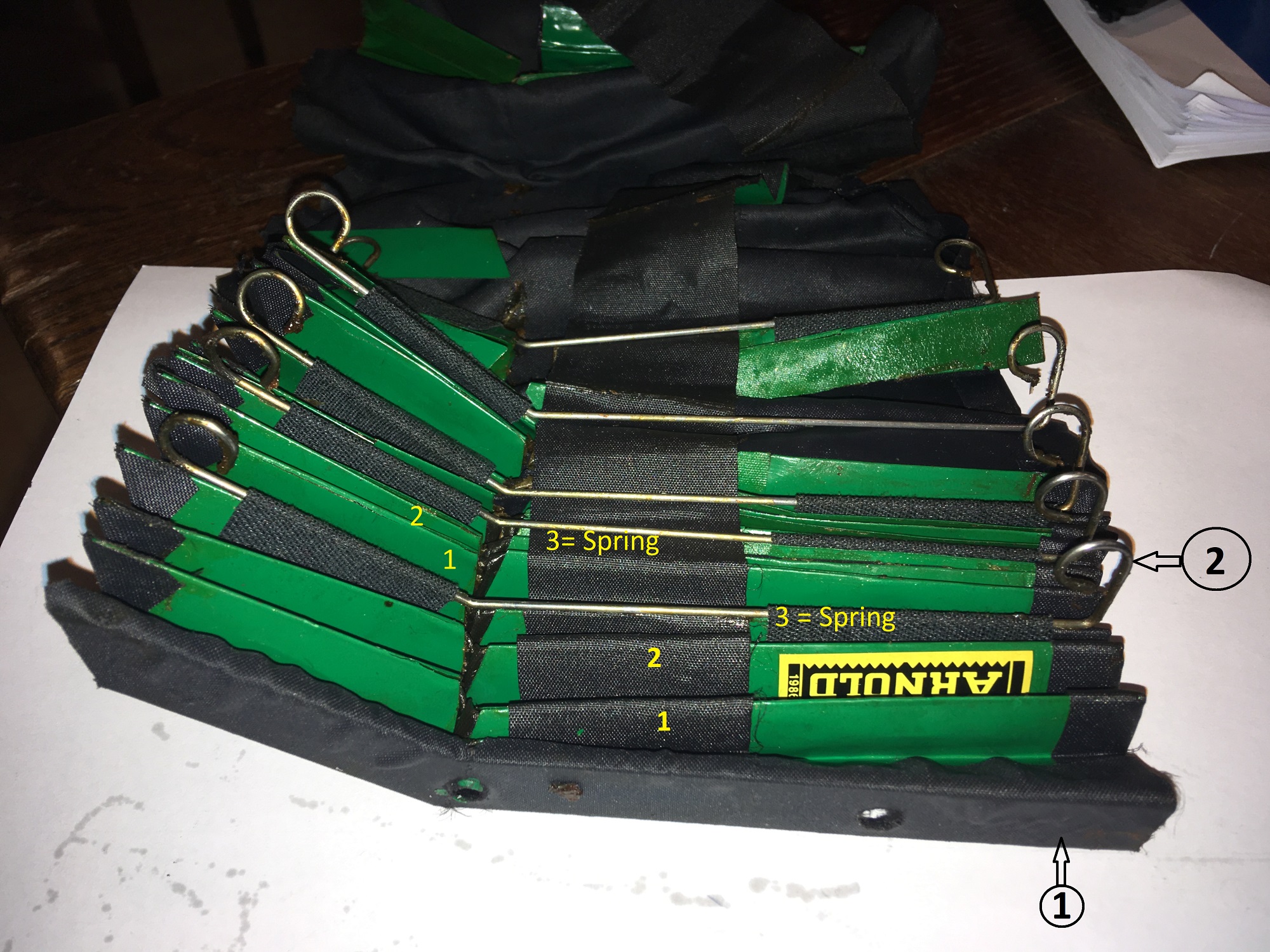

When I go it, one X-axis Bellows was missing, and the other falling apart.
You can get them off Ebay sometimes for about €200 each, but know that they disintegrate over time. A friend who has rebuilt a number of machines, gets custom bellows made in China by this company, and has been very satisfied with the quality.
BF ACCESSORY LTD..
No.023 Yan shan industry district Hebei province China
P.O.Box 061300
E: This email address is being protected from spambots. You need JavaScript enabled to view it.
T:+86 183 3178 0564

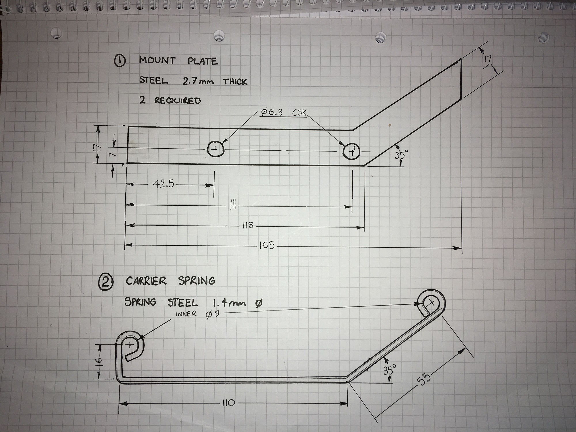

The sales guy, LeoZheng communicates really well. He promptly told me they couldn't do the wire hangers, but proposed an alternative with it guided on the PVC ribs.
Given a quote of under €100 for two bellows including shipping, I figured I'll give them a try. Hopefully they will arrive in a couple of weeks, so I can put the guarding back on.

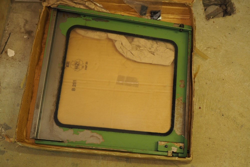

Also got lucky in Ebay. CNCBaumgartner in Germany must have parted out a MH400E, and were selling the LH side wall splash guard. This is the only guard part I didn't receive with the machine, and getting it from Rene sure saved me a lot of work. The Post lost it, so he had to spend a few hours chasing them, but it showed up last week. His service and communication was also very good.

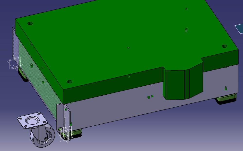

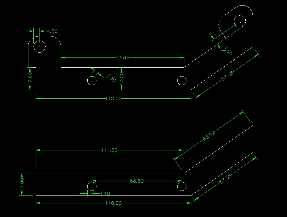

The next project is designing the machine dolly. My basement is not that big, and I can't afford the space to have the Maho 1m from walls to provide access to the electrical cabinet. The plan is a permanently mounted dolly, with a lift mechanismdriven off a single screw with LH and RH threads, so I can lift the machine with a single ratchet point, wheel it to the center of the room if I need to get into the cabinet, and return it to the corner when done.
Haven't got far on the design yet. SInce a friend has access to laser cutting steel, I tend to design more complex fabrications than necessary. There is a lip running around the casting, which make a convenient thing to lift off.

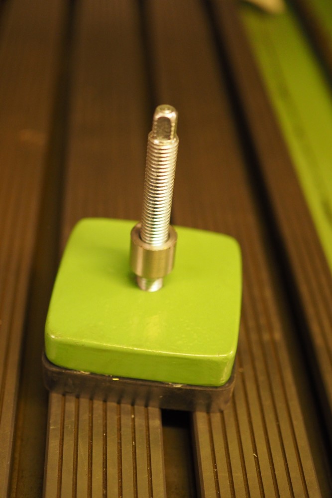

I got these vibration isolators of ebay. They are the next size up from the ones on my lathe, and I am very happy with those. Need to make longer studs to got through the MAHO base casting.
Otherwise It has been more work on the user control panel wiring. The control panel side is now finished except for the pendant, so next It needs terminating at the 7i77.
