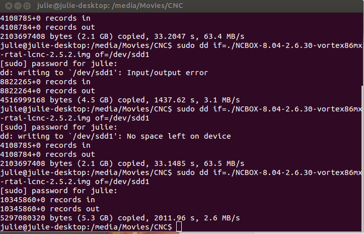

Well I finally received my new CF card, a Kingston 266X 16GB card.
I went through the usual steps and for some reason it took a few goes to get the operating system onto the CF hard. The attached screen shot shows the terminal. After each failure I entered Gparted and deleted the partition and reformated. I was going to set it to 2 partitions, but figured I could do that later if I wanted. So the last DD looks like it got it. 5.3GB transferred records in = records out, OK all good took around 30mins.
Took it and plugged it in to the NCBox and booted into the Bios and it sees the card in the CF slot. Allowing it to continue to boot I was greeted with the same "Missing operating system" message.
For reference I decided to plug the CF into the USB card reader, and plugged it into the USB port on the NCbox. REbooting the NCbox it detects 4 USB devices, but it does not see the card. Entering the BIOS it is quite happy to use the USB as boot devices, but again no such luck is seeing a card inside the reader. It also just gave the "Missing operating system" message.
I've checked the BIOS settings to be the same as in a previous post, so its not those.
Anything seem wrong in the screen shot, any other tips?

08 May 2014 06:53 #46702 by midworld08
Replied by midworld08 on topic Tiny Computer with Printer port
Since found that my USB port is rather touchy and worn, so that explains the 3 attempts.
DDed the image over to a USB, and it to is not bootable. Is there a step I am missing? Or is my img corrupt?
USB was formated to ext2 as well, and set to boot on the flags. Seems like the boot loader aka grub or such like is missing.
08 May 2014 16:43 - 08 May 2014 21:16 #46716 by ArcEye
Replied by ArcEye on topic Tiny Computer with Printer port
Hi
There is something wrong with the bootloader not being written to MBR, but unless you can re-install GRUB, that is probably it.
(from a system running 8.04 with the card in a reader, install grub and specify to install to the card MBR and give the card /boot directory as the location of the grub files)
I have withdrawn the image, I don't have time to support it, I don't use the NCBOX for anything now, sorry.
The original instructions are back up on my site at mgware.co.uk/CNC
These are what I did to install in the first place, there are also Thomas's notes of what he did to achieve the same.
Regards CF cards
I had an answer regards the problems with the Lexar cards etc and it is this.
There is a bit which needs to be set on the CF card to enable it to be booted from.
As camera card manufacturers would not think anyone would want to boot from the card, they don't set it and they will not work.
Apparantly RoBoard have also had lots of problems with similar scenarios
So the answer appears to be forget the speed, get a general purpose one not a camera card.
Thomas had all sorts of problems initially with his card as he said and it was all because it was intended for cameras

08 May 2014 21:28 #46723 by midworld08
Arceye, thank you helpful as always. I see mgware have also killed off the main download for now as well with the mirror surviving for now.
Managed to get both the CF cards I have, the 400x and 266x booting into puppy with EMC using Unetbootin. Seems something is going on with the img file and dd ing. Can't say I can find out what, and out of my depth. As you say probably the setting of something which is not well documented, but Unetbootin works so long as you have an iso.
Not sure if an ISO can be released that would remove the dd ing instead of an img. Seems the dd ing does not set the CF up right.
Its a patch for now. Can't upgrade this version so.... back to the drawing board and off to find something which I can upgrade......thanks for the support.
