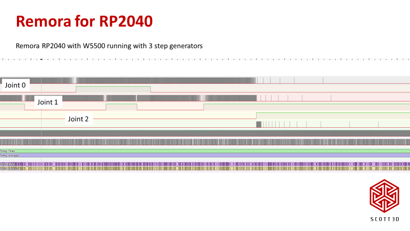

So, I've implemented a really super simple semaphore between the threads and the Ethernet data transfer, looks to have solved the data corruption. My hunch about the virtual machine causing the following errors was correct. The servo thread was just to slow for the communication and updates. The video is showing the hotel room test bed running with a 5000ms servo thread.

With the config file all of the pins could be configures as IO.
Below is the step and direction output, just to show it's actually working...
Replied by scotta on topic Remora for RP2040
The current 40khz step rate is not too bad. I think we should be able to get it up to about 100kHz.I'm keen for this or something like this, just for GPIO even.

The controller board will also need to have a configurable IP address, a feature that has been requested for the NVEM, EC300 and EC500. This could be included in the uploaded config file (when I get it working), and a method to force a default config on boot to "reset" the board just in case we need to.
A good question and something that needs to be considered given the limited IO of a Pico. Currently the Remora Ethernet component has a fixed IP address it is looking to communicate to. If the LinuxCNC component is modified to accept a configurable IP address it would be possible to load multiple instances, in LinuxCNC, talking to different boards.I'm not familiar with Remora - will it be possible to u,se multiple of these?

29 May 2023 00:06 #272375
by scotta
The port for the RP2040 is not utilising the PIO, so we will be limited like the 3d Printer boards.
Hi Aaron,The 2040 is an interesting chip.
I hope it grows in popularity.
Do you think with the cores and the 4 state machines this could be faster than the current 3d printer variants?

31 May 2023 00:31 #272533
by scotta
The PIO on the pico will need a learning curve for a DDS style step gen but I would think a high speed encoder interface could nearly be off the shelf...
