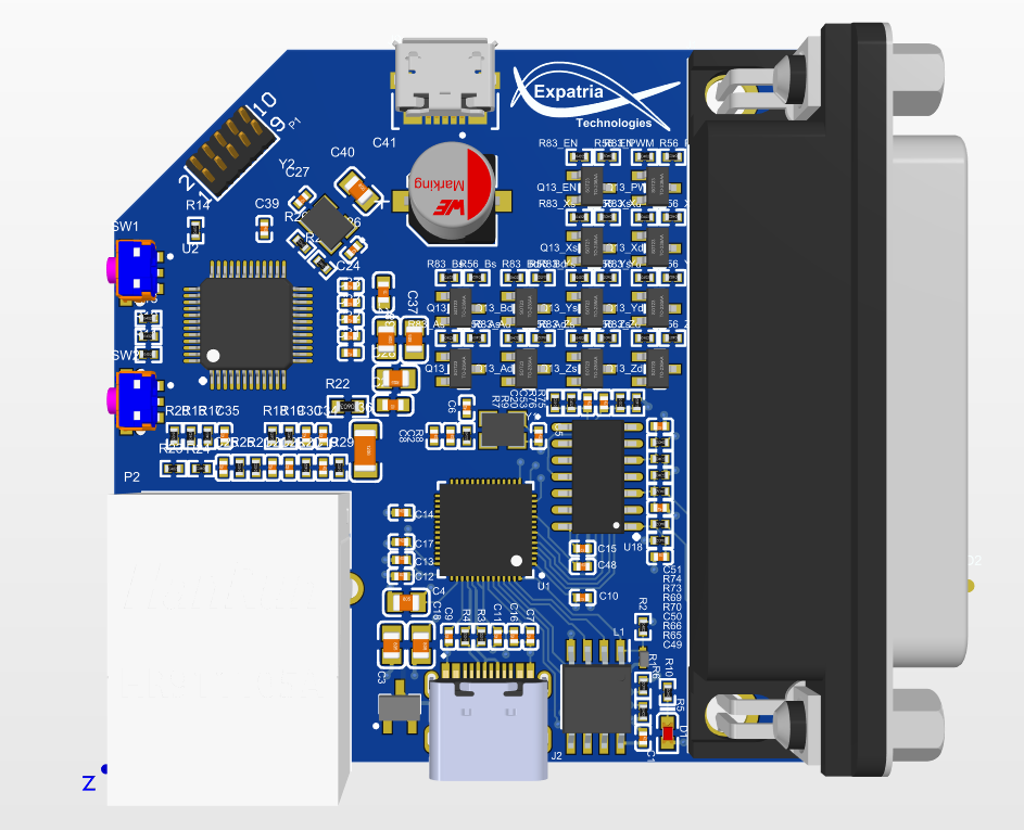

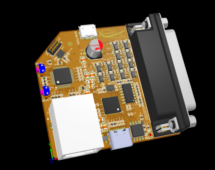

03 Jun 2023 15:37 - 03 Jun 2023 15:40 #272821
by drewnabobber
Replied by drewnabobber on topic Remora for RP2040
Got this routed and ready for fab. Going to let it stew over the weekend Please let me know if you have any feedback. I considered adding the spindle encoder interface from the FlexiHAL on here as there are a few free pins, but between the differential transceiver and the voltage translation requirement I have left it off to keep the design as simple and focused (cheap) as possible. Perhaps an encoder focused board like our EtherHAL prototype would be interesting to consider?

03 Jun 2023 21:20 #272840
by Aaroncnc
Replied by Aaroncnc on topic Remora for RP2040
Could you design the board to take a spindle encoder and break out any extra pins for people to expand it themselves but have it made with them depopulated?
No sense leaving things on the table if you can help it

03 Jun 2023 23:36 - 03 Jun 2023 23:39 #272844
by drewnabobber
Will think on a better way to do it. Left it off because between another rj45 connector plus at least two more ics it made everything bigger and more busy than I was going for. We already have the encoder on FlexiHAL if people are going that direction. Maybe use a smaller connector. Not sure how many users are going to be interested in soldering their own parts so if we do it should be done right.
I will route the unused pins to the programming header and then they will be available for playing around with external circuits.
Last edit: 03 Jun 2023 23:39 by drewnabobber.

04 Jun 2023 00:33 #272850
by scotta
Replied by scotta on topic Remora for RP2040
Before heading to the airport for the flight home I loaded on KiCad, spent the time at the airport comparing schematics and scratching my head. I get home and you've already got it nearly done!!! Wow. Looks great.
It would be good to have the spare pins available on the header.
GPIO29, 25, 24, and 23 are not available on the Pico but could also be available. An onboard led (GP29) would be handy for showing comms status, testing etc.
Did you have a plan for pin allocation? I've adopted the static config ability from FlexiHal together with the original JSON config so we could have the static config ready to go for this out of the box.
Also, I think I can improve the Ethernet performance. I found my Mbed STM32 code that I was playing with for the W5500 in interrupt mode (need to finished that for the STM32....). The RP2040 W5500 code already as DMA capabilities so we just need to take advantage of the receive interrupt vs polling. Not that it will impact the second core running the main code, but at least the servo thread can be optimised some.

04 Jun 2023 00:45 - 04 Jun 2023 00:49 #272852
by scotta
I've just had a question on one of the YouTube videos on the NVMPG. When you look at the pin routing, maybe make the spare pins on the UART capable pins. That way people could also attach a TTL serial to RS232 adaptor and use the NVMPG in a really simple way.
Would need the opto's for the encoder like Arron suggested for two / 3 channels. Maybe that could be an add on board including a MAX232.
www.aliexpress.com/item/4000587246651.ht....product.mainProduct
So some spare 3V3 and ground pins would be good to.

04 Jun 2023 00:57 #272854
by scotta
Just for my understanding. Why does the PicoBob use transistors on each individual output rather than a package like the SN74ALVC164245?
The NVEM / EC300 / EC500 use this IC for the outputs and inputs. On the NVEM it is directly used to drive the stepper outputs.
