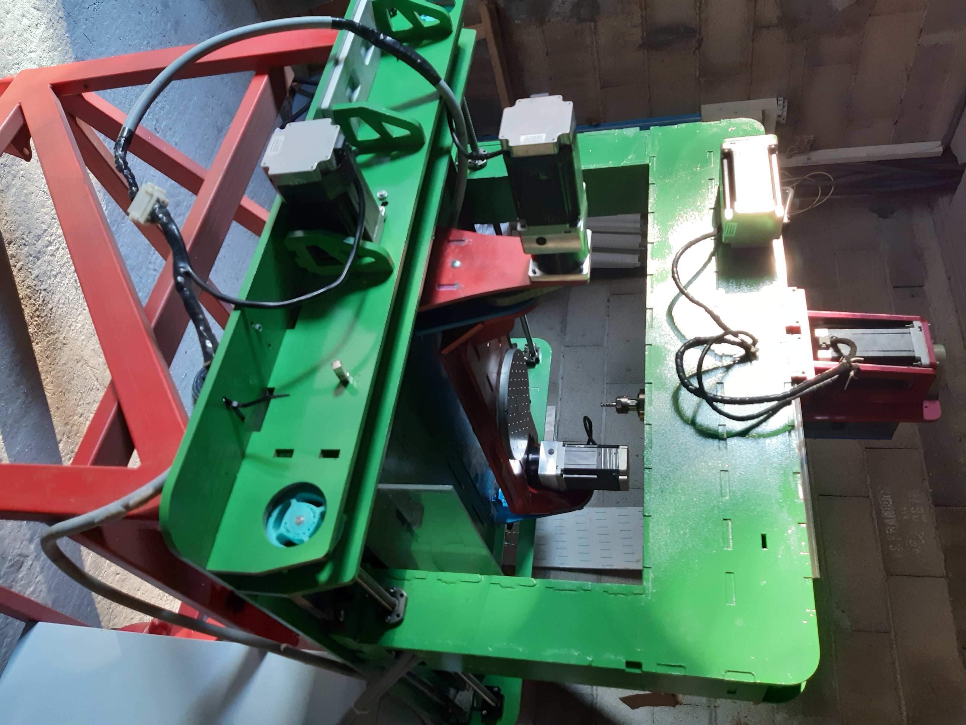

Good morning all ,
I am new to the form and I often link your "posts" because I built a 5 axis CNC with LinuxCNC 2.7.14 control under Dabian. I apologize because I am not completely bilingual. I live in the south of France. All your information allowed me to move forward with the design of my machine. In turn I can share my experience to help the community.
I attach a photo illustrating my machine.
The characteristics of my machine are X = 560mm Y = 340mm Z = 180mm A = + - 95 ° C = -999 ° / 999 ° for a weight of about 400 Kg. All the structure of the machine was laser cut and assembled .
I cannot finalize my project because I am stuck on the xyzac-trt-kins module for carrying out 5-axis continuous machining. I have read all the instructions for halcomplie --install correctly but it does not work. Before going further in my explanations, I join my two configuration files .hal & .ini.
I hope to have presented the project well. (As I am not used to discussing on forums, I may have missed out on essential things. Please let me know. Can someone help me solve my problem ?.
thank you in advance

Since your config works for 3+2 I would expect it to work for 5 axis operation as well.
For Tool point coordinated operation you need to provide xyzac-trt-kins with the physical offsets of the pivots of your A and C axis. If these values are not correct then the matrix calculations done in the kinematic file will be all wrong and the tool motion all over the place.
In your config you have set:
net :tool-offset motion.tooloffset.z xyzac-trt-kins.tool-offset
setp xyzac-trt-kins.x-offset 36.056
setp xyzac-trt-kins.y-offset 0
setp xyzac-trt-kins.z-offset 0
which seems wrong to me as the rotational axis of a is along the x axis. Why would you have an x-offset?
Have you looked through this:
docplayer.net/49845107-5-axis-machine-to...ion-in-linuxcnc.html
Also note that there is a simulation configuration for the xyzac-trt-kin in the sim folder.
I don't have any experience with Fusion360 so I don't know if you can or need to configure your pivot offsets in the post processor.
It might be worth to start out with testing 4axis simutaneous operation and then go on to 5 axis
