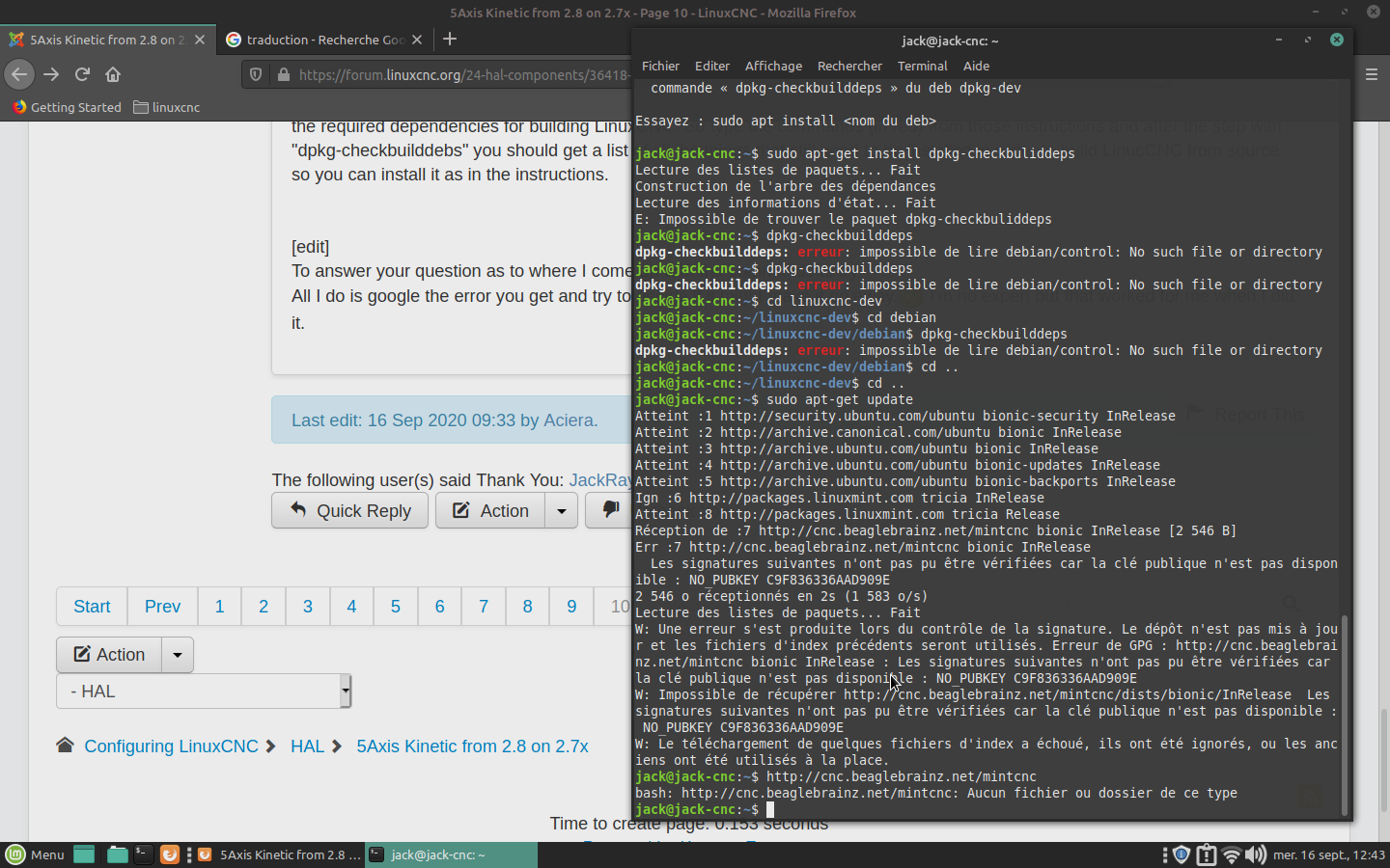

16 Sep 2020 10:44 #182427 by JackRay
Replied by JackRay on topic 5Axis Kinetic from 2.8 on 2.7x
I performed a "devscripts-dpkg-dev python without problem. The following line failed because it asks me to make an" update "which I did. But there I have an error, and can not go any more far.
Thank you

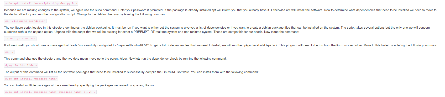

16 Sep 2020 11:23 #182431 by Aciera
Replied by Aciera on topic 5Axis Kinetic from 2.8 on 2.7x
Well, you didn't follow the instructions.
in the directory ~/linuxcnc-dev/debian$
you need to run the command: ./configure uspace
after that you run: dpkg-checkbuilddeps
16 Sep 2020 17:40 #182450 by JackRay
Yes, I followed the instructions exactly, and it asks me to do an "update" which does not work:P
16 Sep 2020 18:19 - 16 Sep 2020 18:23 #182451 by Aciera
Ok, that complicates things. So lets try if we can get the required key installed.
Import the key:
sudo apt-key adv --keyserver keyserver.ubuntu.com --recv-keys C9F836336AAD909E
try the update again:
sudo apt-get update
If this does not work we'll go back to dealing with the missing dependencies one by one.

16 Sep 2020 18:28 #182452 by JackRay
it was not complicated enough ...
