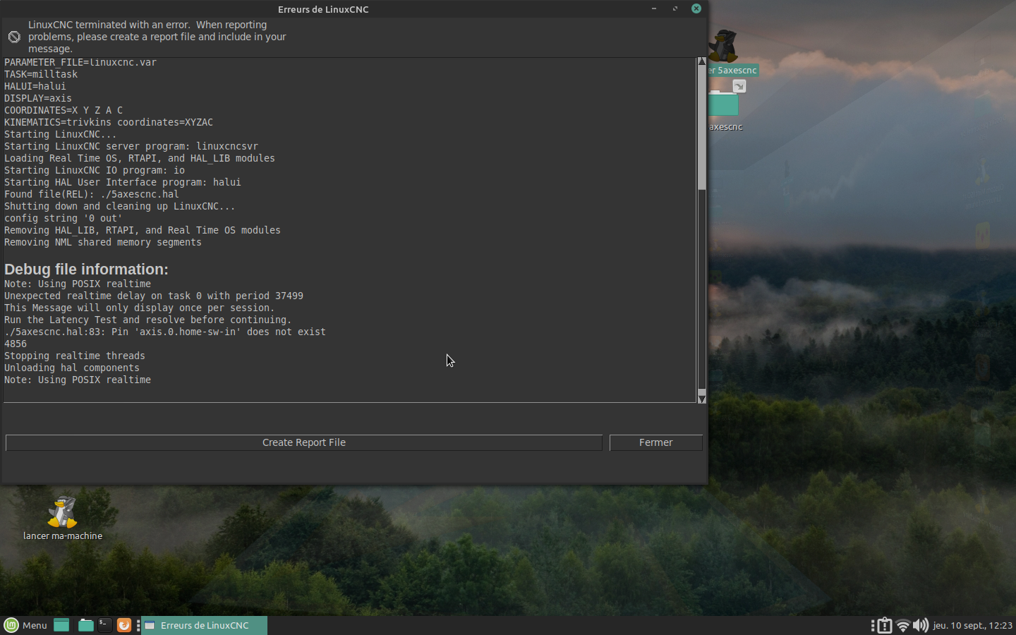

10 Sep 2020 10:24 #181604
by JackRay
Replied by JackRay on topic 5Axis Kinetic from 2.8 on 2.7x
I made the connections, but I have a configuration problem.
Here is the message
Thank
Here is the message
Thank

10 Sep 2020 11:07 #181611
by JackRay
to all ,
I share my two .hal / .ini files where the positioned 5-axis configuration works perfectly with (emergency stop / limit switch / reference point).
I would like to thank you all for your help and especially Aciera who had a lot of patience with me. I will therefore continue with the xyzac-trt-kins to make a machine with 5 simultaneous axes.
thanks a lot for your help

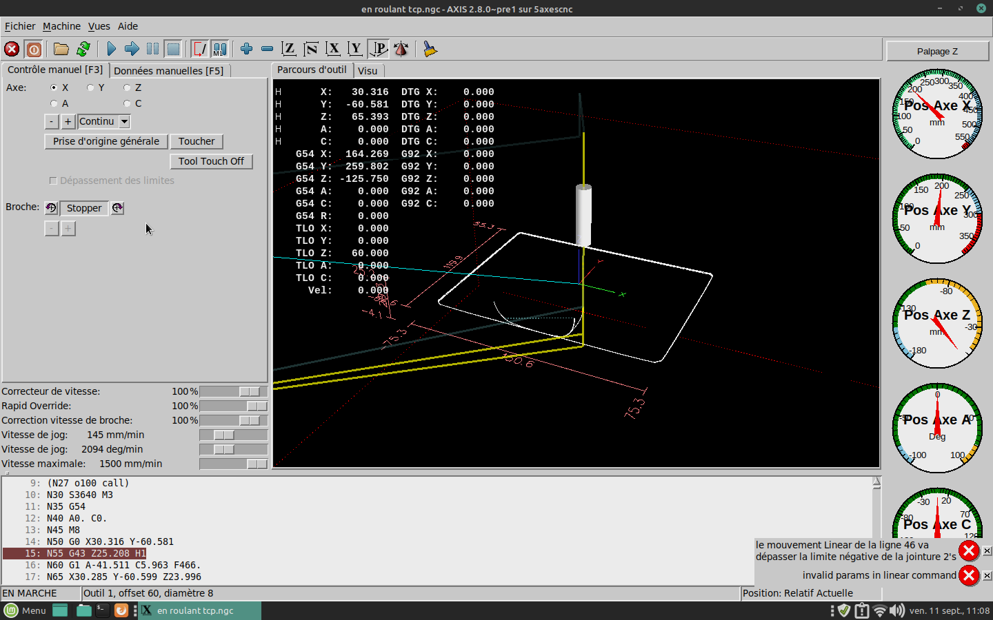

10 Sep 2020 19:55 #181674
by JackRay
Good evening
I have configured my .hal & .ini files. or I included the loading of the module "xyzac-trt-kins" + connections to the HAL (length compensation in "z"), and I do not understand the behavior of my machine.
with each movement of axes a message announces that I will exceed the limits in positive or negative ...
I used a G54 to make my zero machine.
frankly I don't understand much.
if you have any tips?
thank you
thank you
- Posts: 4818
- Thank you received: 2176
11 Sep 2020 04:52 - 11 Sep 2020 05:35 #181719
Replied by Aciera on topic 5Axis Kinetic from 2.8 on 2.7x
Limits are the values you entered in the ini file for each axis/joint. That is independent on where you zero the axis only on the home position and the length of travel possible for each joint/axis. Of course you will want to setup your workpiece so that there is enough space for the machine to move.
The contoller will try to move the tool in a position where the TCP follows the part being rotated. Depending on your pivot lenghts and tool lenght that may well exeed your limits.
Have you set up your pivot distances correctly?
[edit]
best approach might be to start with the rotary table and just leave the tilting table at 0. As you rotate the rotary you should see the tool folowing the table.
Maybe have a look here:
forum.linuxcnc.org/10-advanced-configura...nematics-x?start=270
forum.linuxcnc.org/media/kunena/attachme.../5-axis-machines.pdf
[edit]
Last edit: 11 Sep 2020 05:35 by Aciera. Reason: Clarifications
