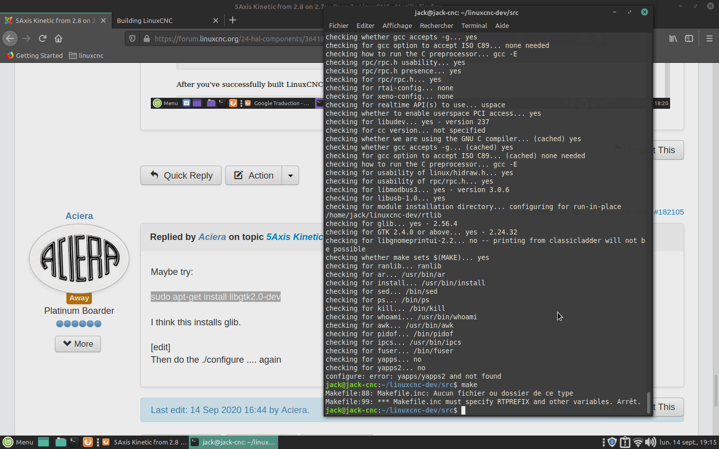

14 Sep 2020 17:03 #182107
Replied by rodw on topic 5Axis Kinetic from 2.8 on 2.7x
It always takes some time finding all of the dependencies so take time to read the errors, search and resolve. It is worth it though.

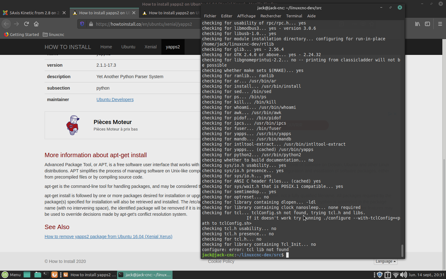

14 Sep 2020 17:20 #182114
Yes, A quick google says to try
See howtoinstall.co/en/ubuntu/xenial/yapps2
So onto the next one.
sudo apt-get install yapps2See howtoinstall.co/en/ubuntu/xenial/yapps2

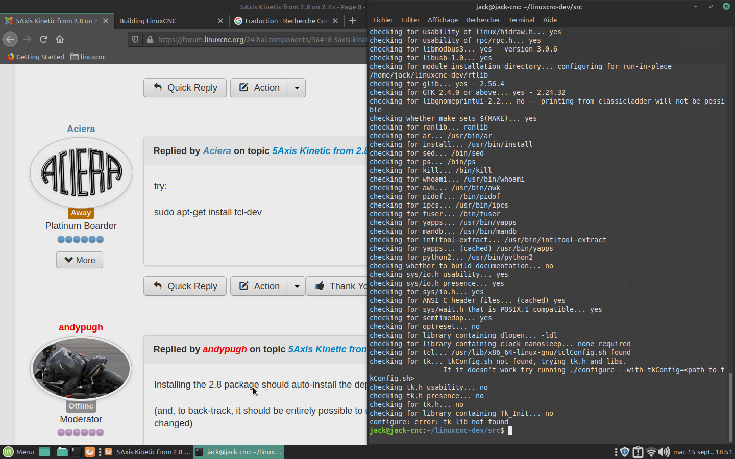

15 Sep 2020 04:21 #182179
Replied by Aciera on topic 5Axis Kinetic from 2.8 on 2.7x
try:
sudo apt-get install tcl-dev
15 Sep 2020 11:36 #182210
Replied by andypugh on topic 5Axis Kinetic from 2.8 on 2.7x
Installing the 2.8 package should auto-install the dependencies.
(and, to back-track, it should be entirely possible to use the latest kins modules from 2.8 in 2.7 as the kins file format hasn't changed)
But 2.8 is definitely where you want to be for non-trivial kins.

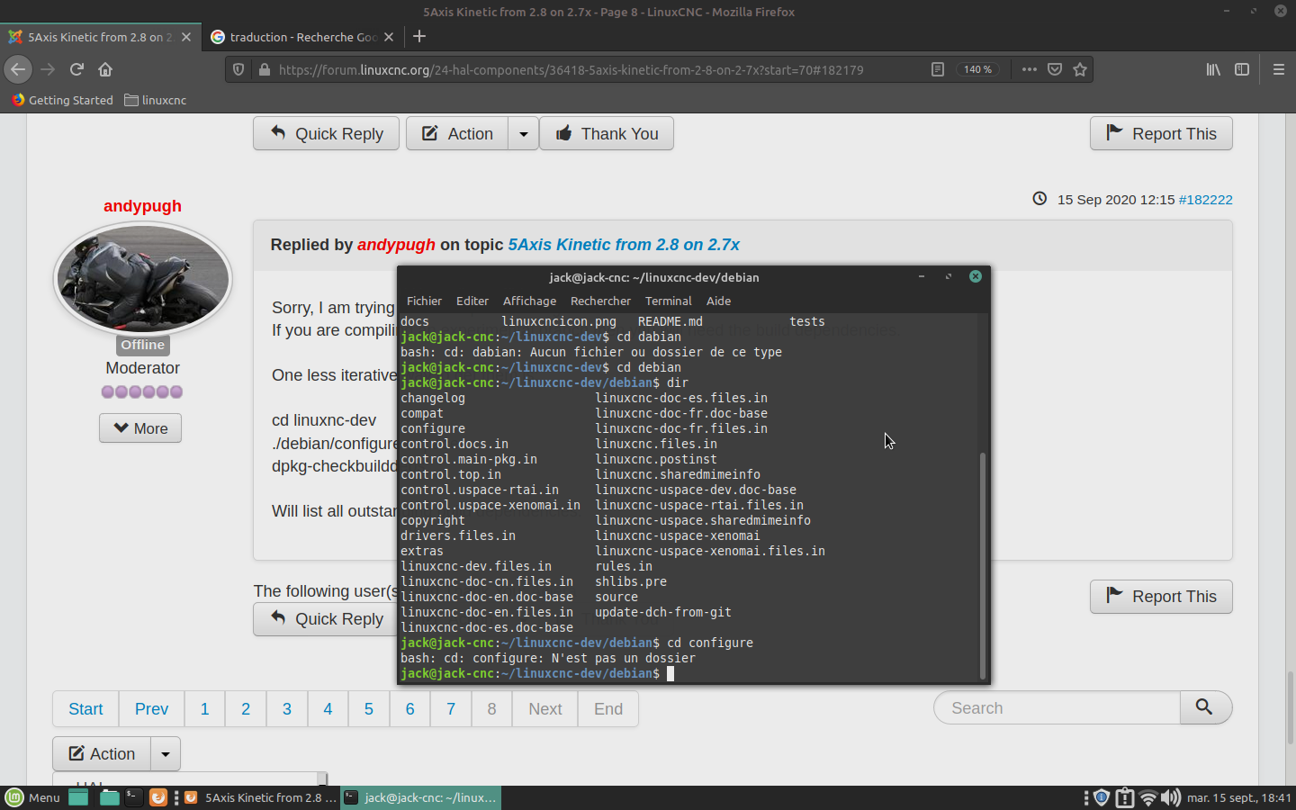

15 Sep 2020 12:05 #182218
@Andy
Not sure what you mean. We are trying to install deweys switchkins branch using his how-to: www.panix.com/~dgarrett/stuff/s_kins_guide.txt
Are you saying there is a shorter way to get the dependencies installed?
15 Sep 2020 12:15 #182222
Sorry, I am trying to catch up after being distracted for a while.
If you are compiling an experimental branch then you will need the build dependencies.
One less iterative way to get them is:
cd linuxnc-dev
./debian/configure uspace
dpkg-checkbuilddeps
Will list all outstanding build dependencies.
cd linuxnc-dev
dpkg-checkbuilddeps
