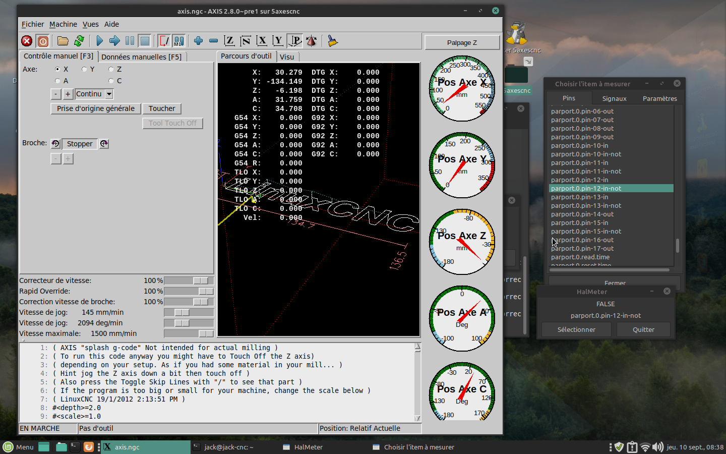

10 Sep 2020 06:59 #181563 by JackRay
Replied by JackRay on topic 5Axis Kinetic from 2.8 on 2.7x
Hello ,
- I was therefore able to carry out my configuration and run Lcnc 2.8 without error.
- Effectively the emergency stop button and the original socket contacts no longer work with version 2.8.
- However, I checked with "halmetre" and all the signals pass without problem ??? I have communication with my "break out" card.
- If again you can help me, i attach my .hal & .ini file ?
Thank you for your attention
10 Sep 2020 07:09 #181565 by Aciera
Replied by Aciera on topic 5Axis Kinetic from 2.8 on 2.7x
So does the external emergency stop button fail to stop the machine?
I'm not clear what you mean by " original socket contacts".
Can you start the machine through the gui or does the external emergency stop signal keep the gui in estop?
10 Sep 2020 07:24 #181568 by Aciera
You have
net estop-out => parport.0.pin-01-out
net estop-ext <= parport.0.pin-10-in-not
#net estop-loop parport.0.pin-01-in iocontrol.0.emc-enable-in
and farther down:
net estop-out => iocontrol.0.emc-enable-in
This looks a bit odd:
If you have your external estop connected to parport.0.pin-10-in-not then you have not connected the signal estop-ext to anything
also estop-loop parport.0.pin-01-in is commented out
