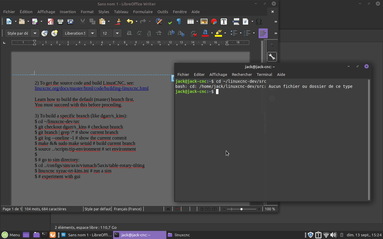

Thanks, but I'm really not good on linux.
it starts well I do not have the files attached in my tree structure ...

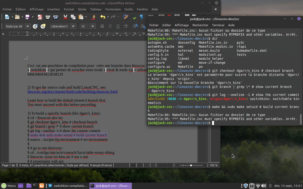

13 Sep 2020 13:55 #182010 by JackRay
Replied by JackRay on topic 5Axis Kinetic from 2.8 on 2.7x
I got to go until there.
but the error ??
thank you very much, but without you it's impossible to do it.

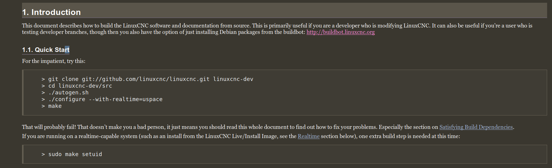

13 Sep 2020 14:06 #182011 by Aciera
Replied by Aciera on topic 5Axis Kinetic from 2.8 on 2.7x
Have you completed step 2?
2) To get the source code and build LinuxCNC, see:
linuxcnc.org/docs/master/html/code/building-linuxcnc.html
Learn how to build the default (master) branch first.
You must succeed with this before proceding.
There you need to first try this:
It this fails, as it probably will, you will need to install the missing dependencies.
Maybe this helps: (I have not actually watched the whole thing)
