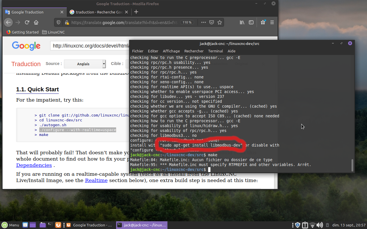

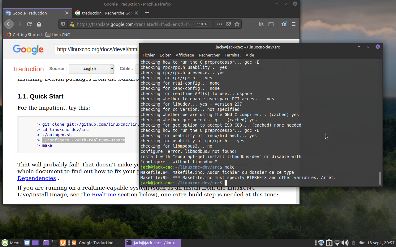

13 Sep 2020 19:01 #182032
by JackRay
Replied by JackRay on topic 5Axis Kinetic from 2.8 on 2.7x
- Posts: 21961
- Thank you received: 7478
13 Sep 2020 20:27 #182034
Replied by tommylight on topic 5Axis Kinetic from 2.8 on 2.7x
- Posts: 4818
- Thank you received: 2176
14 Sep 2020 05:51 #182054
Replied by Aciera on topic 5Axis Kinetic from 2.8 on 2.7x
As tommy highlighted, installl with:
sudo apt-get install libmodbus-dev
There might be a few more like this. Sometimes it will require a bit more research to figure out what to install.
The following user(s) said Thank You: tommylight, JackRay

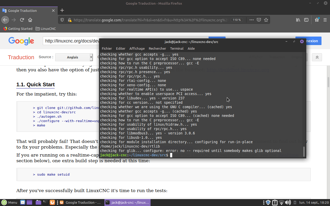

14 Sep 2020 16:24 #182102
by JackRay
- Posts: 4818
14 Sep 2020 16:42 - 14 Sep 2020 16:44 #182105
Maybe try:
sudo apt-get install libgtk2.0-dev
I think this installs glib.
[edit]
Then do the ./configure .... again
[edit]
Last edit: 14 Sep 2020 16:44 by Aciera.
