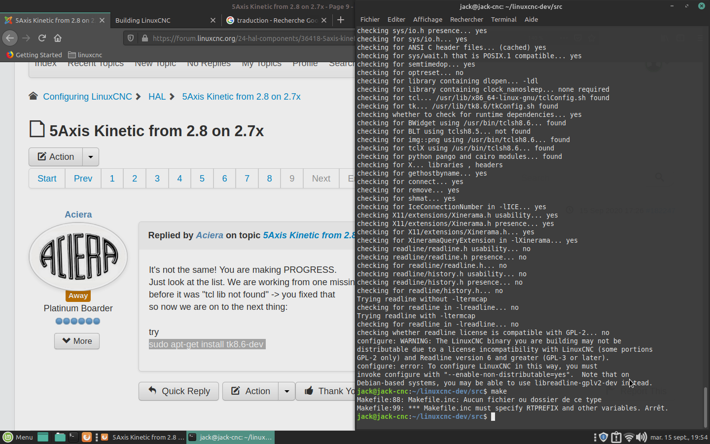

Replied by Aciera on topic 5Axis Kinetic from 2.8 on 2.7x
It's not the same! You are making PROGRESS.
Just look at the list. We are working from one missing component to the next:
before it was "tcl lib not found" -> you fixed that
so now we are on to the next thing:
try
sudo apt-get install tk8.6-dev
try

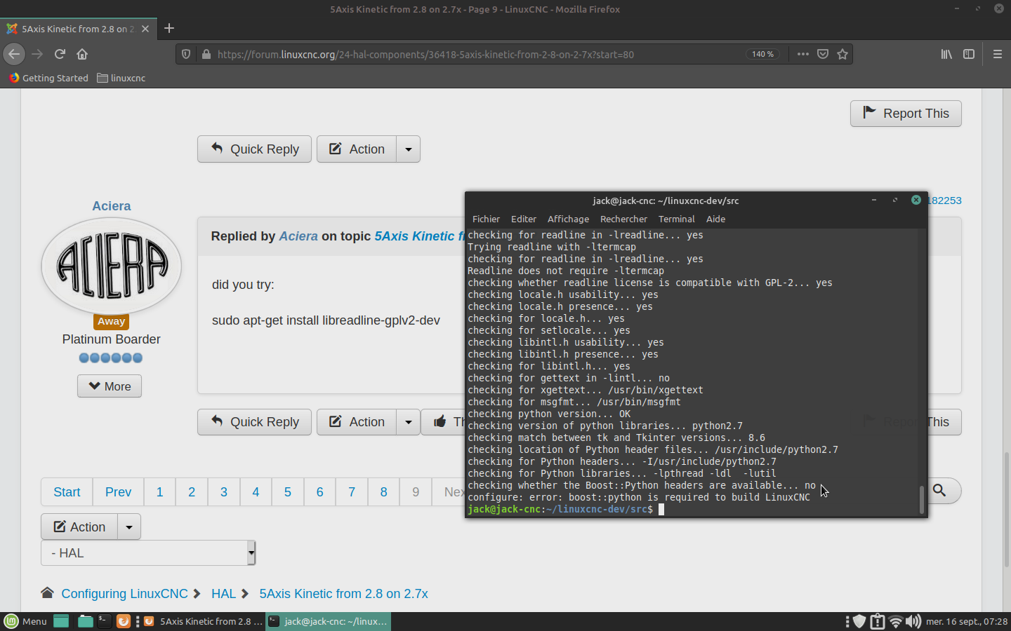

15 Sep 2020 18:07 #182253
did you try:
sudo apt-get install libreadline-gplv2-dev
- JackRay
- Posts: 226
- Thank you received: 14

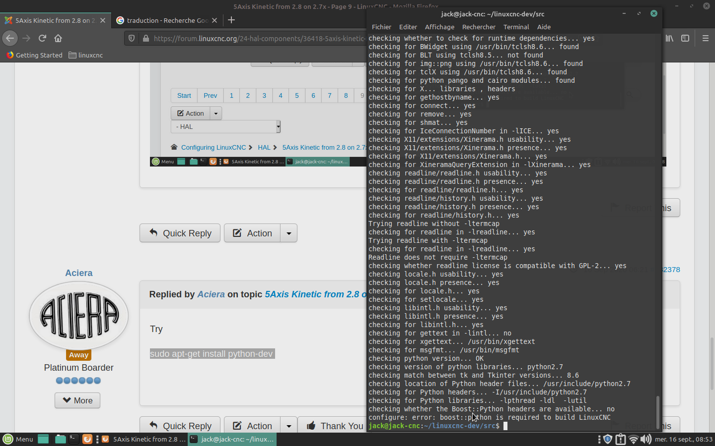

16 Sep 2020 06:21 #182378
Try
sudo apt-get install python-dev
- JackRay
- Posts: 226

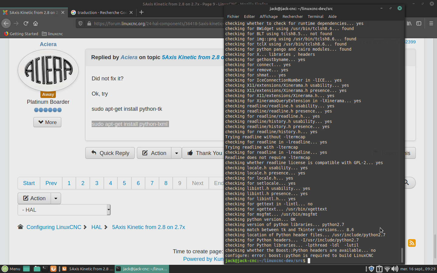

16 Sep 2020 07:20 #182399
Did not fix it?
Ok, try
sudo apt-get install python-tk
sudo apt-get install python-lxml
Ok, try
- JackRay

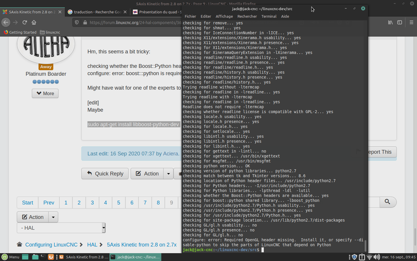

16 Sep 2020 07:35 - 16 Sep 2020 07:37 #182402
Hm, this seems a bit tricky:
checking whether the Boost::Python headers are available... no
configure: error: boost:::python is required to build LinuxCNC
Might have wait for one of the experts to look at this.
[edit]
Maybe
sudo apt-get install libboost-python-dev
[edit]
Maybe
Last edit: 16 Sep 2020 07:37 by Aciera.
- JackRay
- Posts: 226
