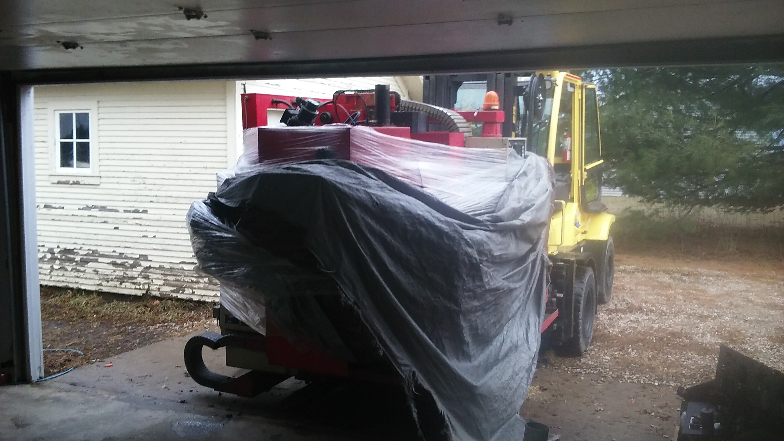

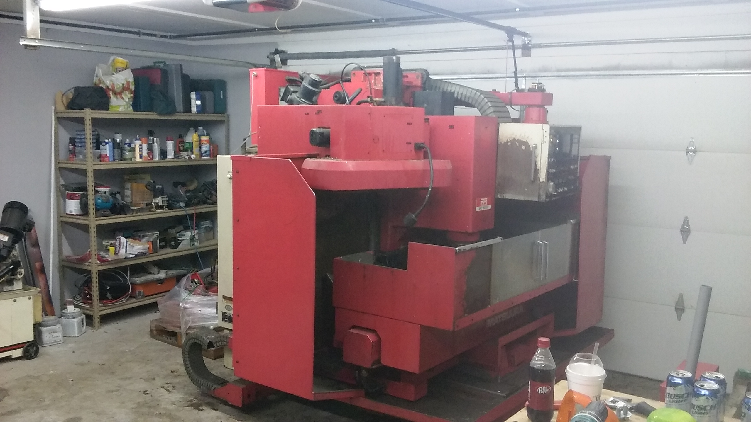

The mill showed up in the rain, 30mph winds, and then turned to sleet. Got it in the garage though. Looked smaller in the previous owners shop..... Time to start getting it in place and begin the conversion.
Got a bunch of spare parts also.

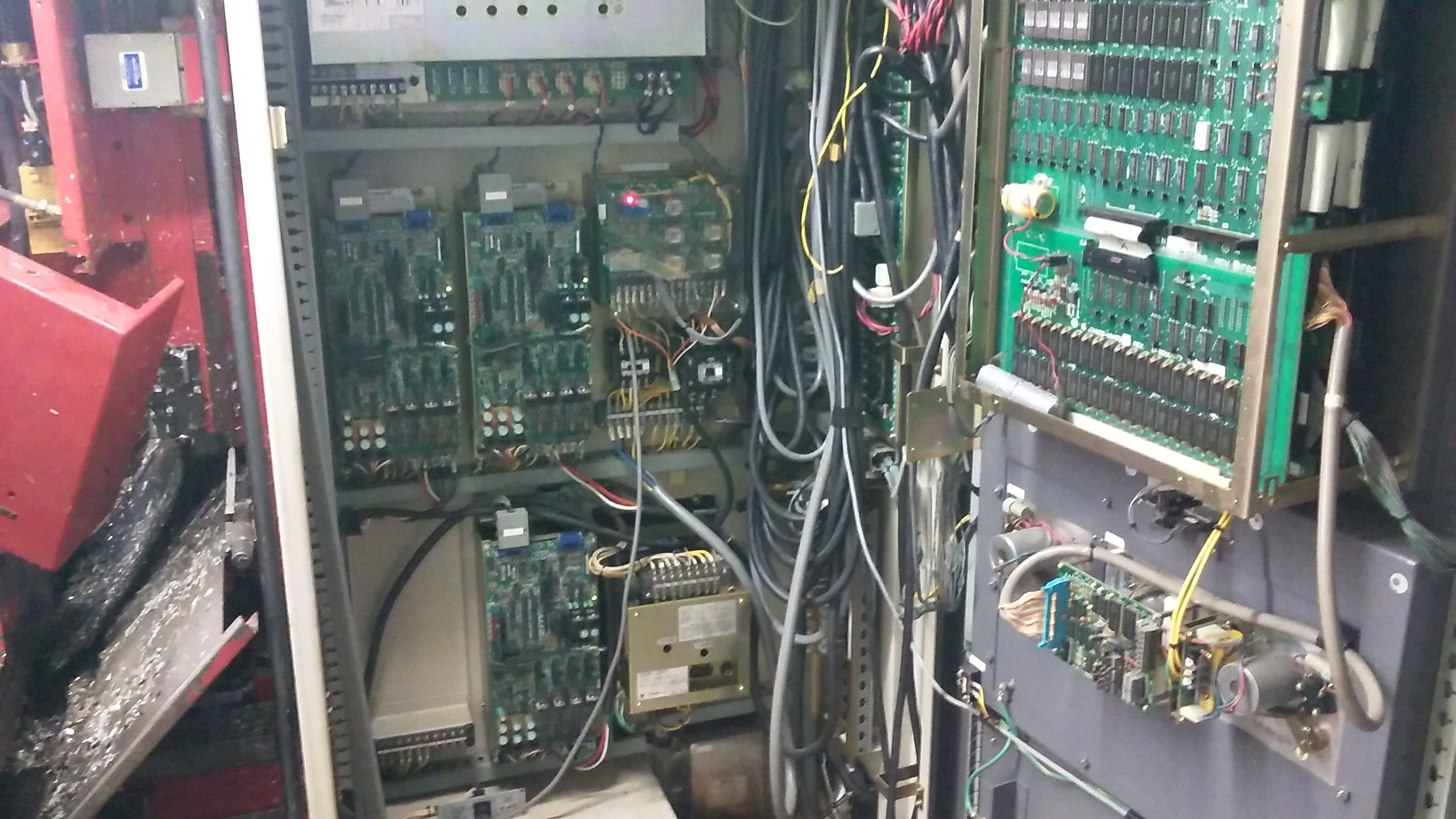

Ok.... Here is the factory electronics and enclosures.
I am ordering my Mesa boards tomorrow so I can begin the retrofit. If anybody could give me hand or pointers on which plug the encoder signals, vfd signals, analog +/- 10v on servo drive, and the enable would be great. I have done a couple retros before, but this one is very intimidating to me for some reason.
I am also thinking I can just remove the electronics form the enclosure door and all my signal wires should be there. Not completely sure though.

Take it one step at a time, everything complicated has to start a something simple .......and get complicated by the way.
That looks intimidating for sure, but do start by checking everything before you start ripping things off.
I usually do a complete check, take 2 days off to think about it, check it again, allow one more day for thinking, only then start removing things but again checking everything. Takes more time but by the time i start, i already have it finished in my head. Then there is the part of working with unknown electronics and checking several times before actually connecting something. I use a DVM and resistors a lot to test things, even when i have schematics. In electronics it takes a split second and there is no going back.
Take a lot of pictures of everything, post them here, plenty of experienced members here eager to help.

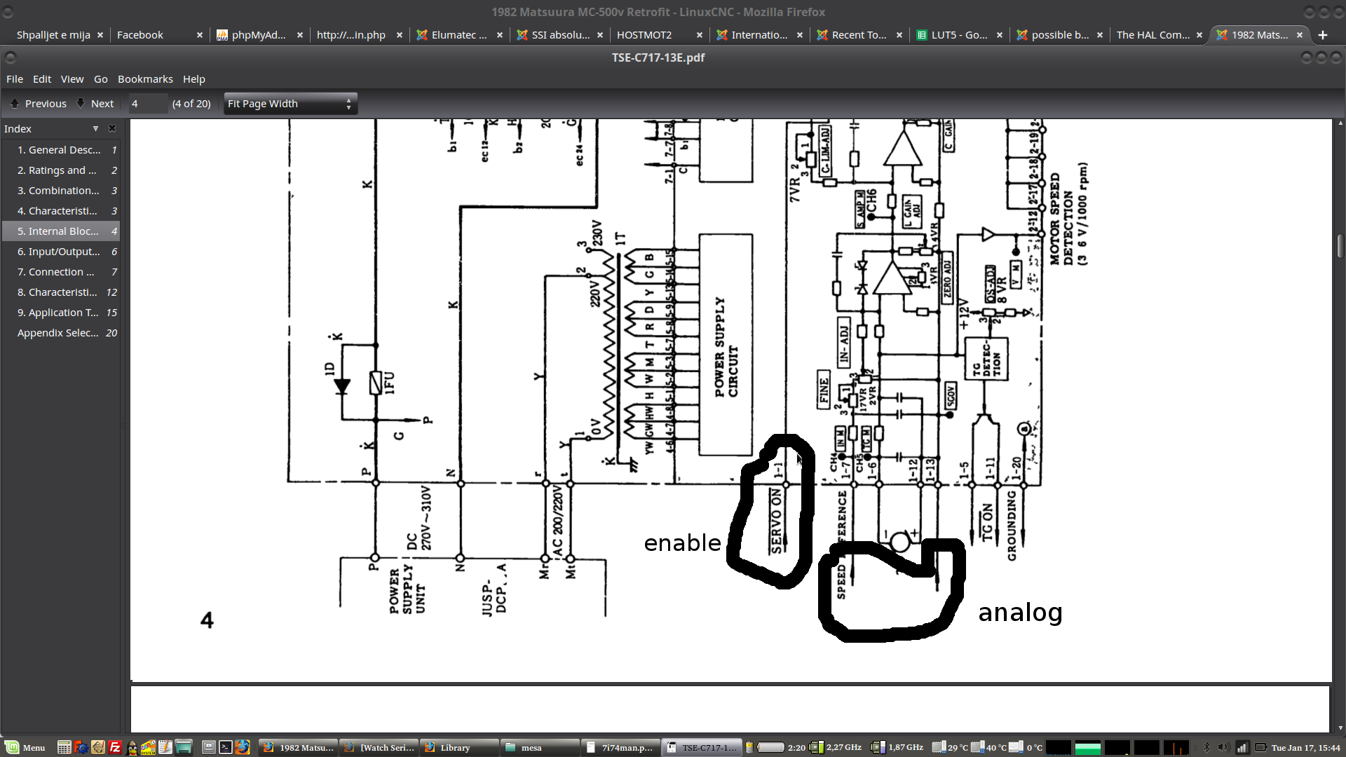

I am sitting here looking at it all now. Going over the manuals for the drives also and can not seem to find out which wires are for my drive enable and +/-10 signal. I have found that they are all located in a connector at the top of the servo drive. The manual is just real clear on what this connector is and what pins are to what.
I have located all the encoder wires and I did check that they are the 5v encoders and not the 12v ones that some came with.
Would like to find the servo drive wires first thing and then I can test them out for movement with a small power supply to verify functionality.

Replied by tommylight on topic 1982 Matsuura MC-500v Retrofit
Got this in a hurry.
enable goes to drive enable on 7i77 and analog goes to analogout on 7i77, mind the polarity.

That's what I was thinking..... Now to find them in the db9 connector.
