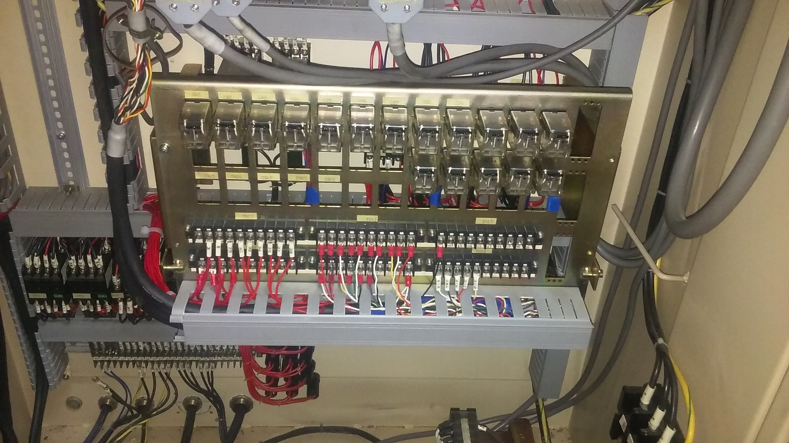

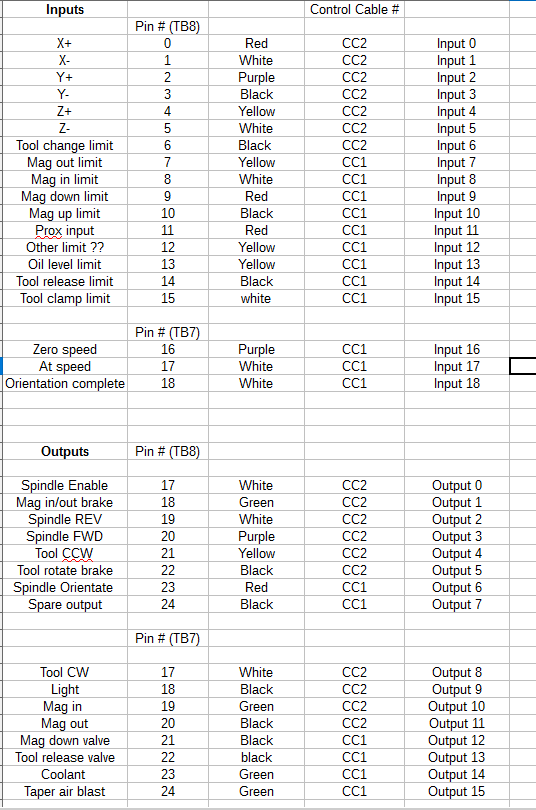

All I/O are connected to the 7i77. Also manually tested all outputs and all functions of mill work as expected. Here is the list of I/O that is needed for the Matsuura MC-500v2( Focus on the columns A and B )
You can assign the pins to what ever you feel, but his is just how mine laid out for me. This is mainly just so anybody can see how many inputs and outputs were needed to make all functions work. Mind you that this is only showing the inputs and outputs. You still have encoders, servos drives, mpg, etc, etc.
If I remember to do so I will post a file that shows where everything was connected to the 7i77 once I am finished.
