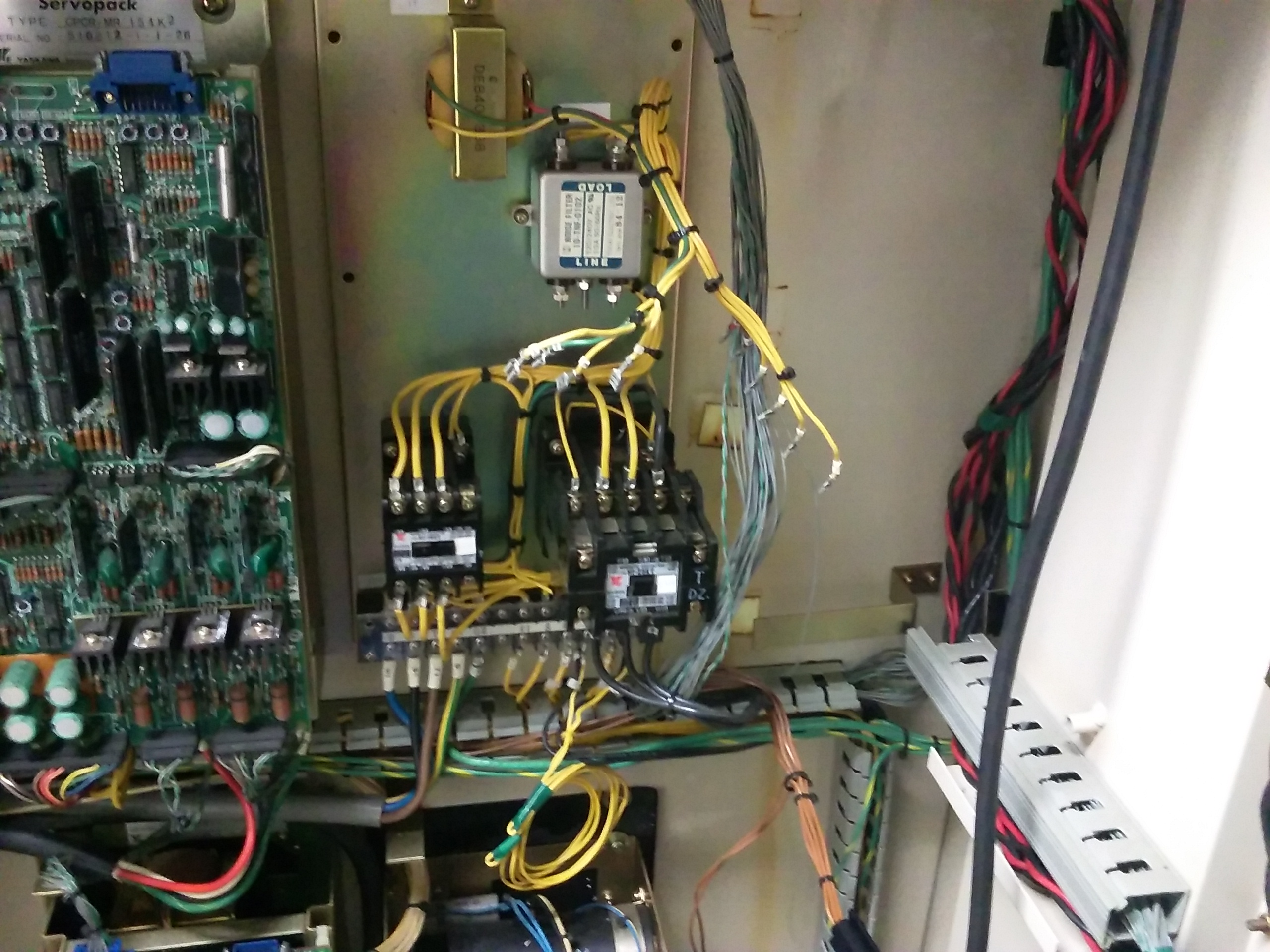

There are the two large 3 pole contacts in the drive side enclosure. I seen you removed the relay board that was over them. What did you do to make the contacts work again? I have been chasing this issue for a couple hours and I can not find any information on those contacts. My goal was to use the relay board. but again no information so I am resorting to removing the relay board.

I managed to get the original relay board working so far. Took some searching with my multi-meter. Now those contacts work when triggered.

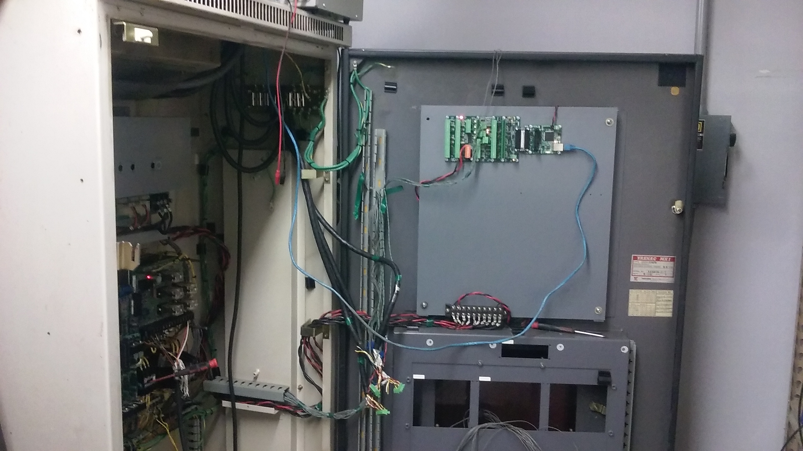

After many dumb errors on my behalf, there is movement. Still need to put in correct encoder count, ballscrew information, Then I can move onto the spindle, the i/o for the tool changer and limits. Using a 7i92 + 7i77 for interface boards running via Ethernet. Feels good to see it moving....
Milestone #2 achieved!!! A big Thank you goes out to the fellow LCNC users/developers that helped me with a few issues I have been having.

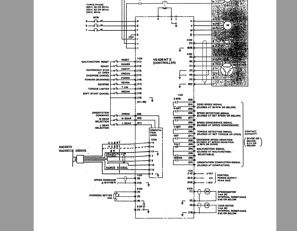

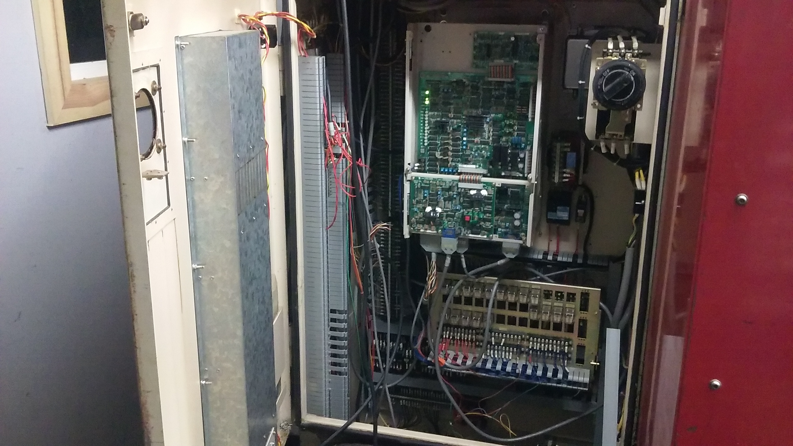

Working on getting my spindle running. I am hesitant to connect some of the signal wires. I know I need the following:
Inputs
Pin 9 = Speed command +/- 10v
Pin 10 = Signal ground
Pin 12 = Ready
Pin 15 = Signal ground
Pin 16 = FWD run
Pin 17 = REV run
Pin 22 = Spindle Orientation
My mind is not allowing me to come to a definite answer on if I should take 24vdc + to the pins to close the contact (excluding signal ground pins and speed control pins). Should I?
I normally do not have issues reading a schematic, but today I am. Also I am a little worried about burning up an expensive part like a VFD. Gun shy I guess.... Any help the connections would be wonderful.

Looks like the pins are switched to ground to enable
24V applied to any of those pins is likely to damage the drive
