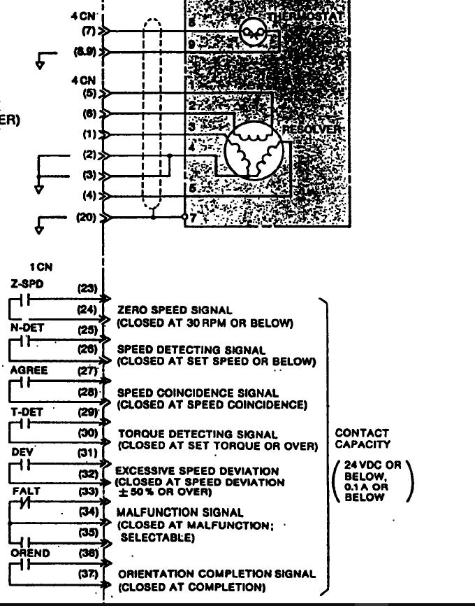

26 Feb 2017 09:36 - 26 Feb 2017 10:00 #88634
by chopper79
Replied by chopper79 on topic 1982 Matsuura MC-500v Retrofit
Yeah the resolver is being used by the VFD. Uses it for feedback so the VFD can keeps itself on point. Not sure I want to mess with the harmony that is there already.
As I said before the machine tapped with a G84 and I have not changed anything on the VFD hookup. I wonder how the tapping cycle was performed without any feedback going to the control? I can only assume that it used the zero speed out and at speed outs to send the signal back to the control for tapping.
The lower connections on this picture are the outputs from the VFD to the old controller.

- Posts: 19904
26 Feb 2017 11:02 #88637
Replied by andypugh on topic 1982 Matsuura MC-500v Retrofit
The LinuxCNC version of the G84 cycle is for a floating / reversing tapping head. That does not necessarily need spindle position feedback.
- chopper79
- Posts: 193
- Thank you received: 44
26 Feb 2017 11:17 #88638
by chopper79
I understand that. The original controller was a Yasnac MX1, which is why I was trying to figure out how it was tapping without any feedback from spindle to controller excluding the at speed, etc, signals. Maybe the original control system was relying on a floating/reversing tap head also.
I think I may just go ahead a build an encoder for it so I can not fuss with the resolver and VFD stuff.

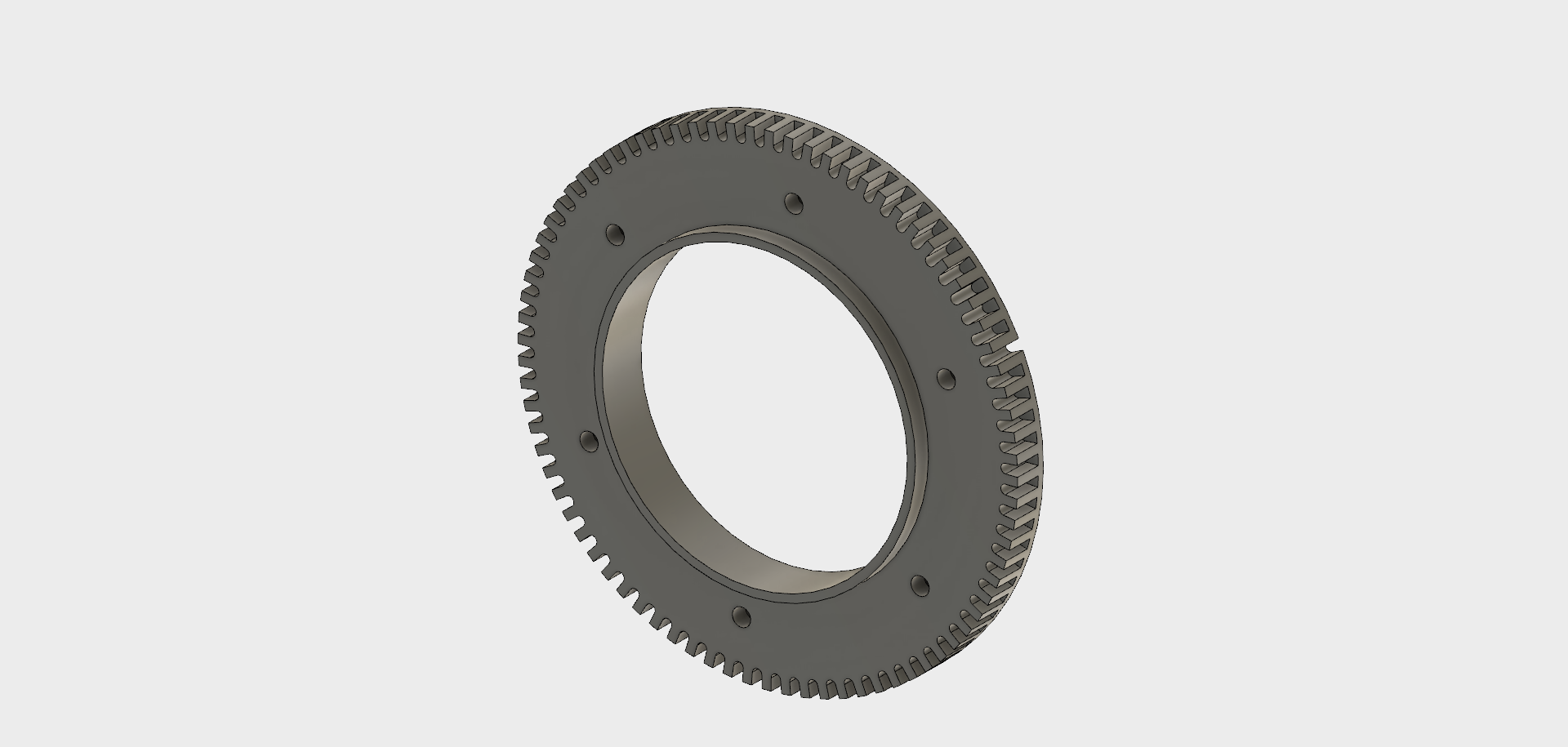

05 Mar 2017 22:18 #89084
by chopper79
Decided to make a 80 tooth self centering gear with an index mark. The teeth are 90deg edges and not rolled edges so i am hoping that the pickups will see this more like an actual encoder disc. Most gears have a taper to them so I wanted to avoid that.
Going to start machining this tomorrow, so hope to have some pictures tomorrow night of the machined gear. If it all works out how I plan I will upload the files to make this gear if you have one of these machines and want to make one of these gears.
We will see what happens
