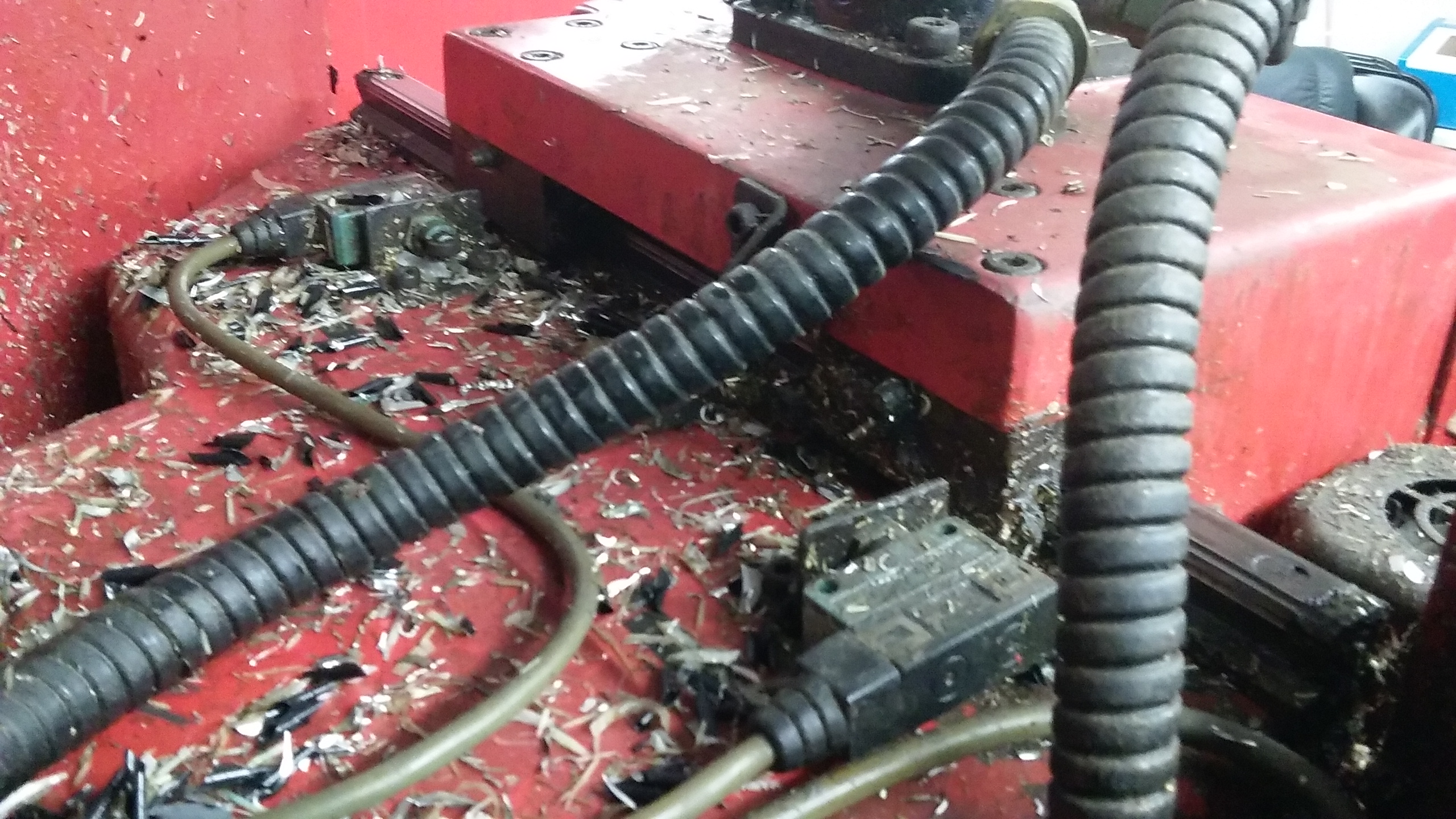

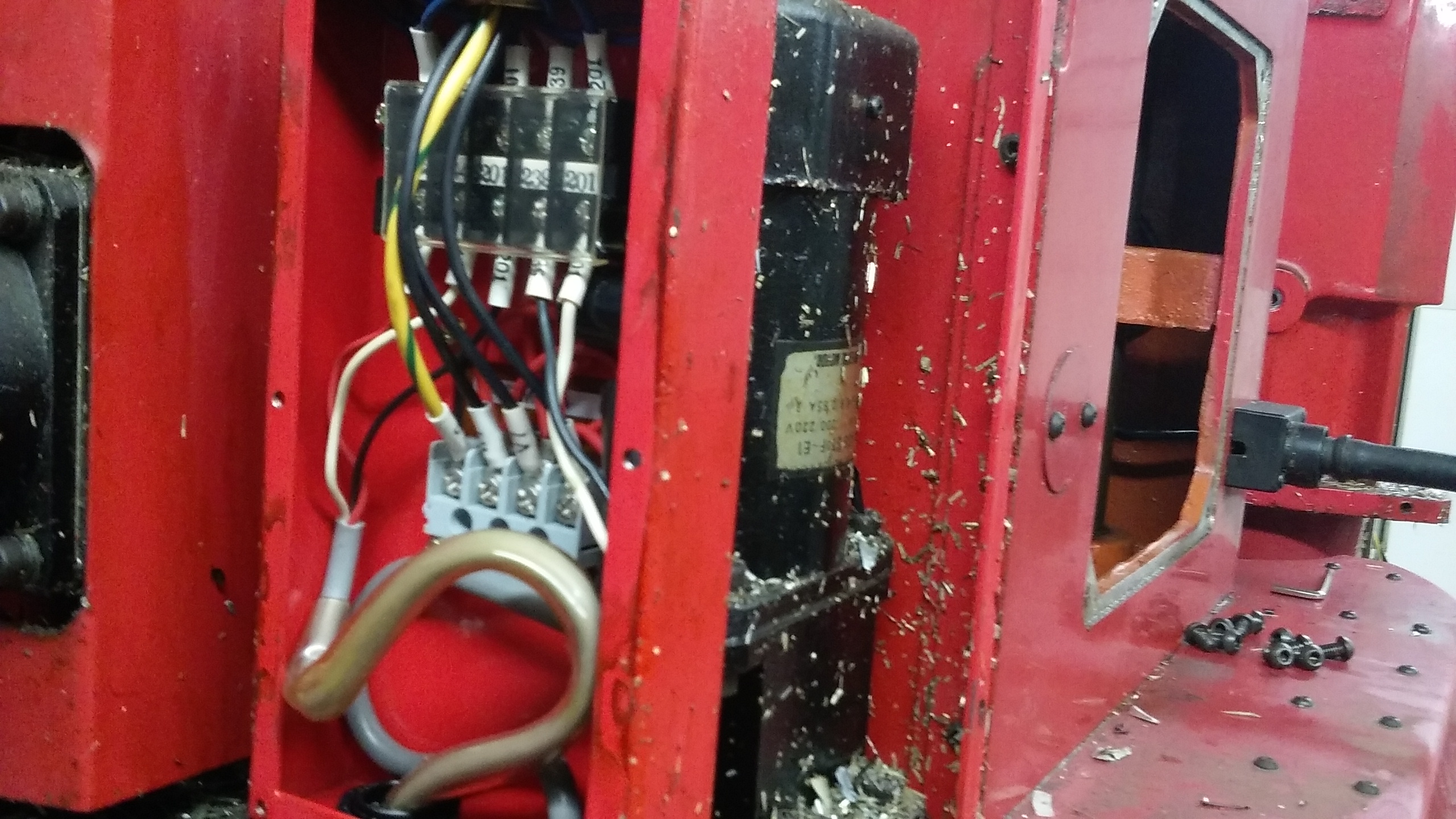

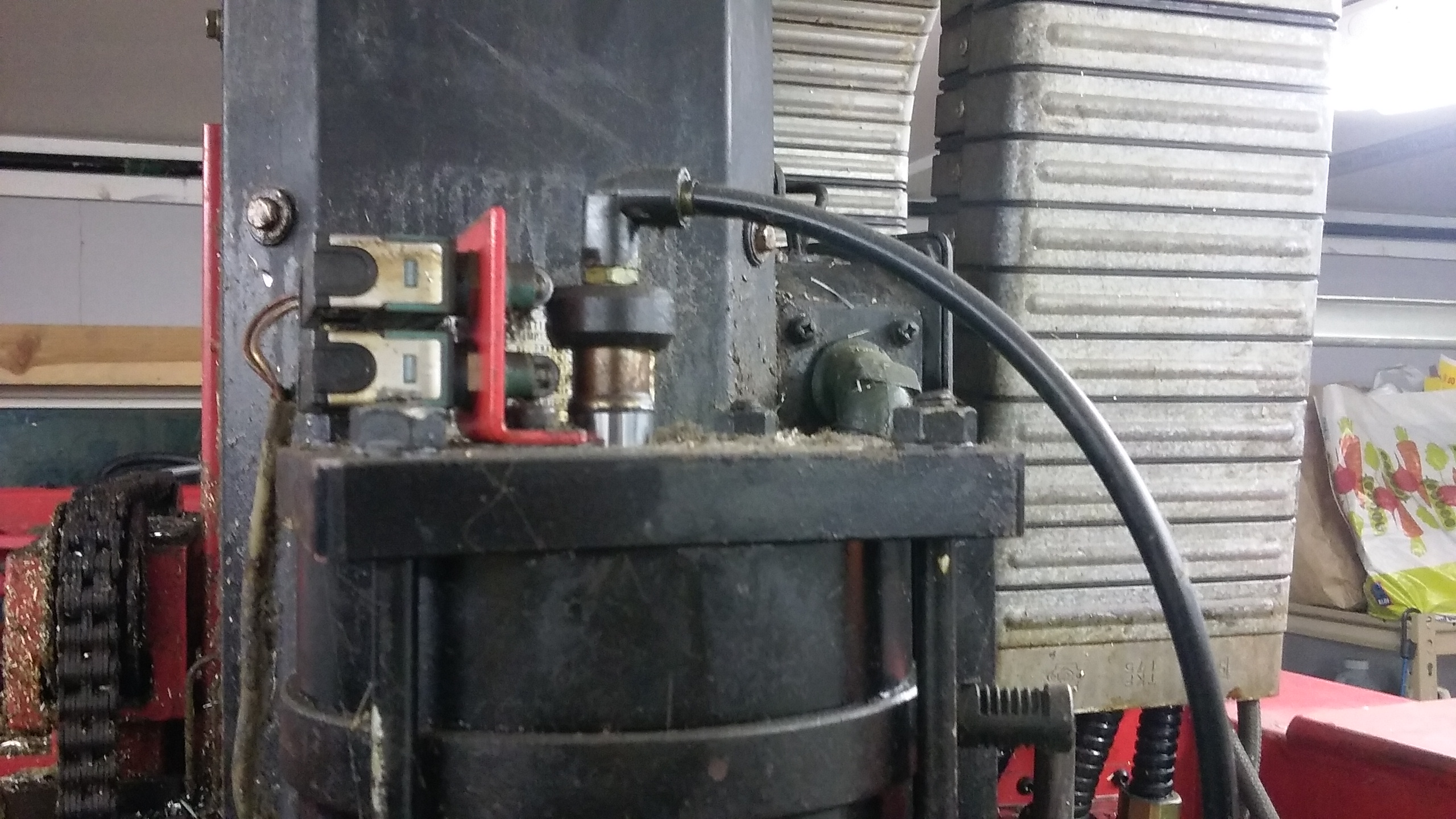

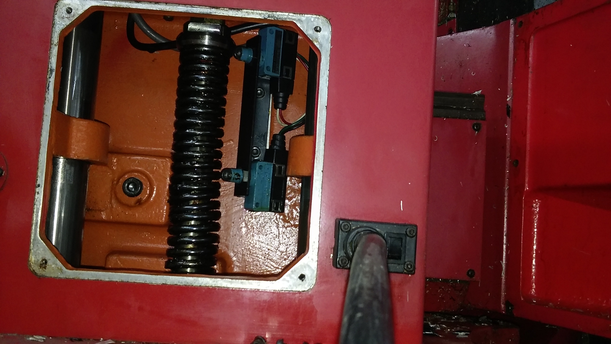

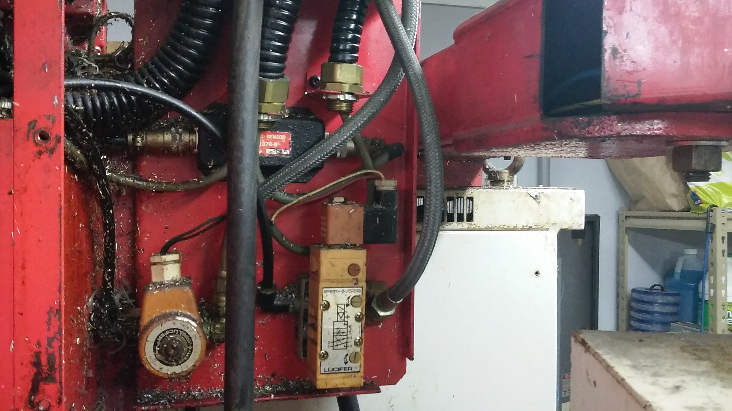

This is where the limits and connections are located for the ATC. (Pardon the mess. Previous owner must not liked to clean)
Draw bar limits
Tool magazine up and down limits
Tool magazine in and out limits
Connection points for the tool magazine CW and CCW. The limits are under the magazine
Junction box for all tool magazine limits, power, and goofy light. Also note the pneumatic valve for magazine down
Pneumatic valves for draw bar and taper clean out
