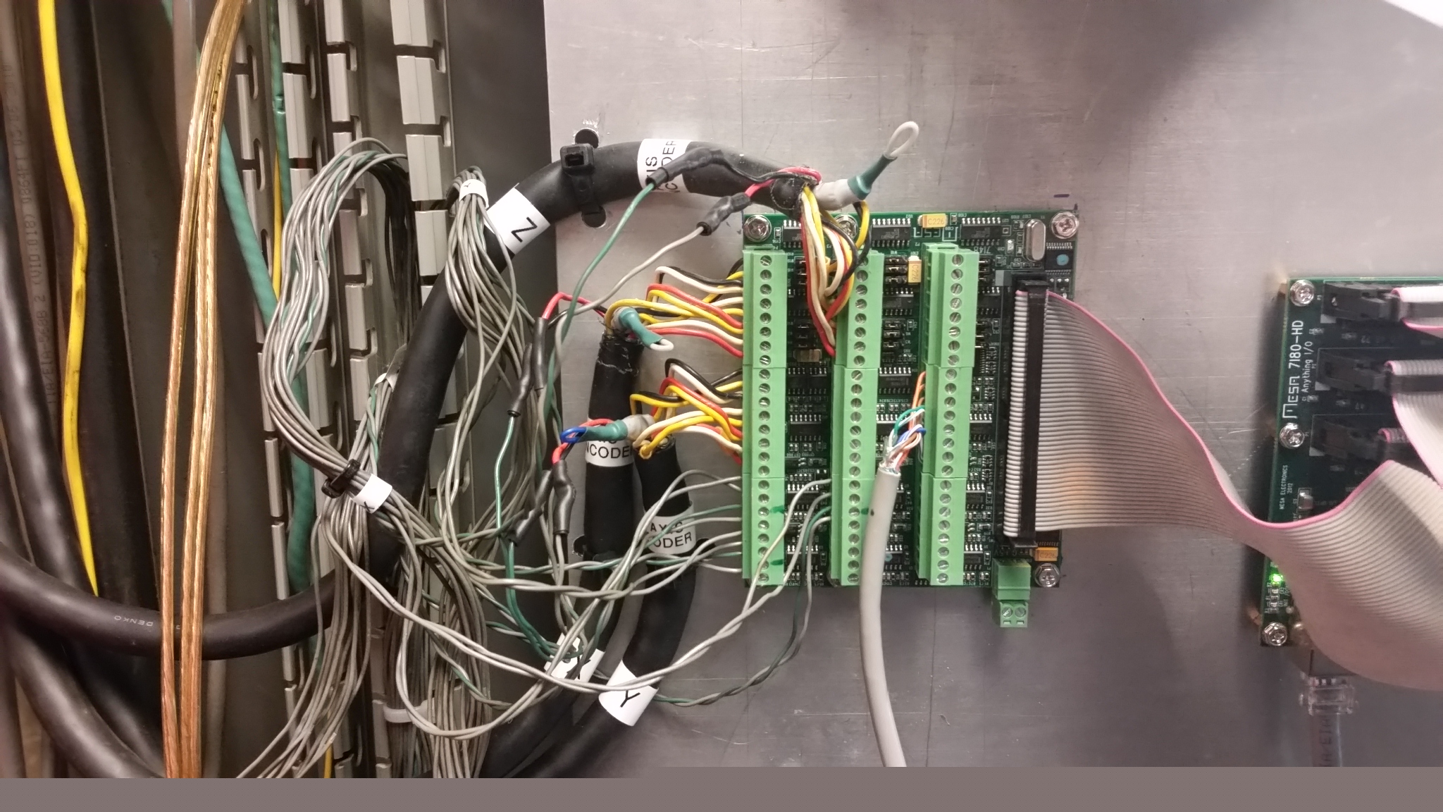

Well I found those wires, but I can not get the drive to enable. There has to be some more wires that need hooked up. I noticed on Skunkworks build he has an ena+ and ena- hooked up on his mesa board.

17 Jan 2017 16:23 - 17 Jan 2017 16:24 #85944
by chopper79
Replied by chopper79 on topic 1982 Matsuura MC-500v Retrofit
Correct.... to what on the drive is my issue. In his picture he has them hooked up to the original wiring for the drives. I am not sure which pins on the original connector for the machine he used on his.
Once I find these wires then I can do some testing before I order my mesa boards.
Picture attached is skunkworks wiring on his board.

- skunkworks
- Posts: 351
- Thank you received: 153
17 Jan 2017 16:27 #85946

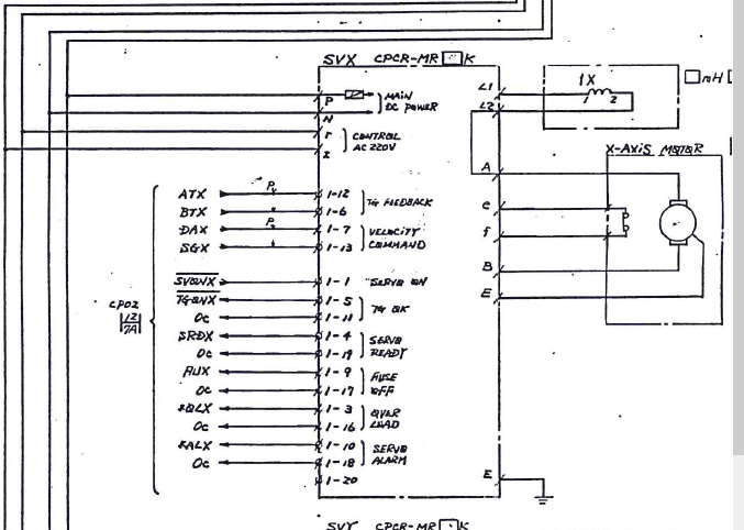

I am not sure which wires to use on the drive. I have found the analog lines (thanks tommylight) , but from there I can not seem to find the additional wires need to enable the drive.
Analog is pin 7 and 13
Servo on is pin 1
Have to missing something else to enable the drive though. Also is the servo on pin + and what voltage?
Servo on is pin 1

17 Jan 2017 16:41 #85951
by skunkworks
Replied by skunkworks on topic 1982 Matsuura MC-500v Retrofit
I cannot look right now - but I assume I hooked the other end of the enable (pin 1) to ground. (pin 16-19) on p1
sam

- skunkworks
- Posts: 351
17 Jan 2017 16:58 #85955
by skunkworks
again - I think I just grounded pin 1 to enable the drive..
sam
sam
The following user(s) said Thank You: chopper79

17 Jan 2017 17:01 #85956
by chopper79
Ok.. I see that now. Thank you
Then I should just need servo on (pin1) connected to ? voltage and the drive should enable and I can send it a small voltage from my bench top supply to check movement.
Right now if I send voltage to the analog then the IN led will turn on showing signal in. No movement though so seems like the drive is not being enabled.
