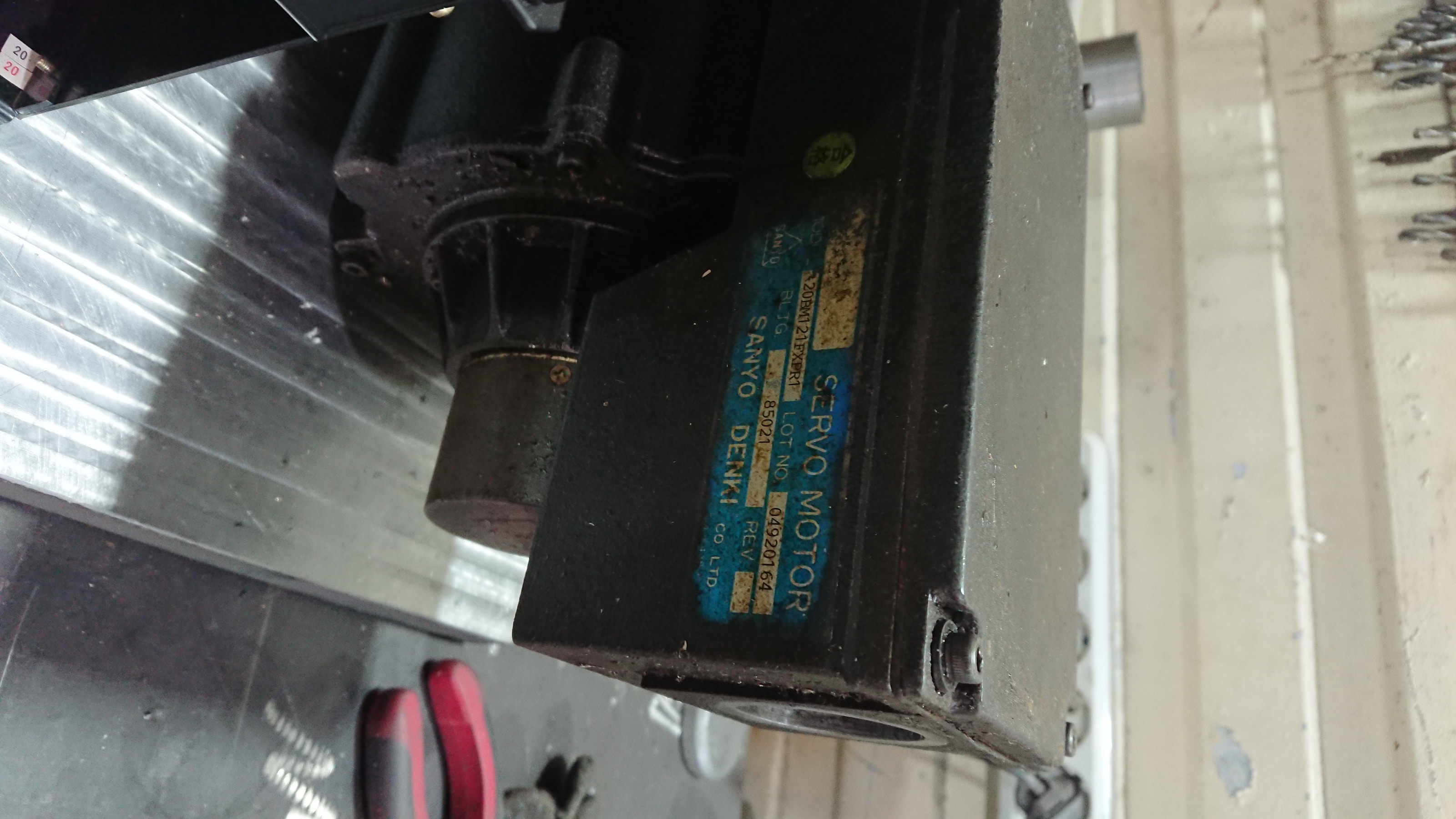

the axis motors definitely have model numbers. they are not brother specific. sanyo 25bm... the drive also has a number. that one IS brother specific. but, remember, the people buying these will likely be repairing a brother, sooo, just list them as tc225 parts with whatever numbers you find on them.

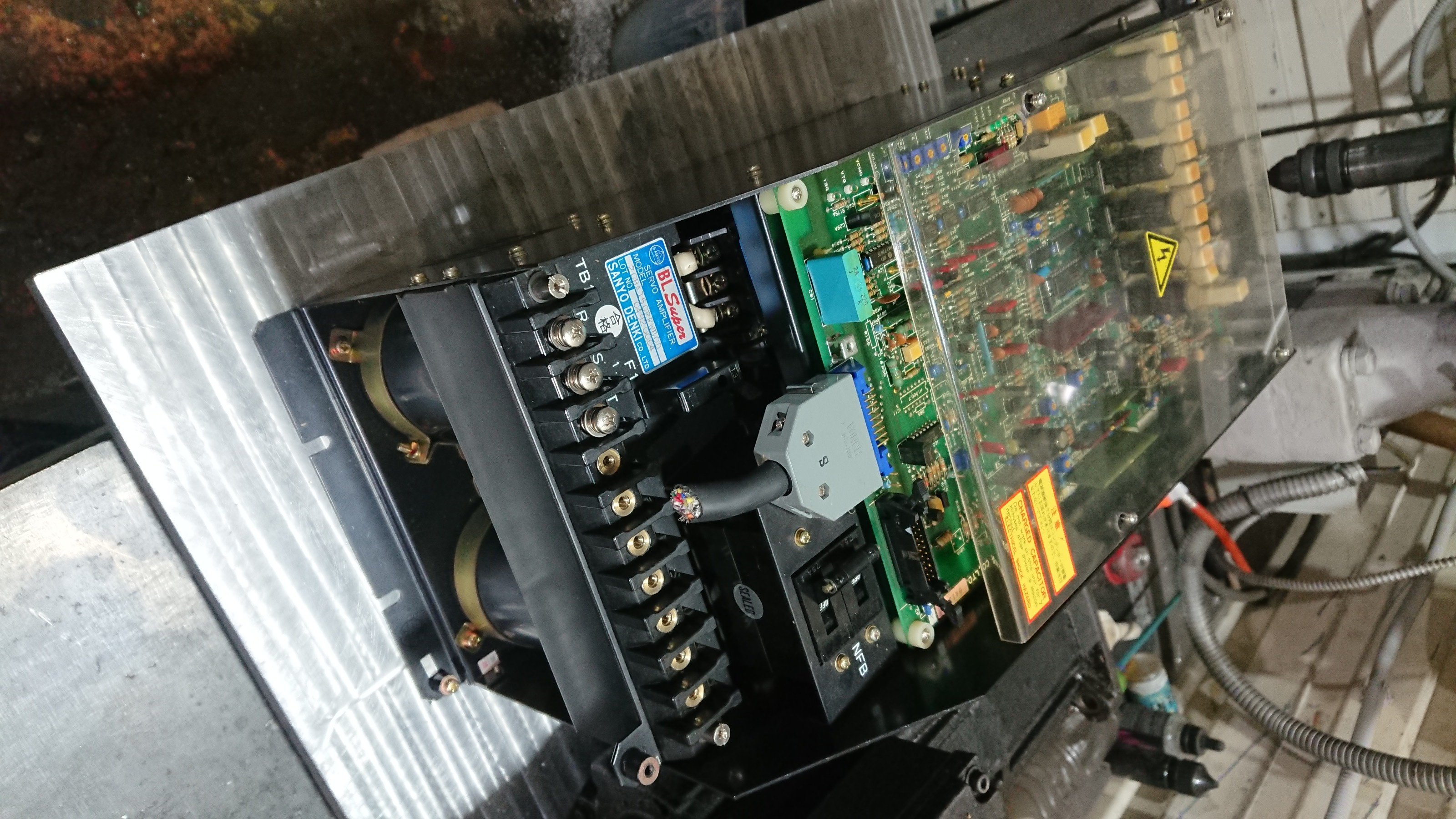

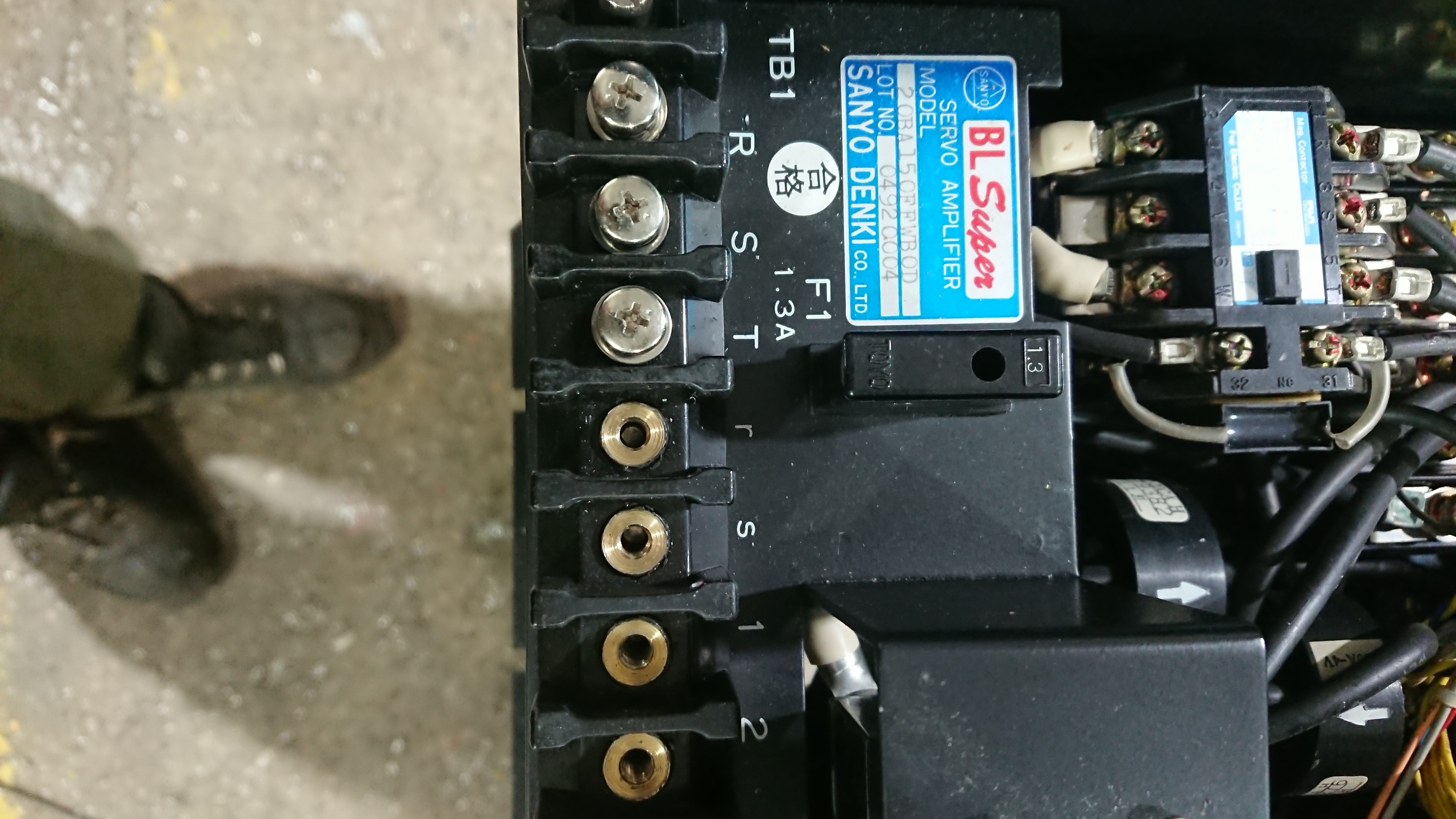

Hello. I bought a spindle servo from brother 225. I can't figure out how to connect it to 220v. Or is it necessary to connect 3 phases of 200 volts to the transformer? This is necessary for my cnc project. If I connect the servo driver to 3/380 volts or so it might break?
- Posts: 21900
- Thank you received: 7465
02 Feb 2021 10:22 #197404
Replied by tommylight on topic Brother TC-225 / TC-229 adventure!
3X380V will brake a 3X220V drive.
Most drives will work using one phase and neutral so it gets 220V, but i would not push it to hard when wired like that. Do not use 2 phases, that still makes 380V.
- rmu
- Posts: 279
- Thank you received: 101
02 Feb 2021 11:32 #197408
by rmu
Replied by rmu on topic Brother TC-225 / TC-229 adventure!
My brother 225 has a transformer, it can be wired for 3 phase 380V (400V) input, that should be a Y configuration if I'm not mistaken. (Delta config for 220V input)
- Arkadiy
- Posts: 12
02 Feb 2021 13:41 #197427
by Arkadiy
Replied by Arkadiy on topic Brother TC-225 / TC-229 adventure!
Unfortunately I don't have a three-phase transformer. I want to figure out how to connect one phase of 220 volts to the terminal blocks of the servo driver. And I read earlier that one of the forum participants was able to start it from a single-phase voltage.
Which terminal blocks R S T and r s. Connect phase and neutral?
