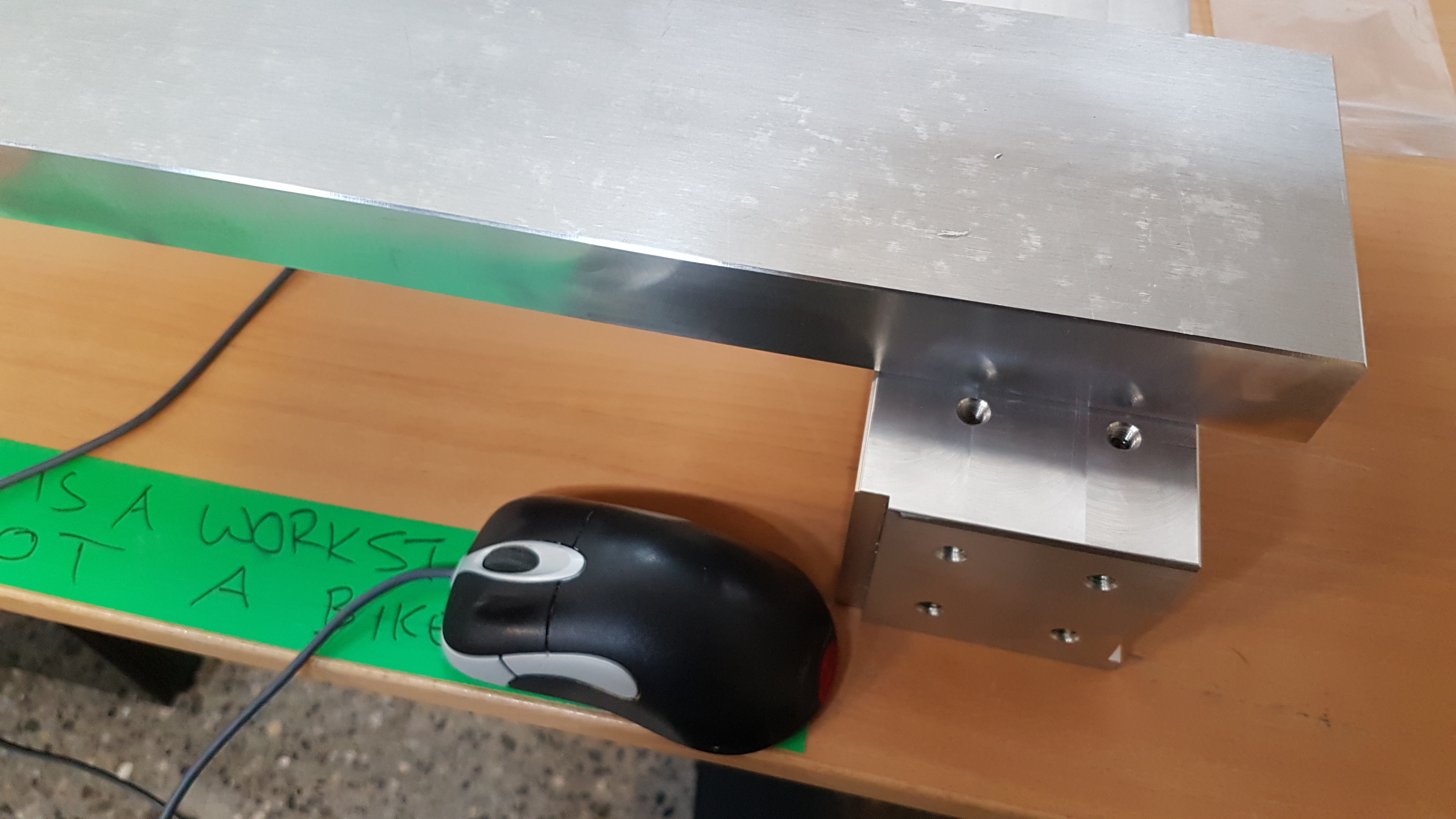

Part 1 is altering the machines frame. This is almost done. I replaced all the extruded parts on the machine (lower frame beams and gantry lower cross beam) with solid aluminium. Some say this is overkill. I disagree. Its just the right amount of kill
In the process, I reduced the machine length from about 41" travel to 16" travel. This is both to make the machine a whole lot stiffer and to make it FIT where i need to put it. 16" travel is perfect for guitars and most of the other things i need to make.
I am waiting on a newly made Z axis now. The original Z axis was fine, but overhung the machine quite a lot. I also happened to have a few extra linear guide blocks, so the new Y and Z will both have 4 long 25mm blocks. There wants really any problems with the original design of 2 long blocks per axis, but.. if your gonna remake it anyway.. why not? I will as a result lose travel on the Y and Z, but i will still be left with 29" x 7.5" (x 16" for the x) which is ample. My last change is the table. I am putting 4 1x2" cross bars across the frame, 100mm apart. A 750mm x 350mm 1/2" think aluminium vacuum plate will mount on top of these. Sacrificial mdf sheets, or a vise can also be mounted on top of these bars as different needs arise. A large laser cut aluminium sheet will cover the whole frame between the cross bars to keep debris out of the bottom of the machine and off the ball screw. I'll be anodising the whole machine black once all the aluminium parts are made.
