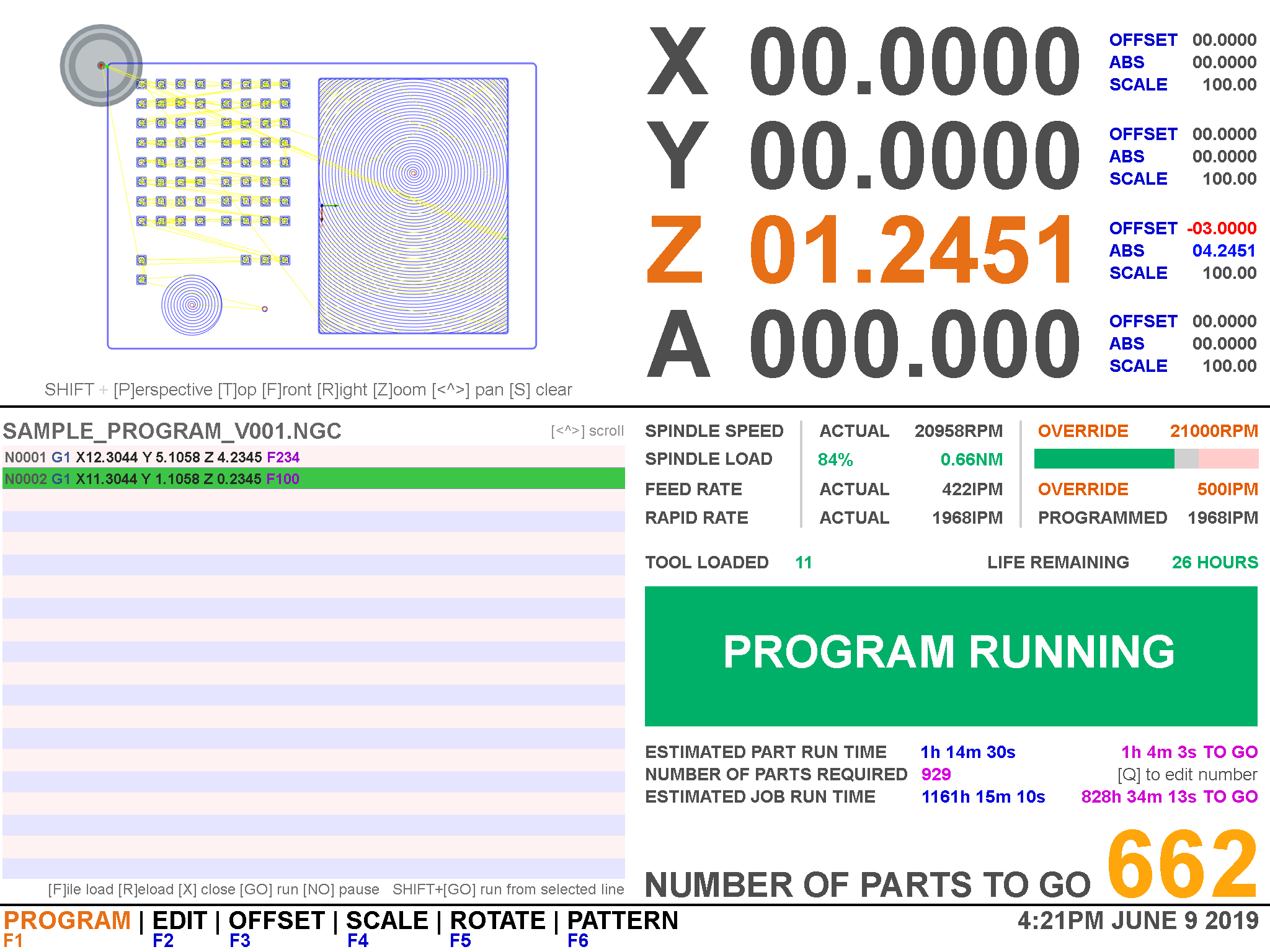

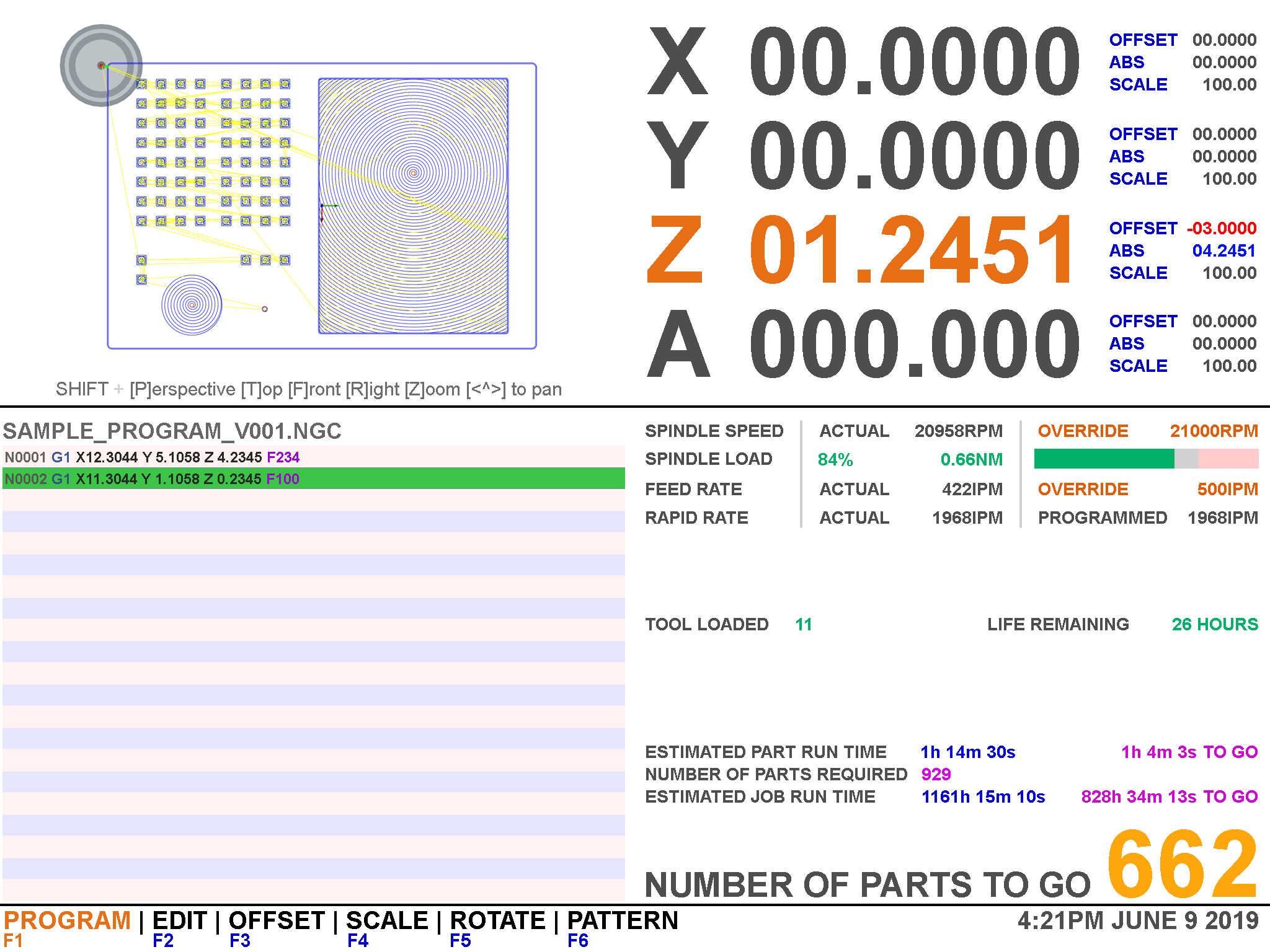

I can't see why it can't. You can save the probe data to a file and from there you could feed the results back into a component that used external offsets so the z axis followed the surface via linear interpolation. I have mapped the surface on a straight line like this.
Replied by rodw on topic Build: XZero Predator... With more teeth!
Got me wondering now, can linuxcnc do this type of probing?
In which it creates a map of the surface, correcting the Z offset dynamically. It seems like it would be pretty simple in my head (like everything complicated) I supposed it doesn't even need to be dynamic, and could just perform some math on the file and resave it as a compensated version. Hmmm. That actually does sound fairly easy.
