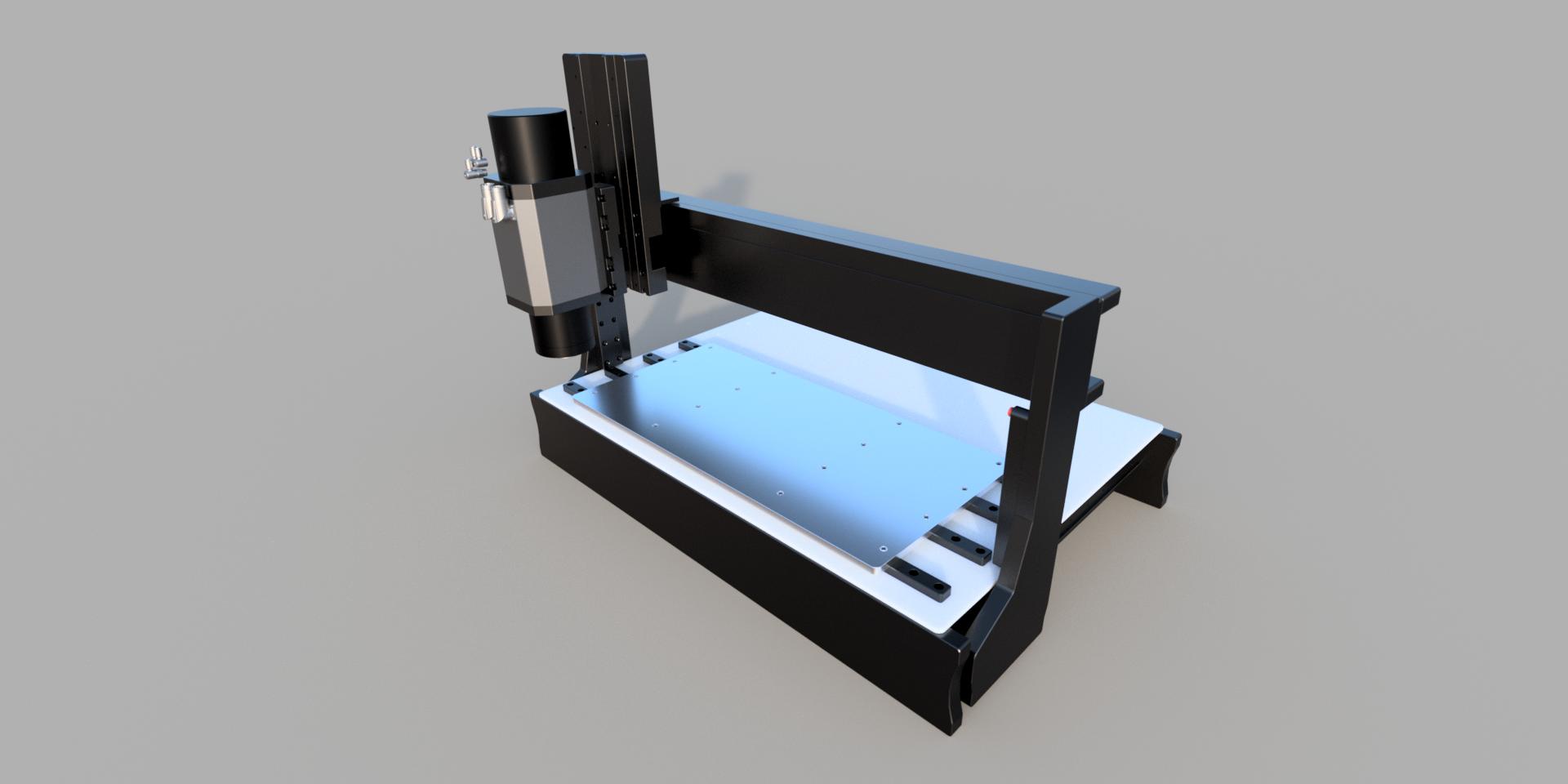

18 Jun 2019 19:55 #137223
by ihavenofish
Replied by ihavenofish on topic Build: XZero Predator... With more teeth!
- ihavenofish
- Posts: 1029
- Thank you received: 286
18 Jun 2019 20:56 #137228
by ihavenofish
All the Z parts, table beams, and upright reinforcements are now being machined. yay!
The Y saddle plate is the most expensive single part on the whole machine. Eek! It's complex, and also has to be precise and square. Its also machined for a 2" x 8"x 16" plate, so... I guess I cant complain.
I still will of course

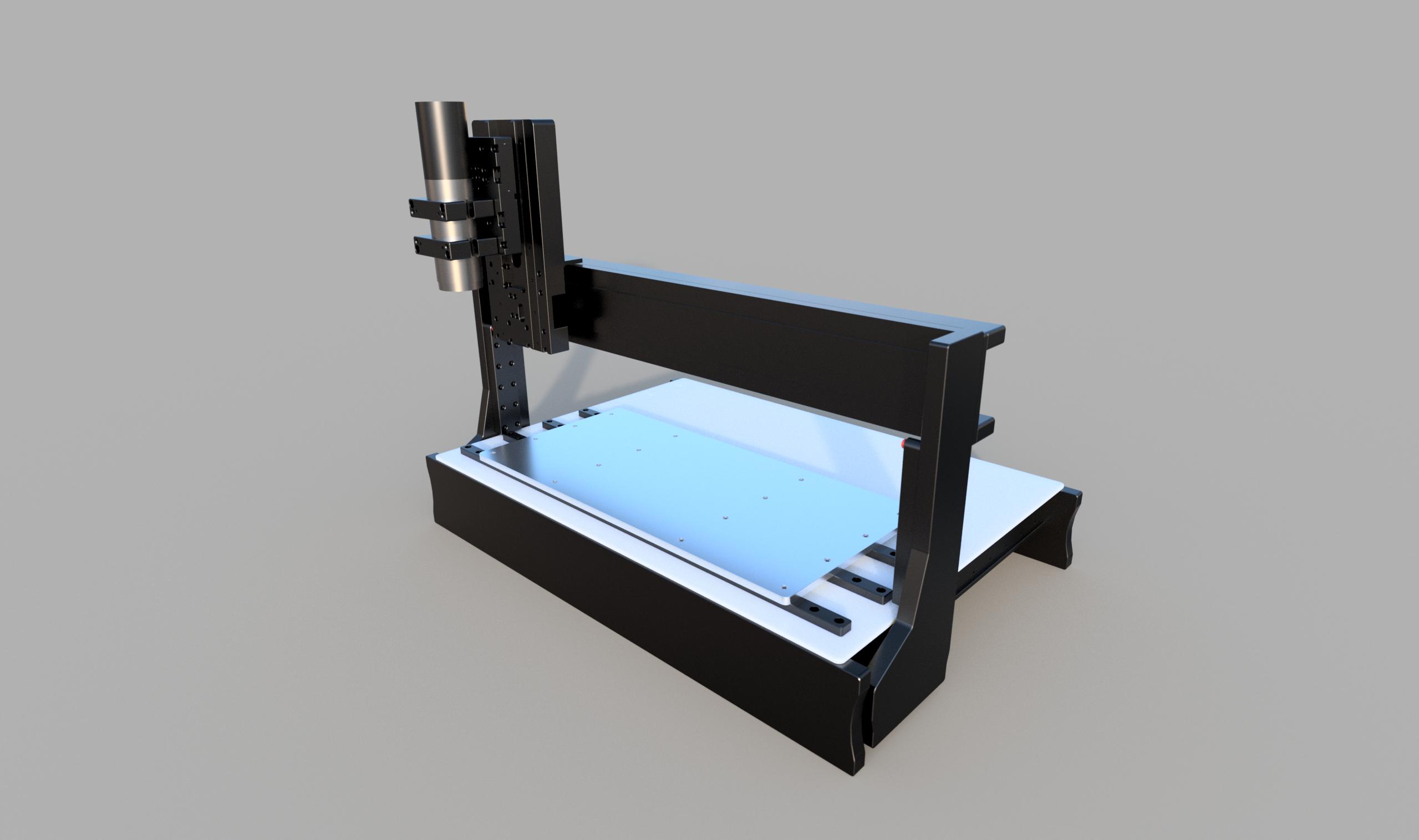

19 Jun 2019 17:43 #137297
by ihavenofish
Bah, cost the same as my big one.
I just made up an alternate Z to use my larger ISO30 spindle.
Benefits:
- I already own it so zero new dollars spent.
- It's here NOW. no waiting.
- It's got as much power as I want - 2.2kw on single phase, 4.6kw on 3 phase
- It has more low end, even when restricted sine it made full power at 12000rpm.
- Safely runs at 3000rpm.
- Electric fan, no water.
- It's iSO30, which makes buying tools easier
- It reaches the vac table fixture with short tools.
- Don't need to machine a $200 custom spindle mount.
- Can use a saw or right angle aggregate!
- Not "lightweight" - if I crash, the machine will break before it does.
Drawbacks:
- 14KG heavier than the Chinese 80mm spindle which will lower accelerations a little OR require a 750w X servo..
- If I *could* sell it fast, I would save $3000.
- ISO30 tools are both tall and large, limiting the tool tray size to 8 tools, and limited to about 5" guage. Larger tolls could be put in by hand though.
Hmm.
Benefits:
Drawbacks:
Hmm.

19 Jun 2019 18:05 #137303
by ihavenofish
Hmm, with restriction, my big spindle can run 950w at 3000rpm, 2.2kw from 9000rpm to 24000rpm continuous. That should do very well in, well, everything
