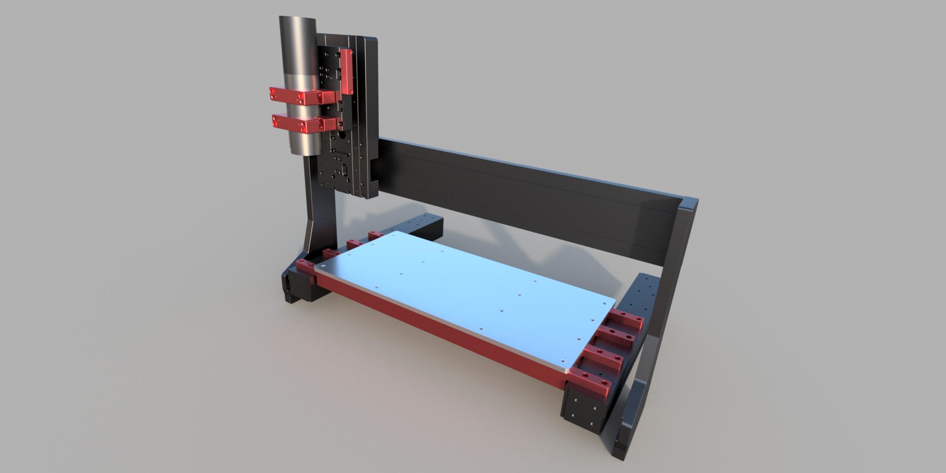

A little mockup of the frame with the new Z
Should have all the fasteners to assemble the lower frame in a few days.
The spindle is an 80mm diam 1.5kw 24000rpm ISO20 model. Price is decent and it is low power enough to run on the delta single phase.VFD. I debated getting the 2.5kw ISO25 model, but its about 8kg more weight and would push the cutter out an extra 10mm. right now, the spindle centre is right at the edge of the linear guides on the x. the old Z and teknomotor were a few inches overhanging. I never liked that - too much leverage especially when it had an extrusion base frame.
The table on there is a proxy model of this:
www.worldofclamping.com/vacuum-table-VT7535-R
I have to drill mounting holes into it. it's 1/2" solid plate, sitting on 1" x 2" bars spaced every 100mm, so it should wind up very rigid. It worked out to be the perfect size. same Y travel, and a little shorter in the X to leave room for the tool tray.

Mouser order arrived. Time to see if i can make this servo turn - or at least program the drive. I'm 50% on weather it will run the motor on 110v. We'll see.

My compliments for your visualisation.
What kind of cad program do you use to make this?

This is in fusion 360. I'm just quickly rendering them out as I model them to be machined.

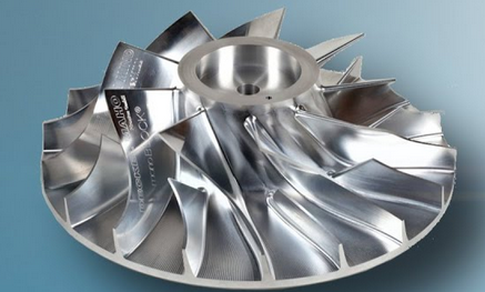

Impellers! haha.
Well, you have a little under 200mm clearance above the table beams and 175mm travel. And of course linuxcnc can run all sorts of axes.
Trick if making a reliable trunion table that isn't $25000.
If you go surplus harmonic drives, and cross roller rings, and machine a nice aluminium housing and fixturing plate, you could do well with very small 5 axis parts.
As for fusion, ugh. It has some 5 axis functions, but it is still squirrely. I think you'd want to program as 3+2 and just use 4 and 5 for positioning and not simultaneous machining. For now. It will improve over time.
Also, the predator isn't what i would call "small". It's 400lbs and 740mm x 400mm x 175mm travel. The MINI is small, but it couldn't fit 5 axis, only a 3" chuck 4th realistically.

The Harmoic Drive "FHA" units are a servo motor, harmonic drive and crossed-roller ring assembled as an integrated unit.
They make perfect 4th and 5th axes. And are not _that_ expensive on the eBay market. But that's not a good source for a commercial product.
www.ebay.co.uk/itm/HARMONIC-DRIVE-SYSTEM...ctuator/263813872830
A working setup for the STMBL drive exists for them.
Replied by andypugh on topic Build: XZero Predator... With more teeth!
