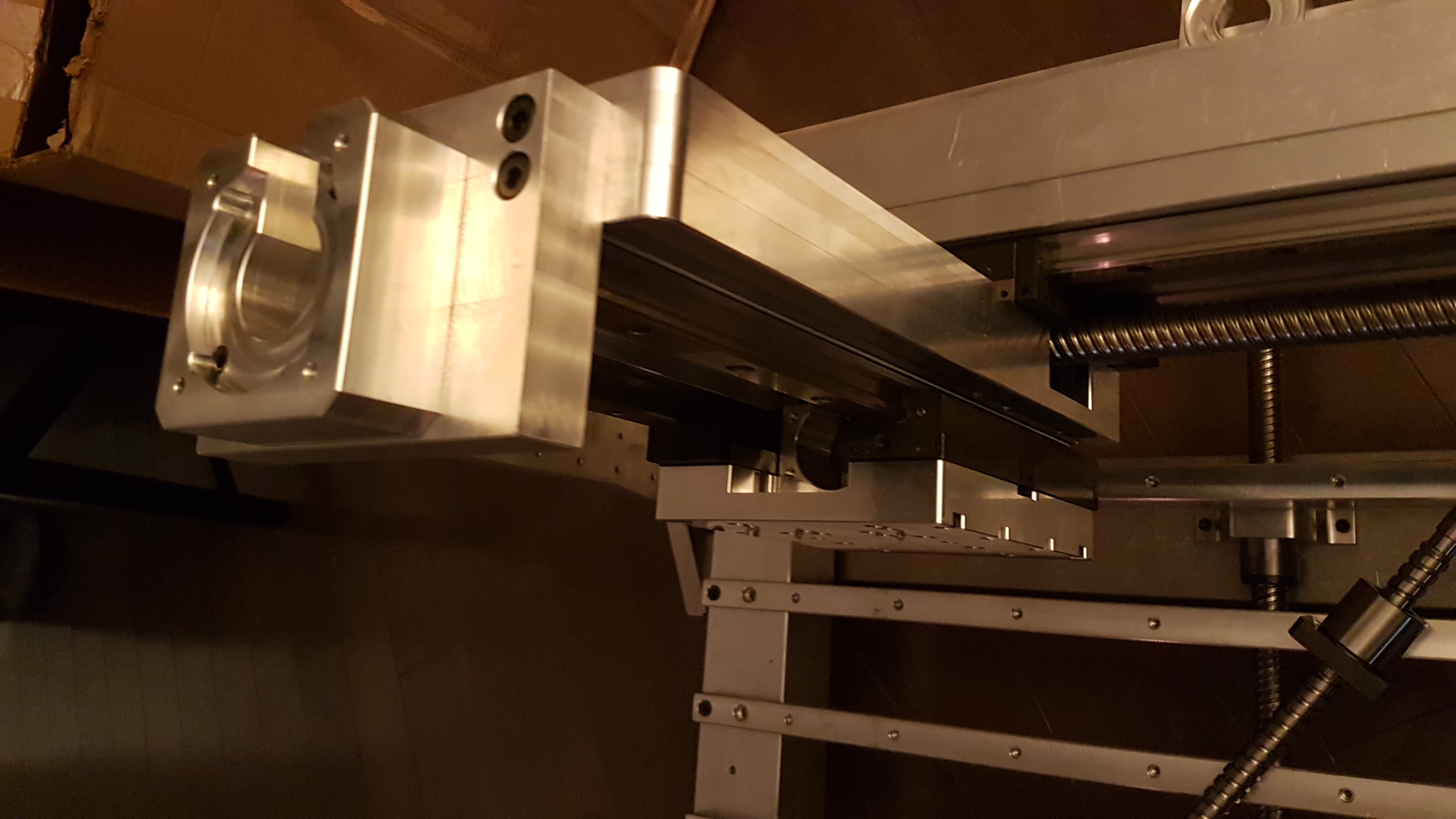

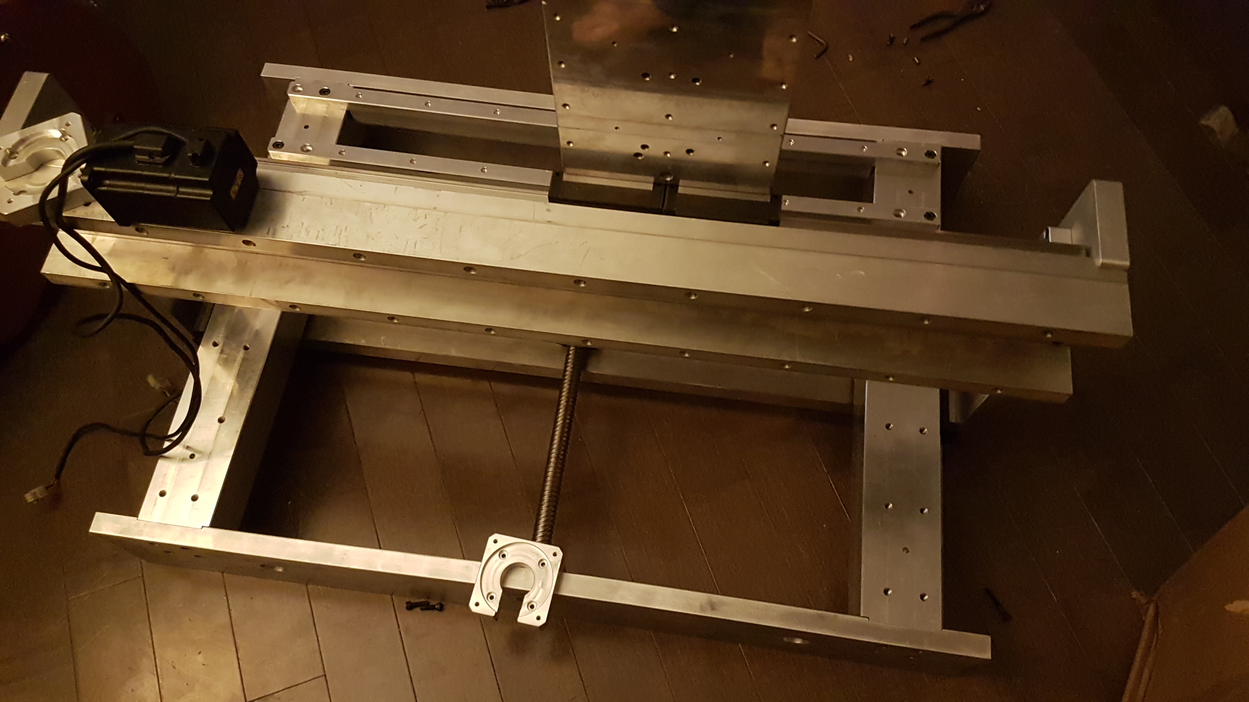

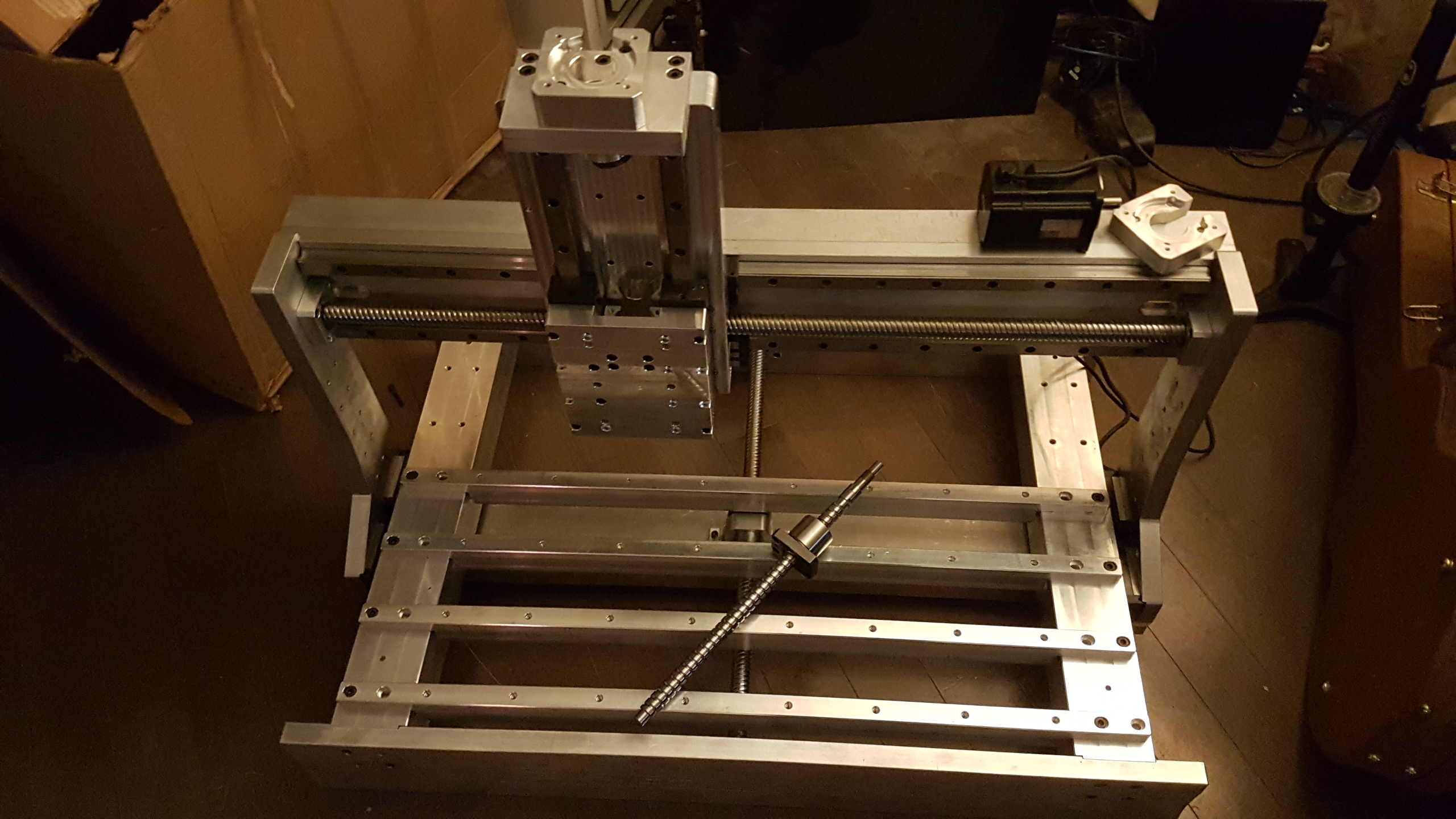

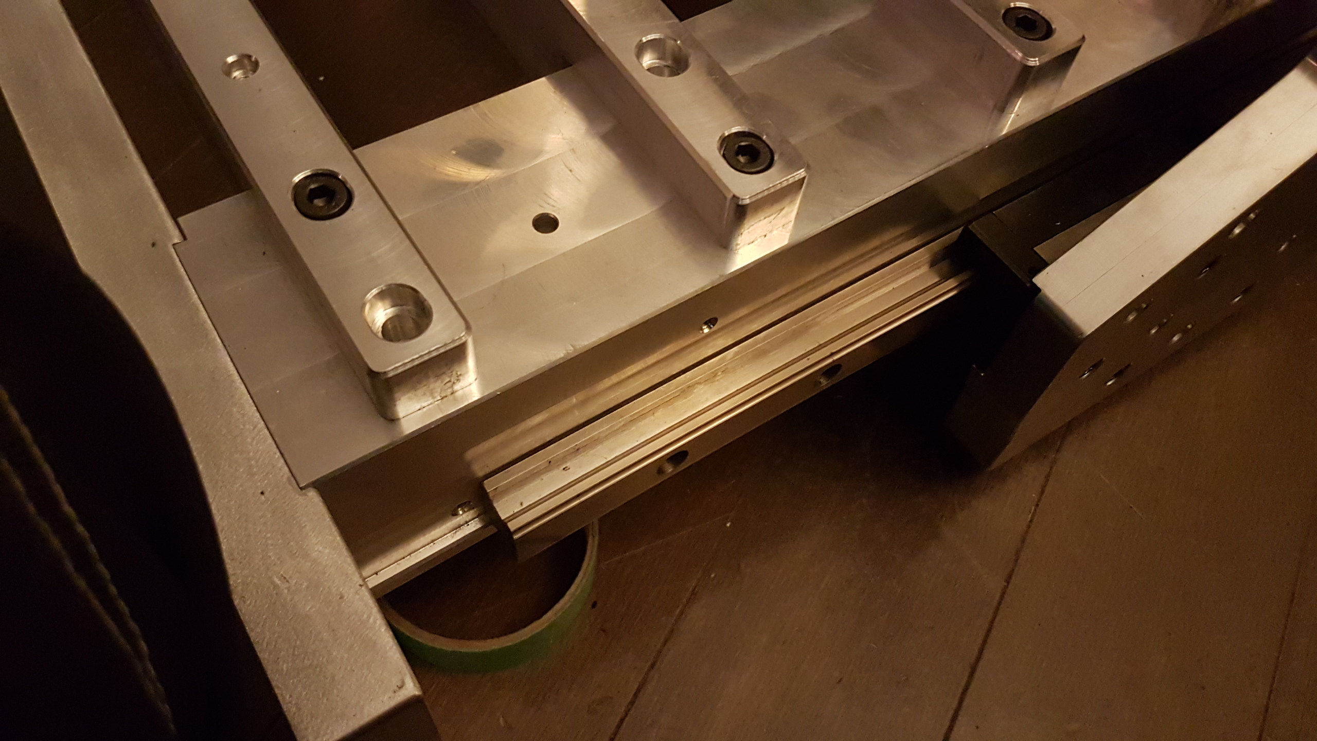

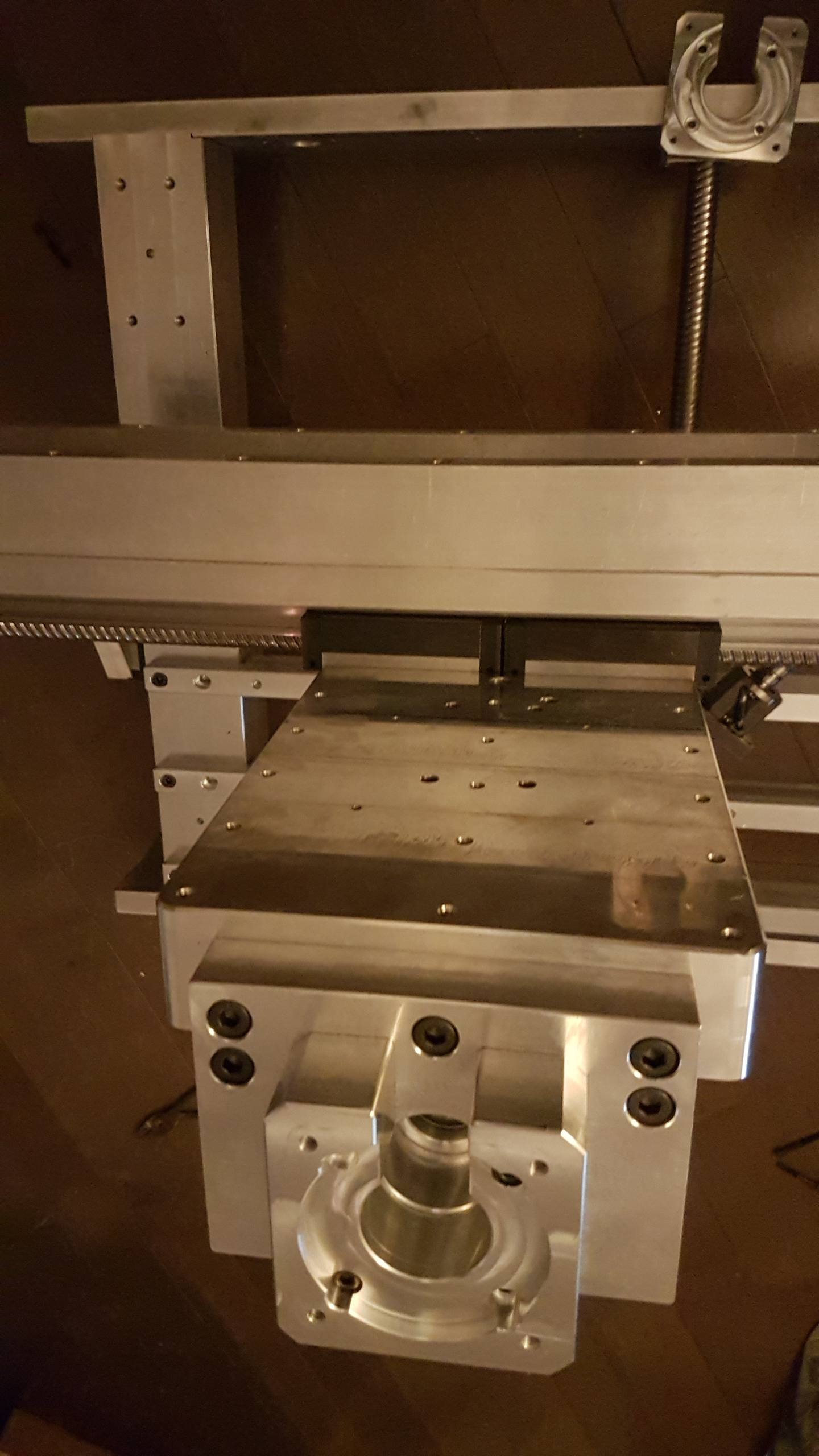

02 Feb 2020 19:11 #156397 by ihavenofish
Replied by ihavenofish on topic Build: XZero Predator... With more teeth!
Well, here's how it stands now. it's quite a beast. Needs just a few small things to get it finished, 2 more sanyo servos, a table top, and some small bits, printed cable chain brackets, wiring, etc.
Sadly, I think i need to find it a new home for it, I have to move.
