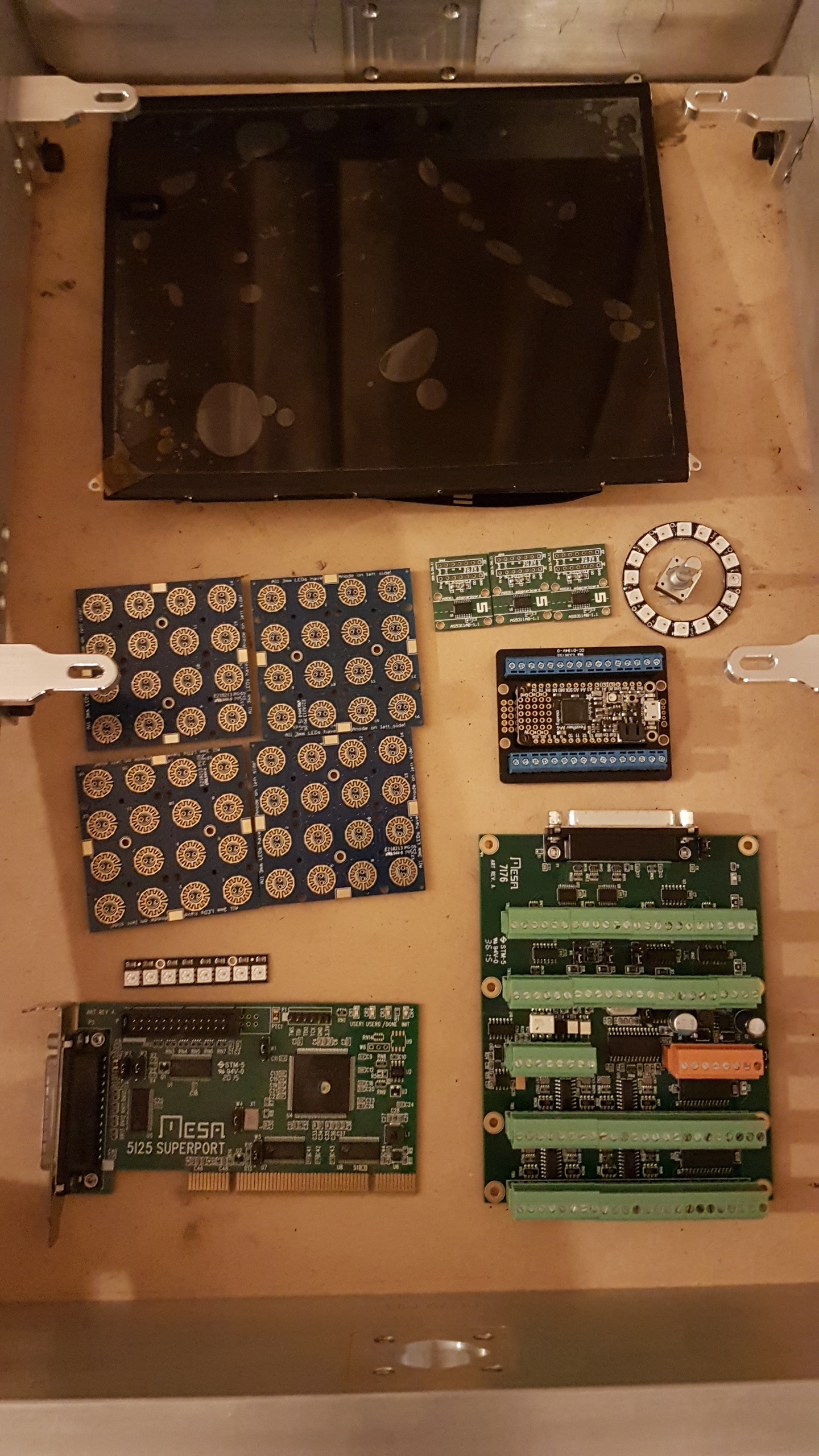

Gathered up my electronics.
TOYS!!
The heart of the panel is adafruit feather cortex m4, sitting on a terminal block base board. will get powered by the USB port. I have to see if I can power all the LEDs from that source, or if I need a secondary source.
The 4 trellis keypads are run on i2c. So we don't need many pins. All the external LEDS (strips, ring) are one wire, chained together (neopixels).
The screen is just a screen. Theres a little driver board on the back of it that takes in displayport and 12v power. it has some buttons to control the brightness and a few other things.
Also in there are my AMS as5311 linear encoder readers. I have bogen magnet scales for them with 10 micron precision.

12 Jun 2019 02:06 #136684
by ihavenofish
Replied by ihavenofish on topic Build: XZero Predator... With more teeth!
So I can go to about 1/20 full white brightness on the LEDs all at once on USB power alone.. Realistically all will never be on white. Maybe all could be on in one colour as an alarm. So 1/10 might be a more practical threshold.
Given 16 of these LEDs on the ring are literally blinding on full white and all 149 would light the room... 1/10 power is probably still way too bright
