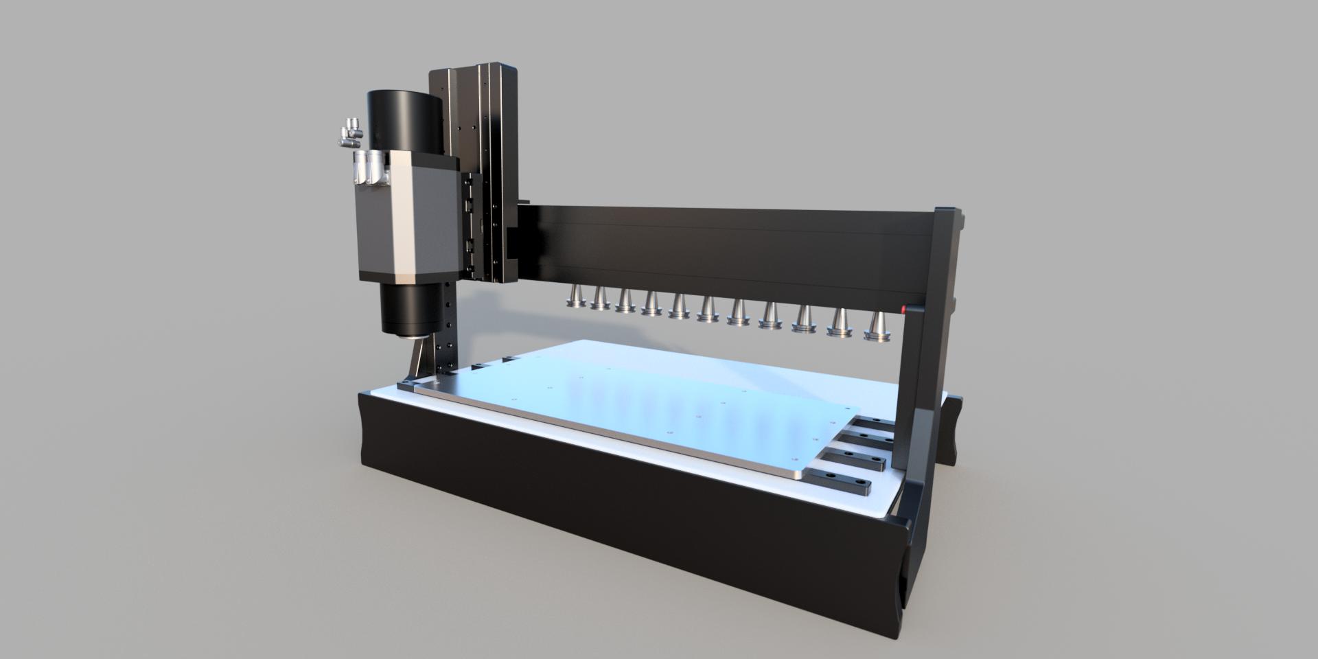

Big spindle has some tool changer rack issues. I can fit 11 tools which is good, but I need the rack to move out of the way 100mm otherwise I'll loose too much travel.
So now I need to devise some sort of moving rack situation. perhaps with a flip up cover to keep it clean. Sounds like a job for the giant 3D printer that gets here in the morning! :P

The panel viz and parts are earlier in the thread. It's pretty simple though it doesn't look it. Adafruit trellis boards for the keys, and an ipad screen for the display. It will be paired with a custom UI eventually. I'll need help on that though. My goal on that besides just a panel for me is to have an open flexible panel for all my commercial machines and everyone else. Then have a variation linuxcnc that is streamlined for it. This will be good because in 10 or 20 years time, you'll still be able to repair it, or build a new one, and keep the software current even if my company is long gone.
On the product side, it's just been given a shove. I have a small ATC spindle now for a "viable" price. Still expensive compared to chinese water cooled of course :)
The little machine will be first - I'm currently revamping it for the new spindle and to take features form the predator modifications.
Downside is I need to commit to it hard - can't do just a few at a time. I'll need help for that too... money help :P

This has been a complex fight. There was no spindle available for low cost and small machines. that big teknomotor spindle i have on my machine, that was the cheapest you could buy at the time, and its 25KG, and huge and 3 phase power only. There are now smaller 80mm diam spindles from china for a reasonable price, but they are still too big for my smallest machine and have a slight mystery on quality. ATC seems to be the most wished for feature on smaller high quality machines like mine. So, I think it's time to get that done.
