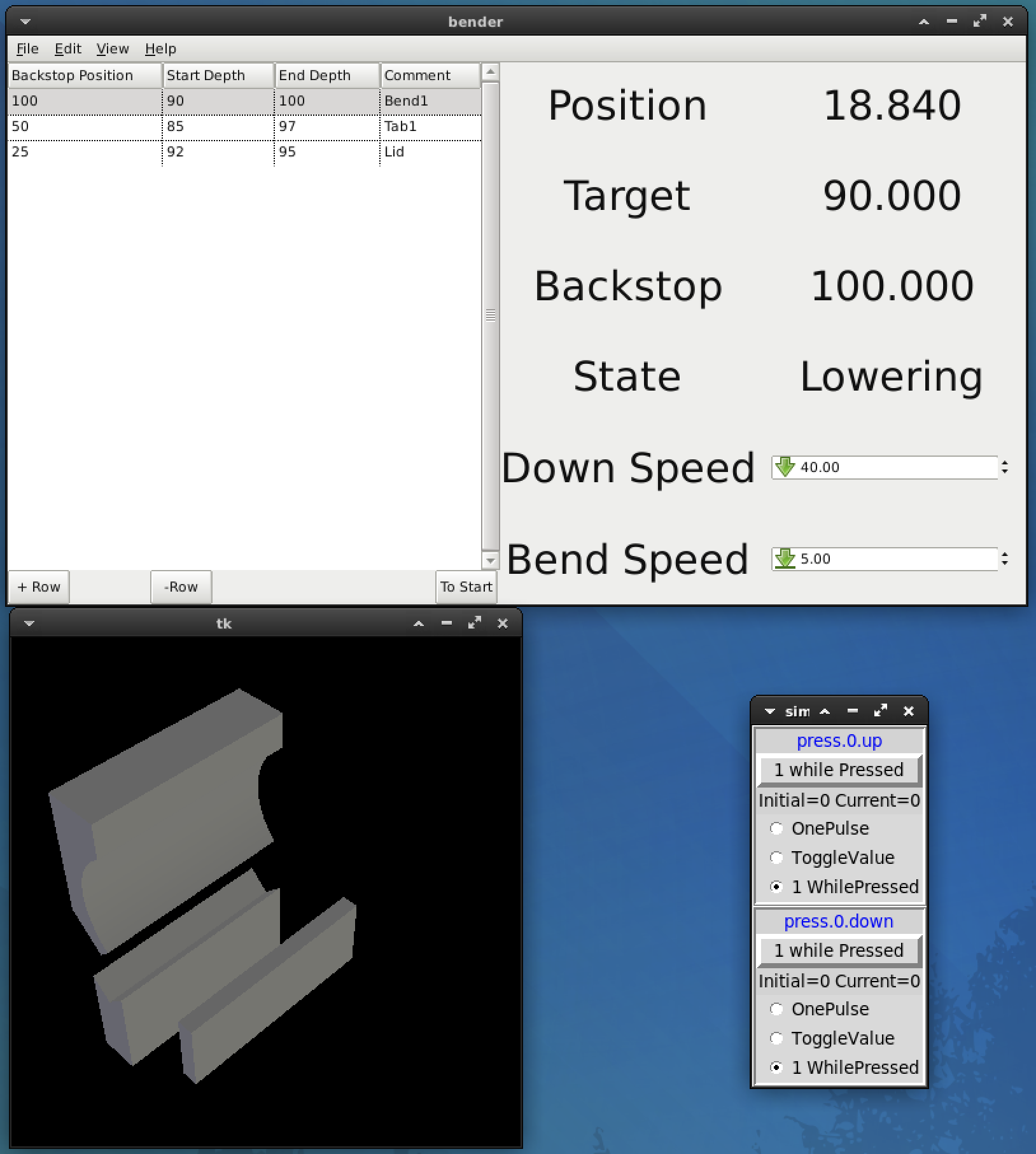

I got strangely interested in this. I have made a fairly complete press-brake config based on my old gui.
Unzip the archive somewhere on your HD. Probably linuxcnc/configs/Bender
You will need to install the press.comp
cd ~/linuxcnc/configs/Bender
sudo halcompile --install press.comp
You probably have to make "bender" and "pressgui" executable:
chmod  x pressguichmod  x bender
You can then start the demo with
./bender
The idea is that the system runs through the bend sequence in the table. If you press the "down" button in the sim-pin then the Vismach bender will run down to the start position, then slow down, then to the finish position. If you then release the down-button you have the choice of going down 0.1mm further, or pressing the up button. Once the brake is back at the top and idle the system moves on to the next row.
Things that I gave up on for the moment
1) File save / open etc.
It's mainly intended as a basic skeleton for your real machine.

05 Apr 2021 02:05 #204845 by andypugh
Replied by andypugh on topic Pressbrake CNC Control Setup Questions
As set up here, the ./bender command leaves an interactive hal session open in the terminal. "exit" will close that, and close the GUI, Vismach and button panel.
But I left it in so that it is easy to open a halmeter and watch things / explore the HAL pins, etc.
05 Apr 2021 16:11 - 05 Apr 2021 16:12 #204915 by andypugh
I fiddled some more. I have added a backstop and addressed the issue with there being no feedback of the active row.
I have also re-arranged the UI layout.
Re-download the ZIP file for the new version. There are also changes to the press.comp, that will need to be re-installed.

05 Apr 2021 19:16 #204939 by andypugh
OK, and now load / save / saveas / quit work.
(re-uploaded the zip file)
I will stop now, awaiting feedback from someone who has at least used a press brake.
What would be useful? "dublicate bend" button?
Once you are going up, you can't go down again. Is that OK?
Please play with the simulator and see how it feels.
I think that there is plenty of scope for cosmetic improvement too.

06 Apr 2021 13:31 #205106 by EW_CNC
Replied by EW_CNC on topic Pressbrake CNC Control Setup Questions
OK, I got your simulator installed and working. Looks Great!
Now my next step is to get it to work with my machine. I've been trying to get the press.comp to work in axis gui, but just can't get it going. Might be with my encoder, pwm, pid settings. I'll attach my hal file. I had the ram jogging before with keyboard y jog.
How do I merge my settings with your program?
Do I use an ini file?
Where do I keep the pid settings?
