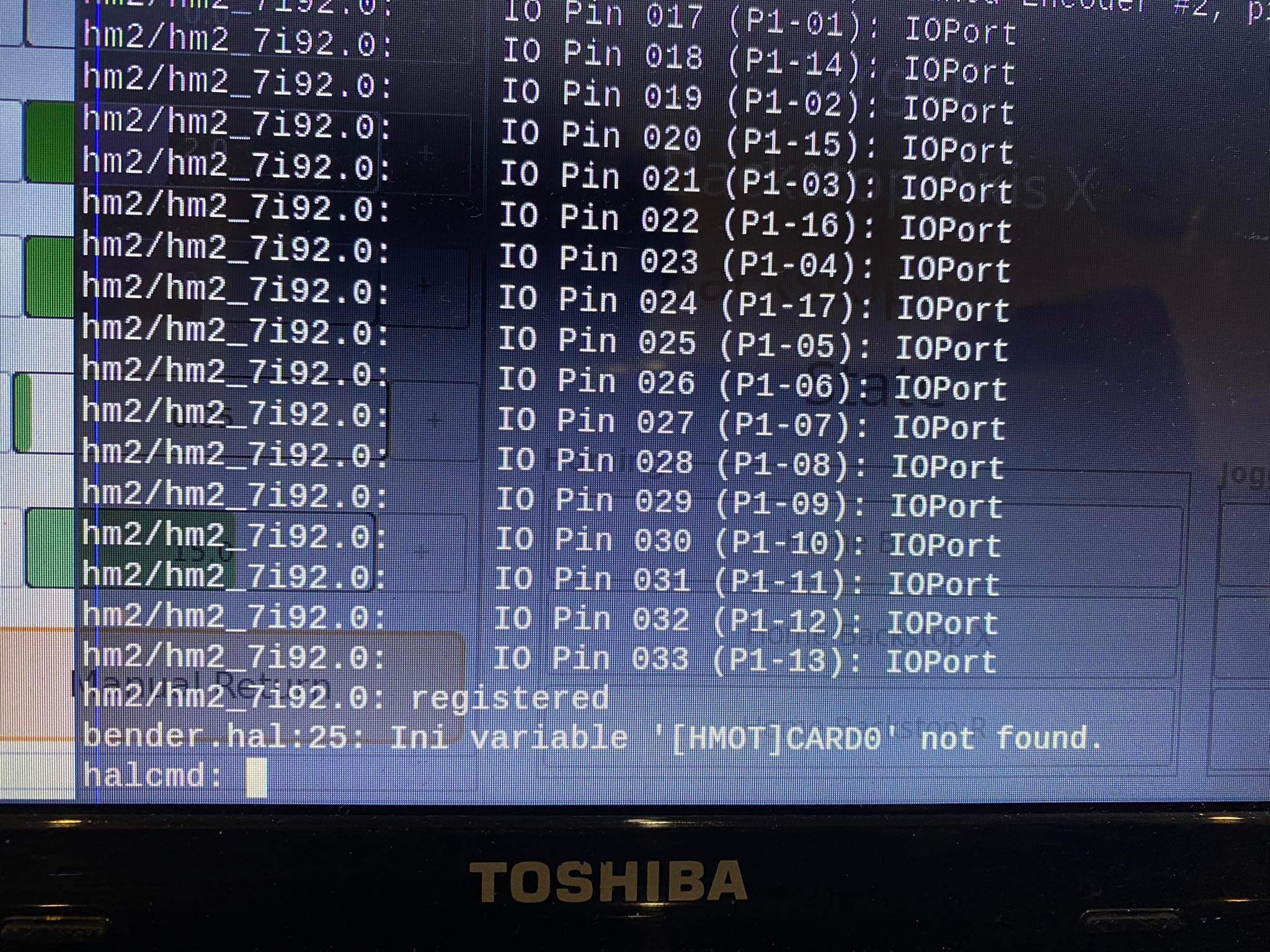

i get this error, tried adding the board in the ini file ans the same happened.
tried swapping for hm2_7i92.0. as well but it gives this error
im trying to get to zero erros or maybe just one which would be the lacking analog input which i suppose i can get later

Sorry about my previous post, I had forgotten that you are trying to convert a 7I97 configuration to a 7I92T/7I77 one.
Is that error from LinuxCNC or halcmd?
If halcmd, you need to launch it with:
halcmd -i <INI file>
Also you don't need to use the ini name substitutions,
you can use use the hm2_xxxx name

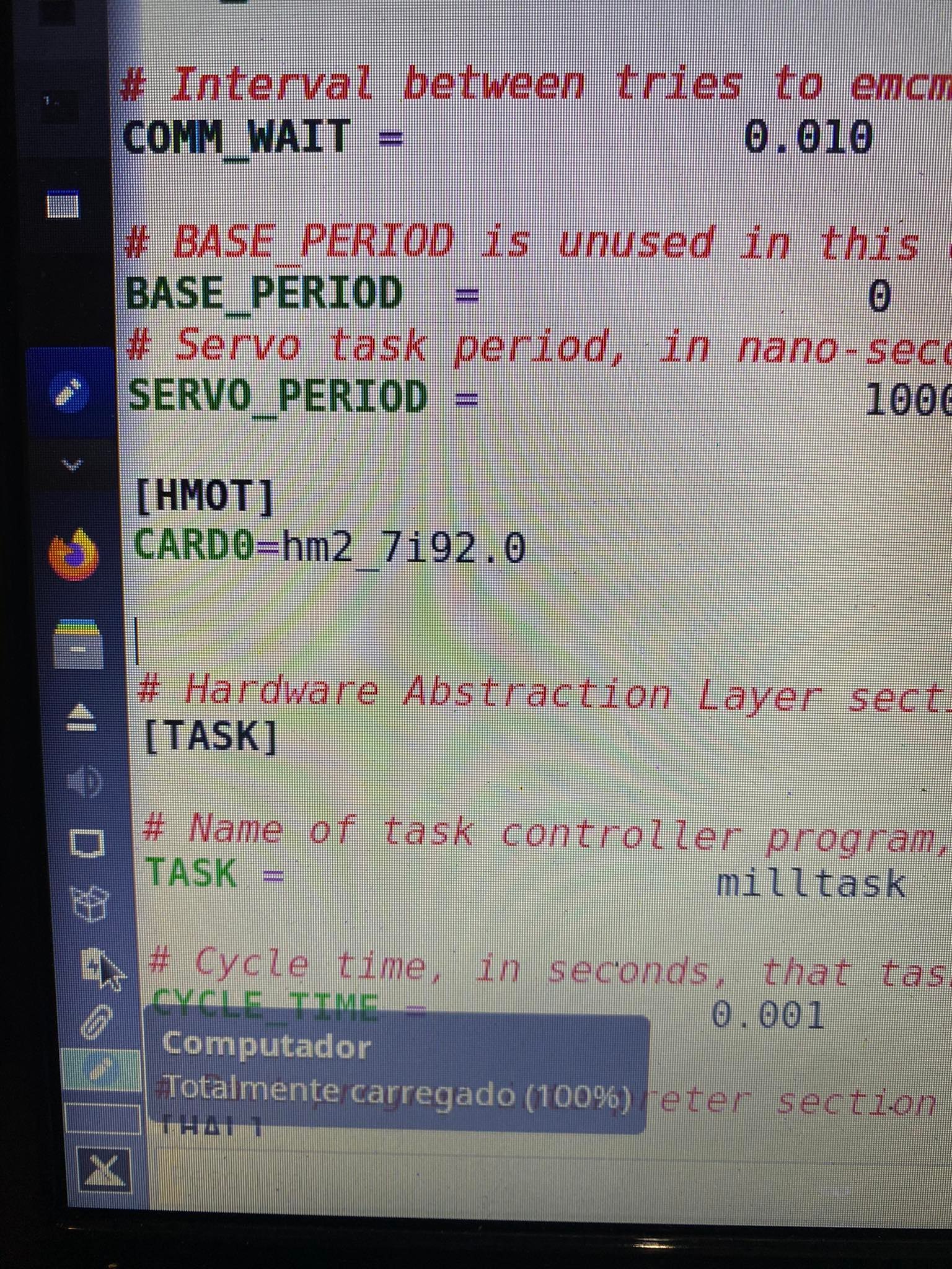

The only thing I did was launch ./bender in that directory, with the hal changed. the ini file is the same as the archive you posted to keep the machine parameters.
the screen launches now but it encounters that error instantly.
so i should also launch that command before ./bender or should i add that paragraph somewhere else?
sorry im quite new to this working environment

I would just sidestep that issue by not using the name substitution
That is, in an editor, globally replace "[HMOT](CARD0)" with hm2_7i92
Also I notice that the thread order is not correct, the
addf [HMOT](CARD0).read thread1
should be the first addf
addf [HMOT](CARD0).write thread1
should be the last addf
