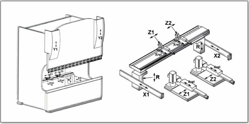

As an extra twist, the backstop is two axis. One axis for bend length and one axis for raising the stop up and down.
Both axis have homing switches.
Is it an industry standard to have Y axis for the ram, X axis for the bend length, and R axis for raising and lowering the backstop?
It doesn't really matter, as this config makes no use of G-code. But we can change the pin names if you want.
Would it be usual to lower "R" then adjust X1, X2, Z1 and Z2? I can see we need more table columns.
My pressbrake does not have the Z axis, only a single X and R
Is R just up/down, or variable?
