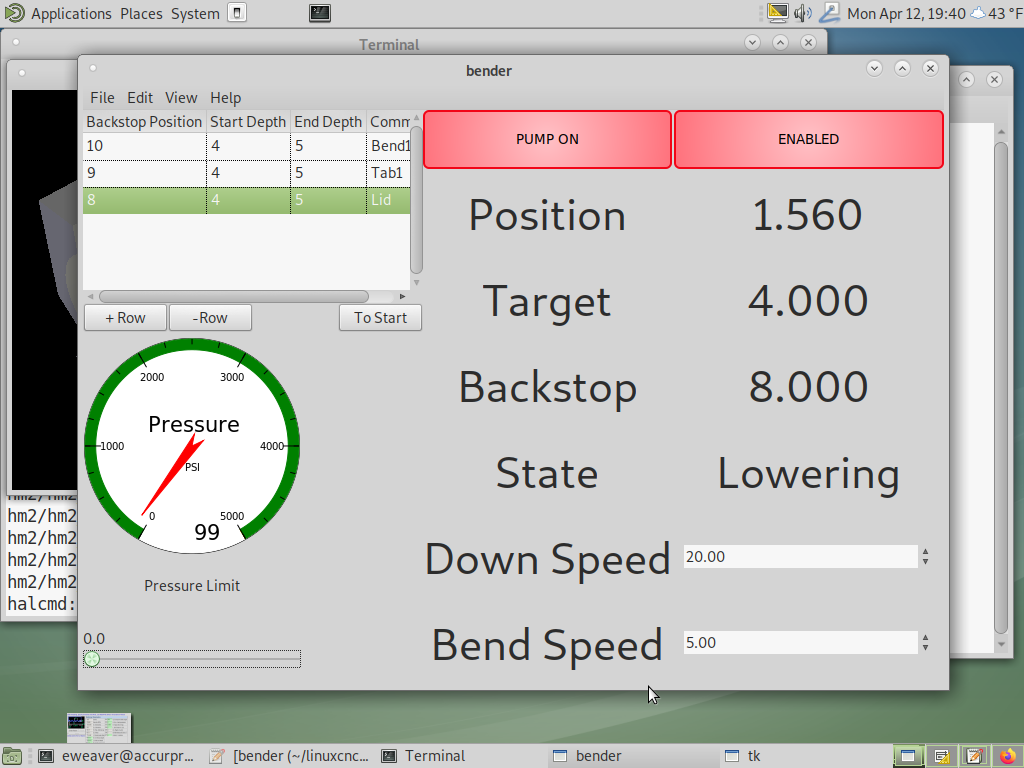

Here is an updated .ui file.
I have added a couple of buttons, one to turn on the pump and one to enable motion.
Note that the buttons both have a HAL pin to change their displayed colour.
What I would expect is:
setp bender.pump-enable 1
setp bender.enable-enable 0
bender.pump-button -> pump on
pump pressure-good -> bender.pump-light bender.enable-enable
bender.enable-button -> bender.enable-light, press.0.interlock simple-tp.0.enable, simple-tp.1.enable, pid.0.enable, pid.1.enable.........

OK, made some progress today, I got the press brake bending ram working with the controller! :)
Now for setting up the back gauge and doing some experimenting to see what all else it needs yet.
One thing I thought of is:
It has a pressure transducer that gives the bending pressure.
I would like to be able to set an adjustable MAX pressure, so that the bending pressure can be limited by what tonnage rating tooling is in the press brake at the time. Should this be done in HAL or be part of the press.comp?
13 Apr 2021 07:33 #205764 by andypugh
Replied by andypugh on topic Pressbrake CNC Control Setup Questions
I think pressure limits need to go in the press .comp.
Adding another state "overpressure" that only allows motion up.
Also, I think that perhaps the gauge belongs on the right too, though I can't decide top, bottom or under the on/off buttons.

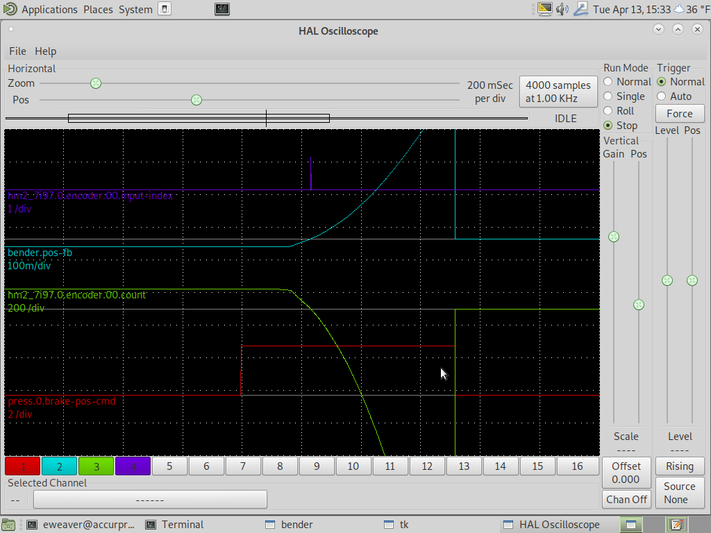

How do I get the ram press position set to 0 at the right location?
The encoder's index is about 40mm (1.57 in. on our side of the pond) down from the top of the ram travel.
The encoder's count and position pins both line up 0 with the index. (attached index halscope)
Should I put a HAL offset between
net brake-fb            <=  hm2_7i97.0.encoder.00.position
net brake-fb            => press.0.brake-pos-fb bender.pos-fb pressgui.pos
Do I somehow need to home the ram at startup?
Also the encoder reading shows about .024 in. negative from commanded position and when at rest.
Does that indicate that I am off on the PID tuning?
13 Apr 2021 22:12 #205833 by andypugh
I think so.
It would be an extra state in the press.comp state machine.
I think that in this case you can use the mesa card index-enable to get very accurate homing.
It's a bit late here to add it tonight. I will try to remember tomorrow.
The following user(s) said Thank You: EW_CNC
