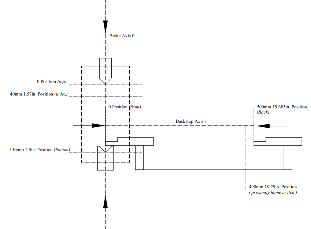

I have the brake ram working down=positive with the homing switch at the 0 negative end of travel.
The backstop has its homing switch at the back=positive of the axis travel, opposite direction of the ram.
The backstop has an index pulse approx. every 20mm.
I tried inverting the home switch input, which lets it search in the right direction, but it does not continue long enough to find an index after tripping the home switch.
Replied by EW_CNC on topic Pressbrake CNC Control Setup Questions
I'm back to working on the backstop homing. No success yet.So, what is the current status?

When you say "approximately every 20mm" do you mean that it is one of the scales with index marks at 20.00, 40.01, 60.03, 80.06 (or similar scheme) so that absolute position can be calculated from any two indices?
There was some discussion about a HAL component to handle such systems elsewhere on the forum.
But...

Unfortunately the backstop axis do not have linear encoders.
They are controlled by programmable Moog servo drives.
The motors give resolver feedback directly to the servo drives, then the servo drives output a simulated differential encoder signal.
So my encoder feedback to the 7i97 is coming from the servo drive. I would say it resembles a rotary encoder.
I don't exactly understand, does the resolver have a zero position that is passed on as the simulated index pulse?

14 Jun 2021 22:44 #212066
Yes, resolvers are absolute devices, and the drive will choose one position to call "zero" and can output a Z pulse at that point.
The HAL component was written on the assumption that the axes were the same with regards feedback. I assumed a sing mid-point index, but looking at the code it can be made to work with repeated indices.
Note how it does not pay any attention to index as long as the axis home-switch it active, so you need to set up some sort of target for the home switch that remains active until just after the last index. (this might be easier with a short target an an inverted input in HAL)
The the machine will run one way until home-switch goes false, then reverse direction and home to the index. You just need to ensure that this ends up always being the same index.

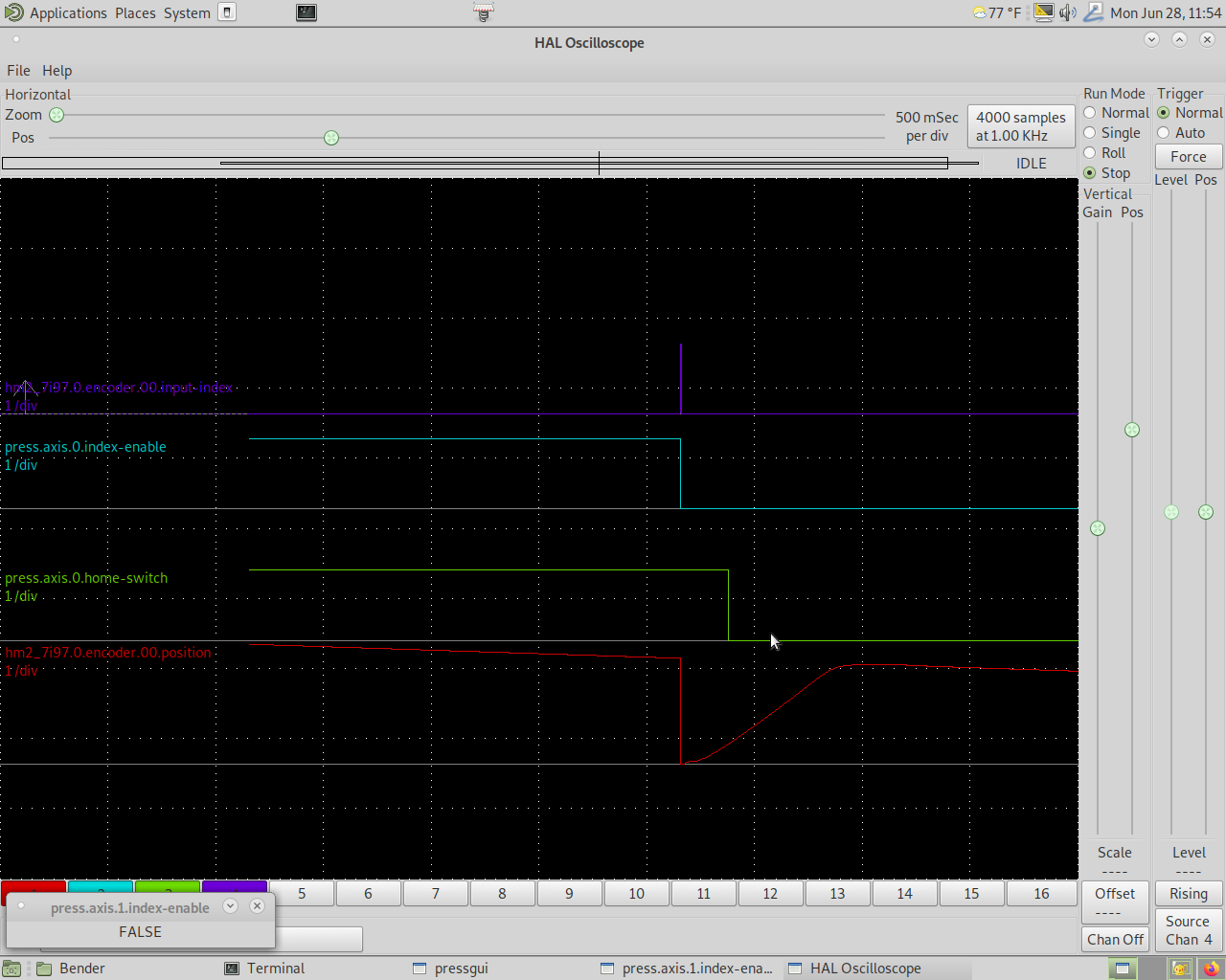

Andy, I'm still struggling to get the homing working right.
The ram axis with hydraulic homes ok, but it makes a fast move when it homes on the index. Is it applying the offset?
With the other axis it makes that move very rapid, seemingly without velocity control.
I attached a halscope of it homing the the ram axis.
Had you taken notice that earlier I had changed the press.comp to subtract instead of adding the offset? press.comp change
Would this be causing other issues for me?
I attached my .hal file
Thanks, EW
If you notice on the halscope, that it is applying the offset on index with the home switch active. (edit, the halscope is actually showing the reverse direction. so it is working like it should, but has that fast correction move.)Note how it does not pay any attention to index as long as the axis home-switch it active, so you need to set up some sort of target for the home switch that remains active until just after the last index. (this might be easier with a short target an an inverted input in HAL)
