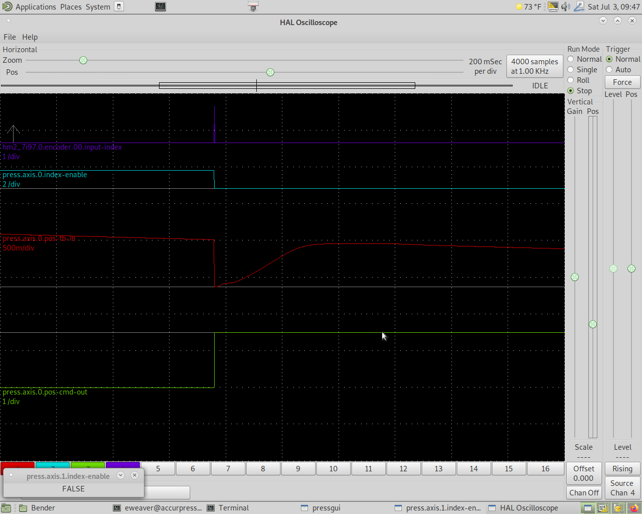

03 Jul 2021 13:26 #213558
Replied by PCW on topic Pressbrake CNC Control Setup Questions

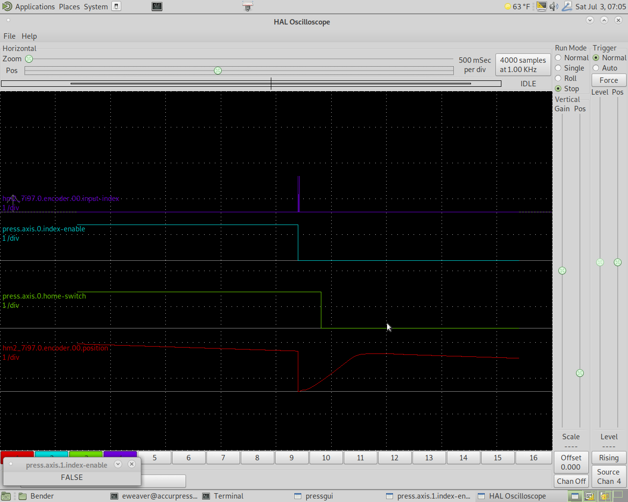

Can you plot the commanded and feedback point positions?
These should both be set to 0 when index is detected
- EW_CNC
- Posts: 116
- Thank you received: 33
03 Jul 2021 14:52 #213565
by EW_CNC
Replied by EW_CNC on topic Pressbrake CNC Control Setup Questions
- Posts: 18109
- Thank you received: 5329
03 Jul 2021 15:43 #213568
That does look about like what is expected, on index both the commanded
and feedback positions are zeroed. What is the home final velocity?
Can you plot the joint equivalents of the feedback and commanded positions
(plus the joint following error)
Another useful thing to plot would be joint.0.home-state

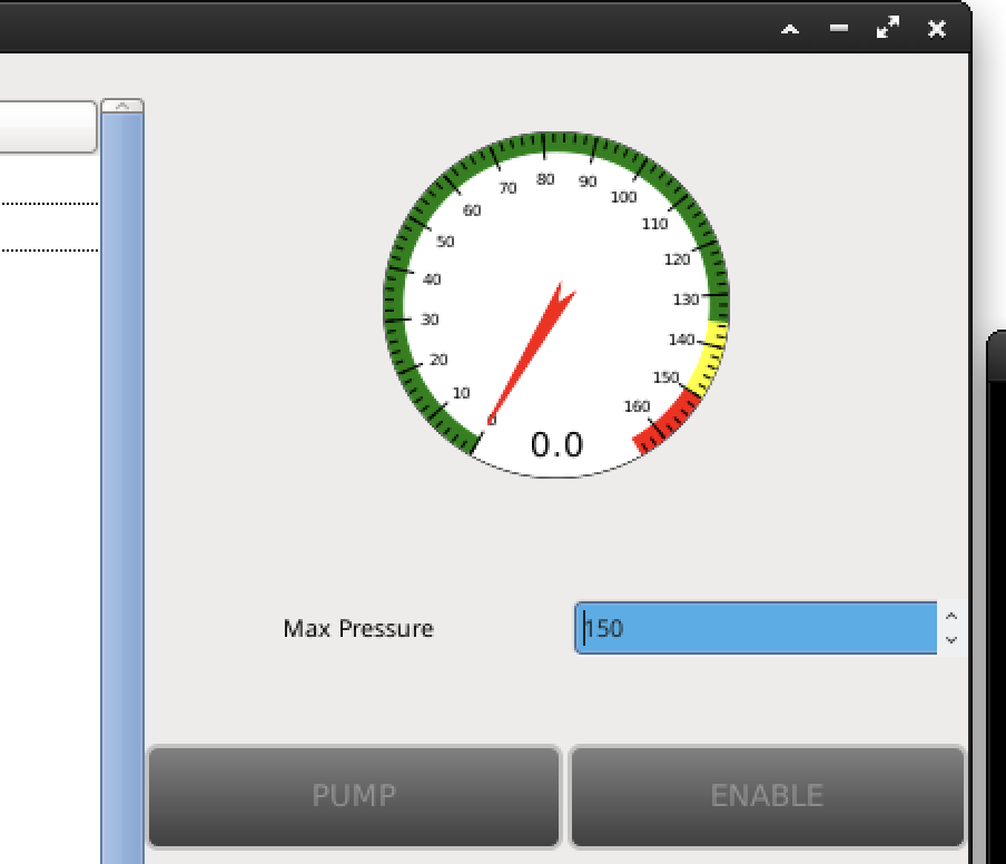

10 Aug 2021 20:55 #217424
by EW_CNC
I'm using the pressbrake to do simple bending jobs. Now I see the need to add the tonnage pressure limits we had mentioned earlier.
If the press exceeds the tonnage limit, motion should stop and only up motion allowed.
Depending on the tooling and job, the tonnage limit will need to be adjusted from the GUI.
It would be nice to have a hal input pin to set the tonnage limit anytime the ram is moving down.I think pressure limits need to go in the press .comp.
Adding another state "overpressure" that only allows motion up.
10 Aug 2021 23:17 #217432
Replied by andypugh on topic Pressbrake CNC Control Setup Questions
I have made a start at this, but I am short of time.
The pressure gauge now updates as the max pressure is changed.
I have also added an overload state to the state machine. I don't know if it works...
press.comp now needs it's max-pressure pin connecting to the UI max-pressure-f pin so that it is aware of the limit.
Both the UI and the comp need to be connected to the pressure meter output.
What is your current situation with homing? I have been sat on your last message in my inbox waiting for it to make it to the top of my queue.

13 Aug 2021 00:56 #217644
by EW_CNC
The new pins show correctly in halscope, but down motion does not stop when pressure exceeds max pressure setting.
I halcompiled the press.comp with the overpressure changes, made the connections in the GUI and hal file.I have also added an overload state to the state machine. I don't know if it works...
