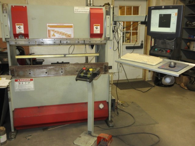

I’m working at replacing a cnc pressbrake controller with Linuxcnc 2.9 and Mesa 7i97.
I have the hydraulic directional servo valve working to jog the ram up and down. Now my next step is to setup the control to run the ram with the foot pedal and hand controls. I have played around with using mdi commands with g code sub programs, but that approach doesn’t seem to give me the type of control I’m looking for.
Should I be doing everything in .hal? I keep thinking if I could somehow use some of the QtPlasmaC configuration with the setup. For instance if I could save the return position, the deceleration position, and the down limit variables in a selectable file like the material file in QtPlasmaC. Does anyone have some ideas to turn me in the right direction?
The function of the foot pedal is: Press pedal down and activate input 6. Ram moves down at rapid velocity towards Y-6. At deceleration position, the ram slows down to bending velocity and continues towards down limit and stops motion. At any time the pedal is released it activates input 7 which initiates a move toward return position. Return position, deceleration position, and down limit need to be adjustable positions. I attached the ram axis movement and position drawing, and also the pedestal wiring diagram.

To answer another question: Yes I think you should be doing much of the control in realtime and in HAL.
You certainly want to be monitoring the foot-switch in HAL, to guarantee a prompt response. Possibly you want a dedicated HAL component for ram control. (That is certainly how I would do it. It should be quite simple, and as it is simple, it is easier to trust)
I would start with a custom component that takes home, bend and finish positions as inputs along with the foot switch and safety curtain (or whatever). The output could either be a static position fed to a limit3 component, or the velocity/accel control could be handled internally.
If using a limit3 the outputs would be target, current accel and current velocity.
I can help with the HAL component.

If you have the bender config downloaded to a LinuxCNC machine, then you can run that simple UI standalone (though it doesn't do very much without the rest of LinuxCNC to handle MDI commands as things stand)
The HAL for a hal-only config would look like:
loadusr UI
loadrt pid
loadrt limit3
loadrt magic_hal_component
addf {them all}
net pins-from-ui => pins-into-new-component
net pins out-of-new-comp => limit3.0
net limit3.0 => pid.0
net pid.0 => control-of-your-hardware
cd ~/Downloads/Bender
halrun
loadusr gladevcp -u bender.py bender.uiThe HAL for a hal-only config would look like:
loadusr UI
loadrt pid
loadrt limit3
addf {them all}

Thinking about this some more:
If you use a custom HAL component then there is no need for G-code, so your UI can run standalone, rather than inside an existing GUI.
There might still be enough reason to use a GUI, probably something customisable like Gscreen, stripped of the irrelevant parts. This would be to get things like on/off control mainly.

I am using a tubing bender with a standalone glade gui. Maybe I could use it as a starting point with a custom HAL component. I would like to be able to save the return position, deceleration position, and down limit selector like plasmaC has for its material settings. What are the pros and cons of Glade vs QtVCP?
Attached my tubing bender files.

Does that UI work? It looks like it is only partially set up, but perhaps I am missing things. (I can't easily trial-run your config without the Mesa cards, so this is based on looking at the UI And handlers)
I had actually forgotten that HAL_Spinbox (etc) create HAL pins. That would be a very easy way to get basic functionality.
I feel that this sort of thing should be table-driven, with a set of backstop positions and bend positions. To do that there needs to be a way for the handler code to either change the value in the spinbox (which is probably a good way to give a visual check for the operator) or to have separate hal pins created by the handler for its own use.
I feel that saving and loading bend tables as files should be possible too.
But, as an initial experiment, A UI with spinbuttons to provide positions and speeds should work.
For reference, it is pretty easy to add "private" HAL pins to a python handler file. This is documented here
linuxcnc.org/docs/2.8/html/hal/halmodule.html
Attached is a version of your handler.py that does this. I have linked your next/previous buttons in the second tab to them.
