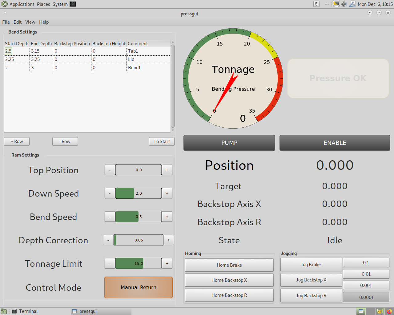

06 Dec 2021 23:07 #228476
by EW_CNC
Replied by EW_CNC on topic Pressbrake CNC Control Setup Questions
Here is an update on my CNC Pressbrake control.
The ram control is working good, I'm using it regularly for bending.
I'll attach my latest files. My pressbrake is set up for imperial units.
The backstop can be jogged, but the homing for the backstop still needs work.
This is a stand-alone setup made possible with the efforts of Andy Pugh's press.comp.
Thanks All!
Screenshot:
Thanks All!
Screenshot:

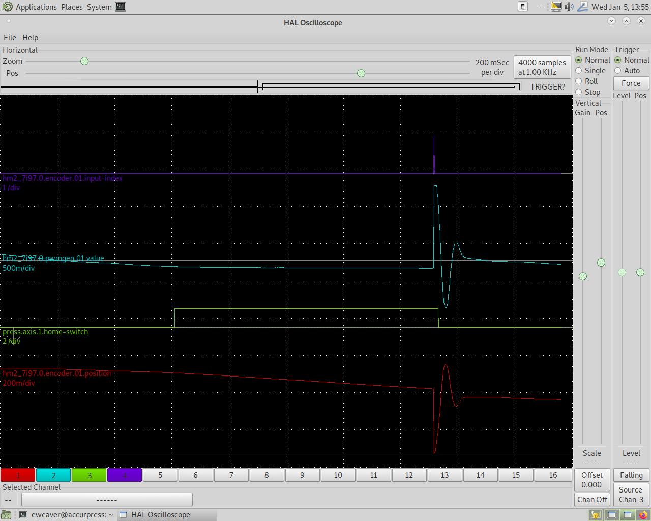

04 Jan 2022 23:20 #230805
Replied by andypugh on topic Pressbrake CNC Control Setup Questions
Is the backstop homing the same whether it starts on the home switch or off the home switch?
Is there any chance that you can get a Halscope recording of the backstop motion? (I realise that this might be tricky)

05 Jan 2022 20:18 #230894
by EW_CNC
The backstop homes, but as it hits the index point it jerks rapidly before it goes to its home search velocity.
I start the control with the backstop close to the point where the home switch drops from high to low so that the encoder count starts close to 0. That way when homing applies the offset, it is minimal. The farther from the homing point, the longer the fast travel is.
I'll try and get a halscope screenshot starting off of the homeswitch.
Halscope screenshot, Starting on home switch:
