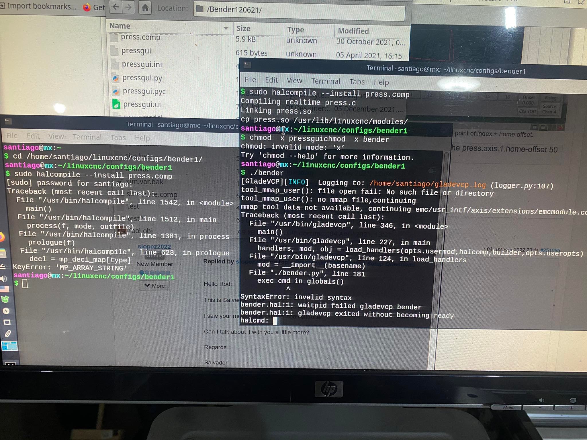

yes i have done that. but i haven't yet created any configurations for my particular machine.
I'm not understanding what the .comp does when i install it, so i don't know what to do previously.
should i create a configuration and assign axis to the pwm outputs/encoders first? or should i start with nothing? i am doing this in a PC with a fresh 2.10 linuxcnc installation.
Do you have discord or other if possible?

Okay, I understand now,
Yes it doesn't use gcode but generates pulses according to a user-defined table with the bends, which is much much better for my case
i got this errors:
i got this errors:
i can create a new config with this boards using pnc conf, then modify it as the ones you’ve sent right?
You could use pnc conf to get some of your mesa board settings and copy the revelent lines to the bender files.
This is not a standard configuration that uses INI File settings and G Code, the GUI and press.comp control is all in the bender file folder, You need to incorporate your machine settings into those files.

I don't think that there is any point trying to run the config until the HAL component compiles without errors.
Are you using files from this post?
forum.linuxcnc.org/30-cnc-machines/42100...ons?start=100#228476
I am rather confused about the halcompile error. Which version of LinuxCNC are you using?
I am also confised by the Python error, bender.py line 181 (where the problem is raised) looks like a pretty straightforward bit of Python.
