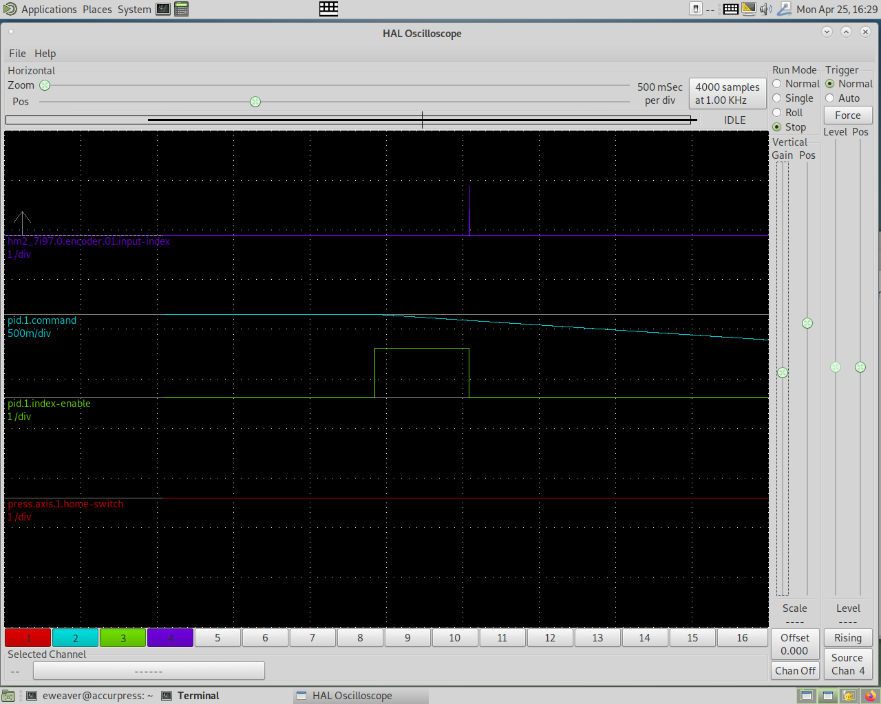

Replied by PCW on topic Pressbrake CNC Control Setup Questions

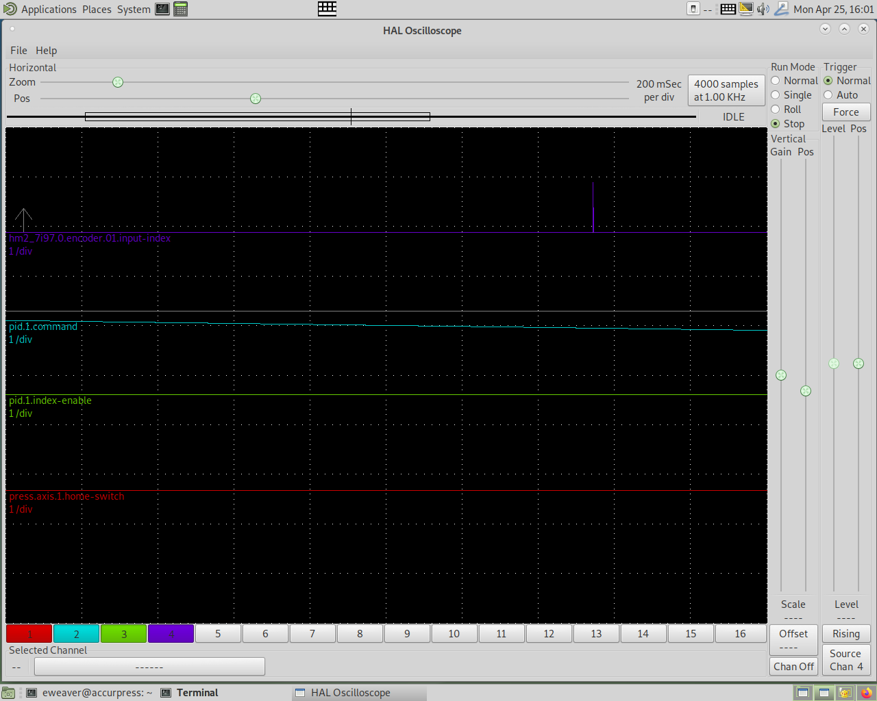

Could you add a plot of the commanded position?
Does the PID component have index-enable connected?
What is supposed to happen on homing to index is that the when index is
detected, the encoder position is set to 0.0 and index-enable is set false.
LinuxCNC watches the index-enable signal, and when it has a high to low transition,
it sets the commanded position to 0.0 to match the feedback position.
In addition, the PID component watches index enable so that any derivative
or feed-forward term calculations ignore the position step in its commanded and
feedback inputs.
feedback inputs.

25 Apr 2022 21:10 #241252
by EW_CNC
Replied by EW_CNC on topic Pressbrake CNC Control Setup Questions
it looks like pid.1.index-enable is false before getting to the index.
are the pid connections wrong in the hal file?
i'll do some more testing.

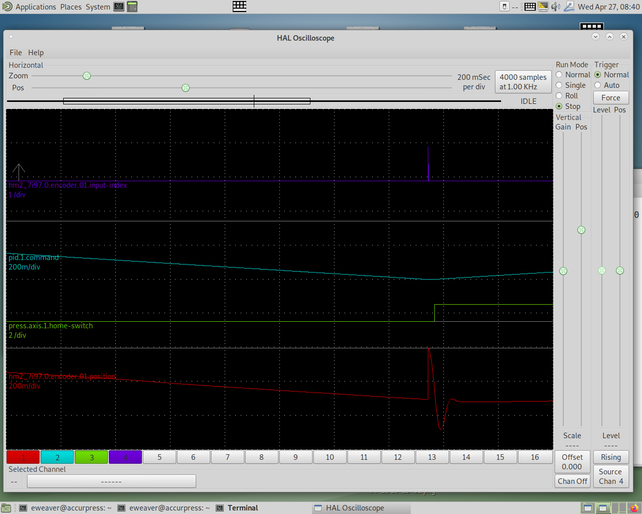

28 Apr 2022 01:22 #241424
by EW_CNC
Ok, I did some testing.
Backstop axis: If I starting homing with the home switch true, It moves at search velocity towards positive.
When it moves off home switch true and at the first index it does a very rapid jerk and proceeds with homing and completes homing. (Homing in the opposite direction resulted in a fast rapid move toward positive end of travel, not good!)
Screen Shot:
Also this last change causes the position after homing to be 0 right at the index, not at the point of index + home offset.
I'll keep doing more testing on my end to see if I can give you more info.
Thanks,
EW
Screen Shot:
If I set it to zero homing doesn't work.if this doesn't work, then try setting the axis home positions to zero ( the press.axis.1.home-offset 50 line) just to see what changes.
Thanks,
EW
