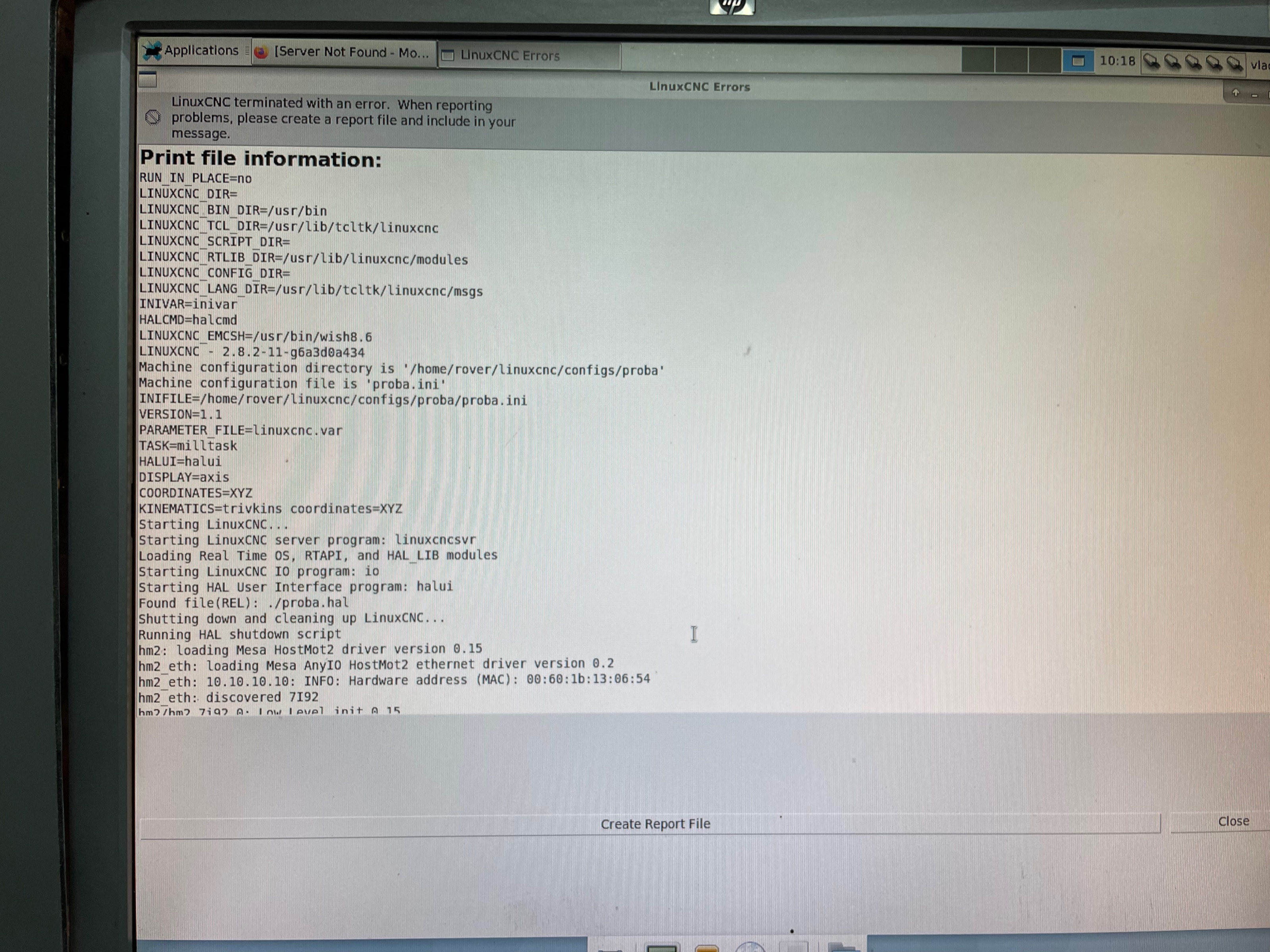

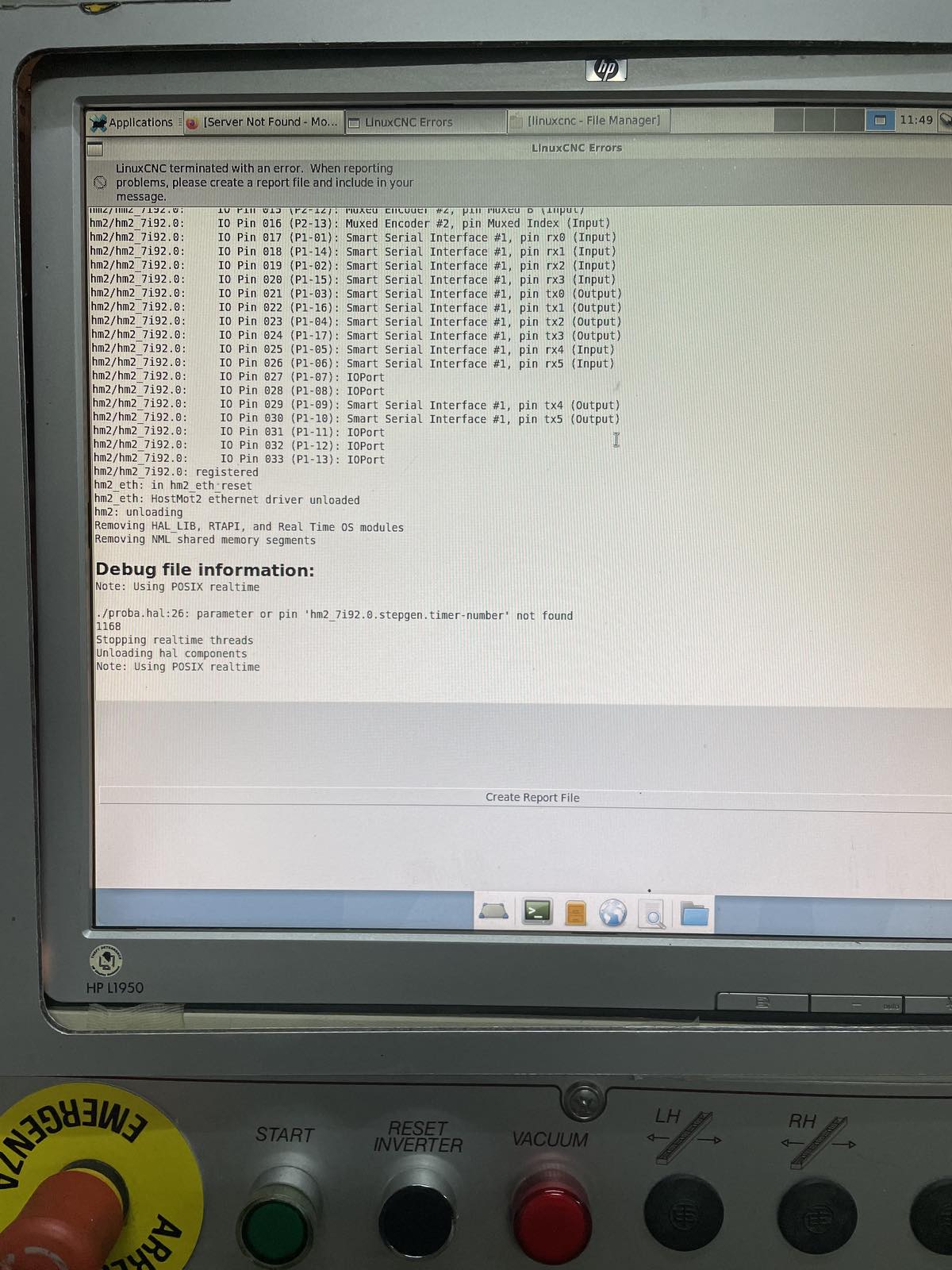

after i update firmware to 7i92, there is new bug report. also i attach ini and hal.

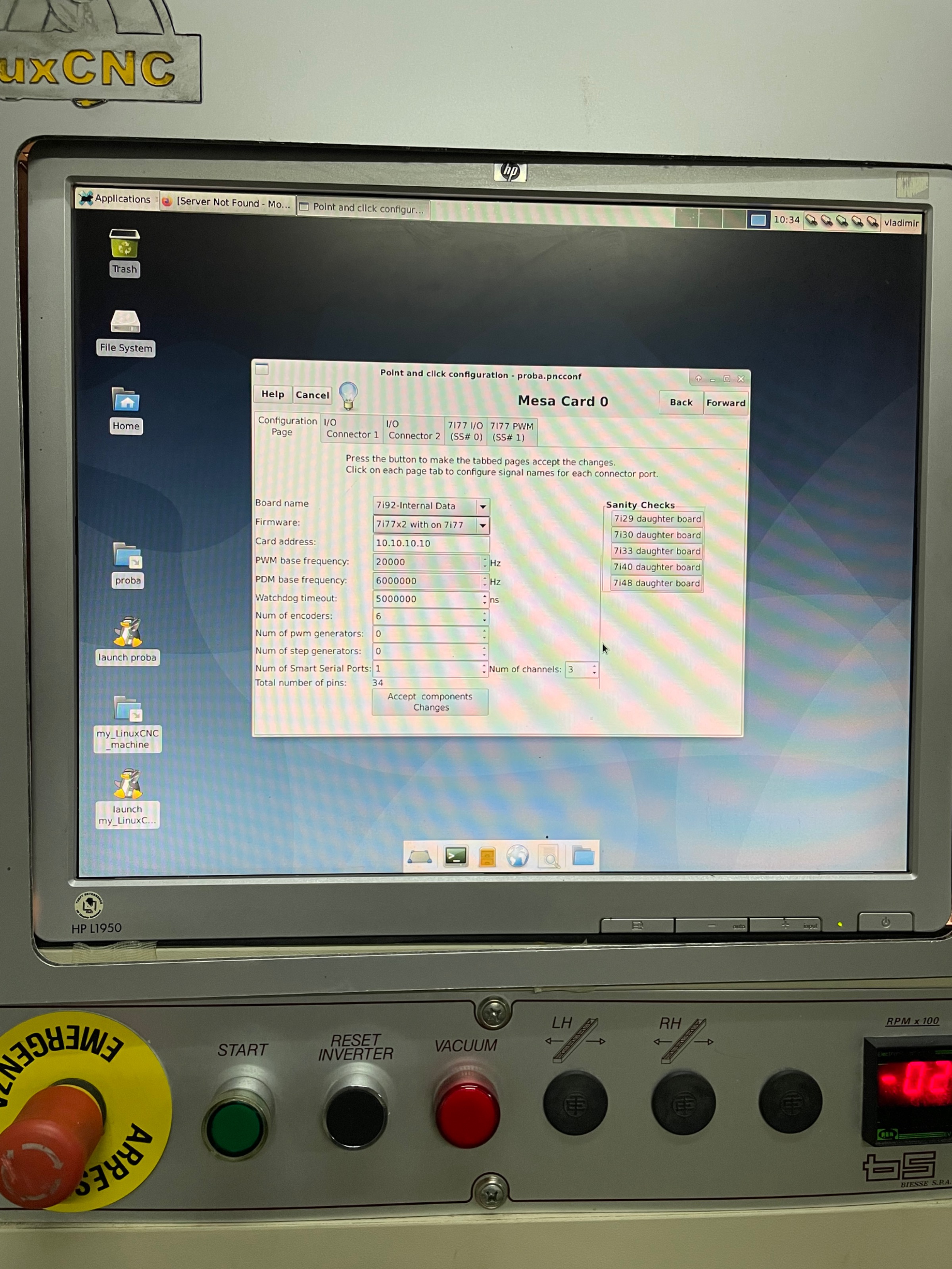

07 Jan 2022 12:26 #231041 by tommylight
Replied by tommylight on topic biesse rover 316 retrofit
Yeah, that will need a flash with the firmware for 7i77, it seems it has stepgen firmware.
So
sudo mesaflash --device 7i92 --addr 10.10.10.10 --write 7i92_7i77_7i74D.bit
then
sudo mesaflash --device 7i92 --addr 10.10.10.10 --reload
Download the support files from www.mesanet.com , unzip, find the file mentioned above with the .bit extension and copy it to your home folder, then use the above commands.

07 Jan 2022 12:34 #231043 by Masiwood123
Replied by Masiwood123 on topic biesse rover 316 retrofit
Yes Tom i already did it but i didn’t reload.. now i am on the line to install pc again and will try again. Thank you very much!

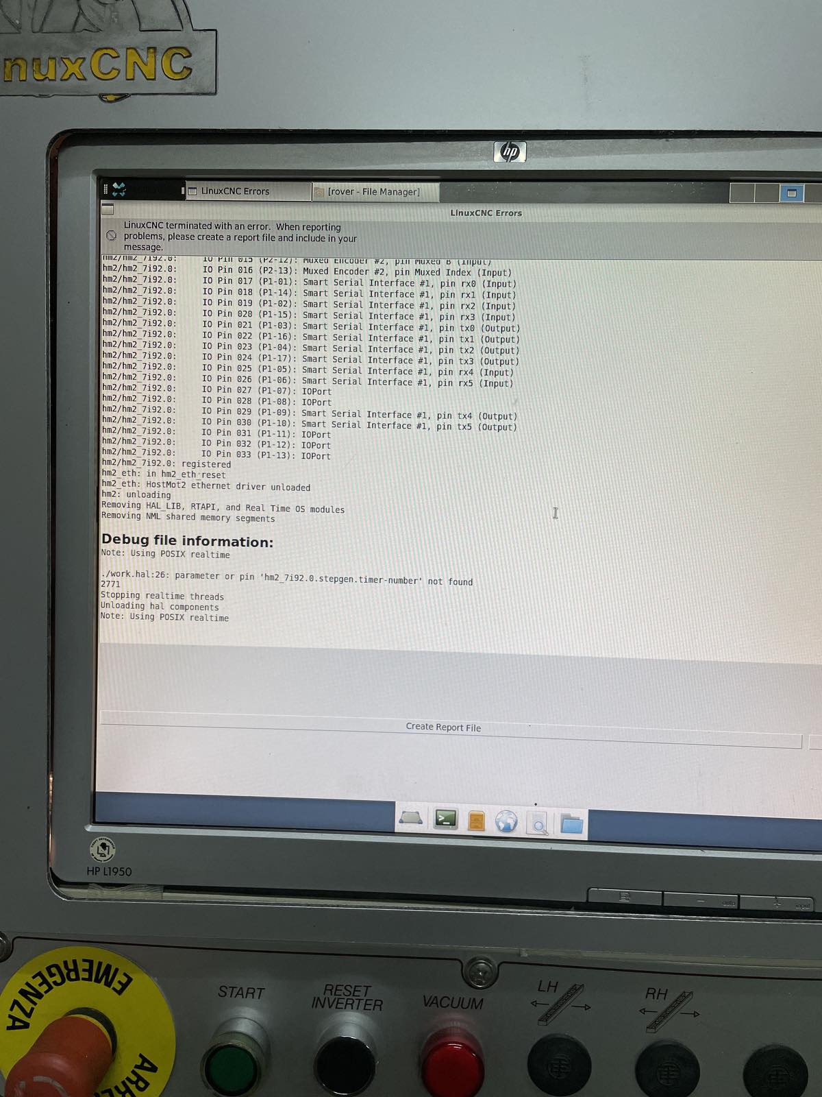

07 Jan 2022 16:39 #231068 by Clive S
Replied by Clive S on topic biesse rover 316 retrofit
The error shown is on line 26 in the hal file
setp [HMOT](CARD0).dpll.01.timer-us -50
setp [HMOT](CARD0).stepgen.timer-number 1
I don't see the ref  [HMOT](CARD0) in the ini file.
   So try just try and comment it out with a #    like #setp [HMOT](CARD0).stepgen.timer-number 1
To see if it loads
