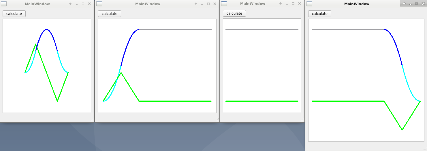

This is a nice example of 4 different s-Curve motion commands.
Picture 1 is a command that can not reach the max velocity.
Therefore the code shorts the motion command into a shorter period of acc and dcc.

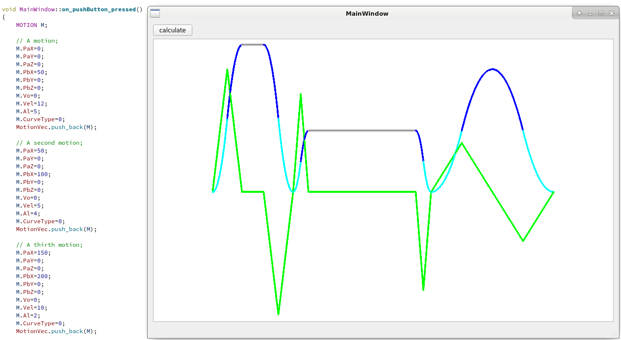

Picture 2,3 and 4 are quite nice. These can be used as a motion command between a M3 and M5 traject.
The motioncommand has 4 types to assign the S-curve :
-- type 0 = S-curve at left and right.
-- type 1 = No left S-curve
-- type 2 = No right S-curve
-- type 3 = No S-curve on both sides.
3 motion commands executed from a bucket (vector).
Stopwatch: 9.99986 sec
Calcuations: 24619 (threat pause = 900000 ns).

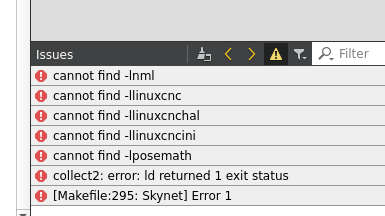

20 Dec 2020 07:36 - 20 Dec 2020 07:36 #192535 by Aciera
So I made a copy of the folder "Qt-skynet-app" and changed the dimensions in Xml/create_xml_templates.cpp, which seems easy enough to do. However now I get errors when trying to build:
I even get this error when trying to build the original Skynet.pro from the unchanged "Qt-skynet-app" that used to build fine before.

20 Dec 2020 13:10 - 20 Dec 2020 13:14 #192563 by Grotius
Hi Arciera,
Copying the whole source directory is not a good idea.
What happens is that your copy has overwritten parts of the build directory, but not everything.
To restore this, delete your copy directory. (eventually save your edited xml files).
After that you have to do a => build => clean all projects from your orginal Skynet directory (open qt => skynet.pro)
This will remove all build files except your "hal, robot, gcode folder".
Then compile the orginal source again.
If this is not working, delete all, unzip the downloaded Skynet project again.
Oke nice !
Working with Qt takes some experience. I have dealed with most of the issue's already.
My workflow would be,
1. unzip skynet.zip.
2. load project, build one time. (this creates the factoryapp.xml file for you).
3. copy the folders : gcode, hal, etc to your created build dir.
4. run program.
5. edit code to your wishes and compile frequently.

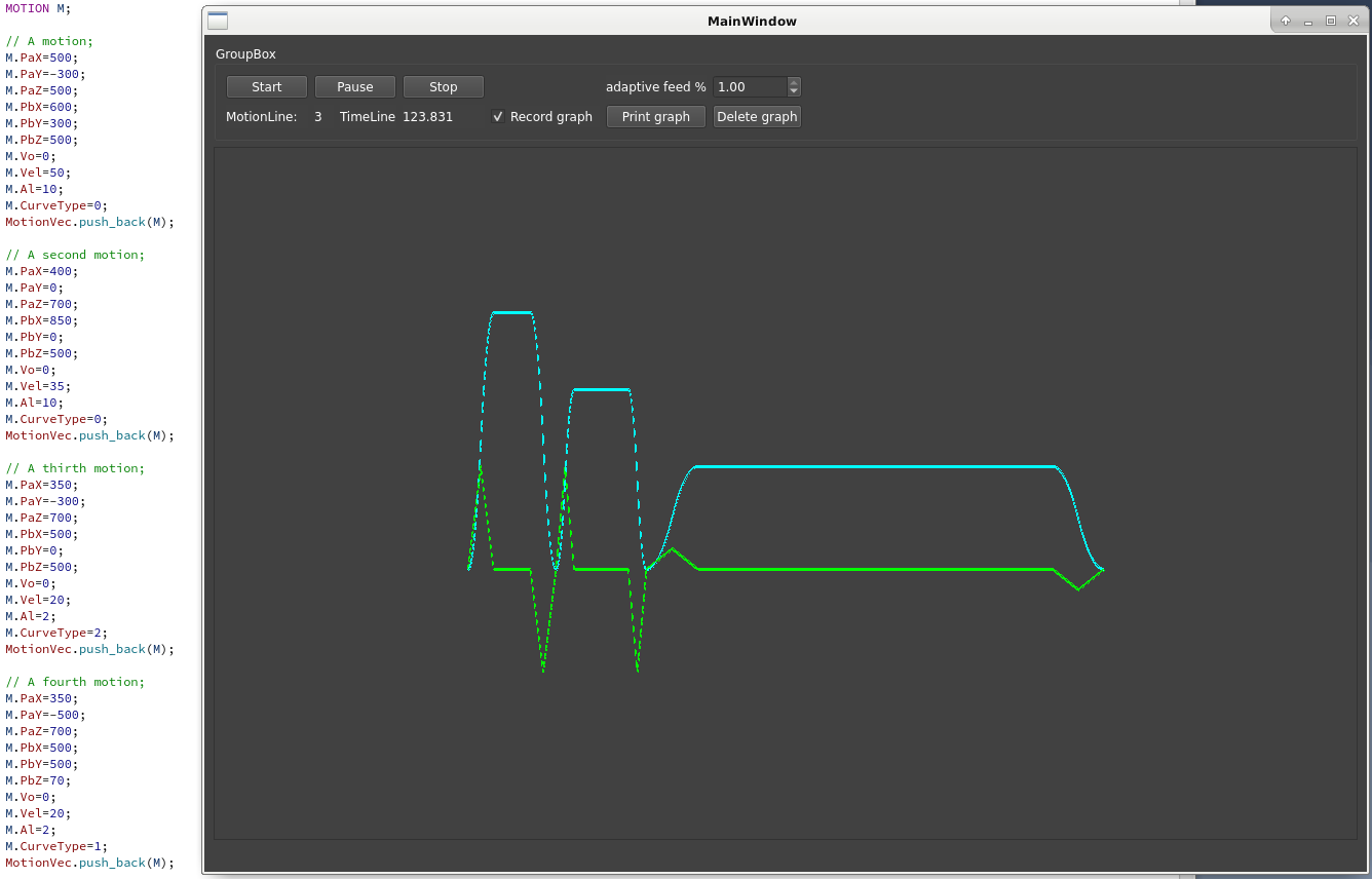

20 Dec 2020 20:49 - 20 Dec 2020 21:58 #192602 by Grotius
The motion planner works quite nice. I integrated adaptive feed from -1 to 1. It can move back without restrictions.
In lcnc the restriction is (or was) a maximal reverse run until a M3/M5 is reached.
In the picture the last motion is build up from 2 half assigned Scurve commands. Next thing to do is Dtg (DistanceToGo).
And maybe a live velocity control.
The motor output speeds are still tested oke.
After some trial and error I mentioned that the chrono timer can best be used with a delay command,
instead of calculating the disired delay.
On github is a ngc274 intepreter for download. This one can be attached to the program quite easy when we are ready for it.
