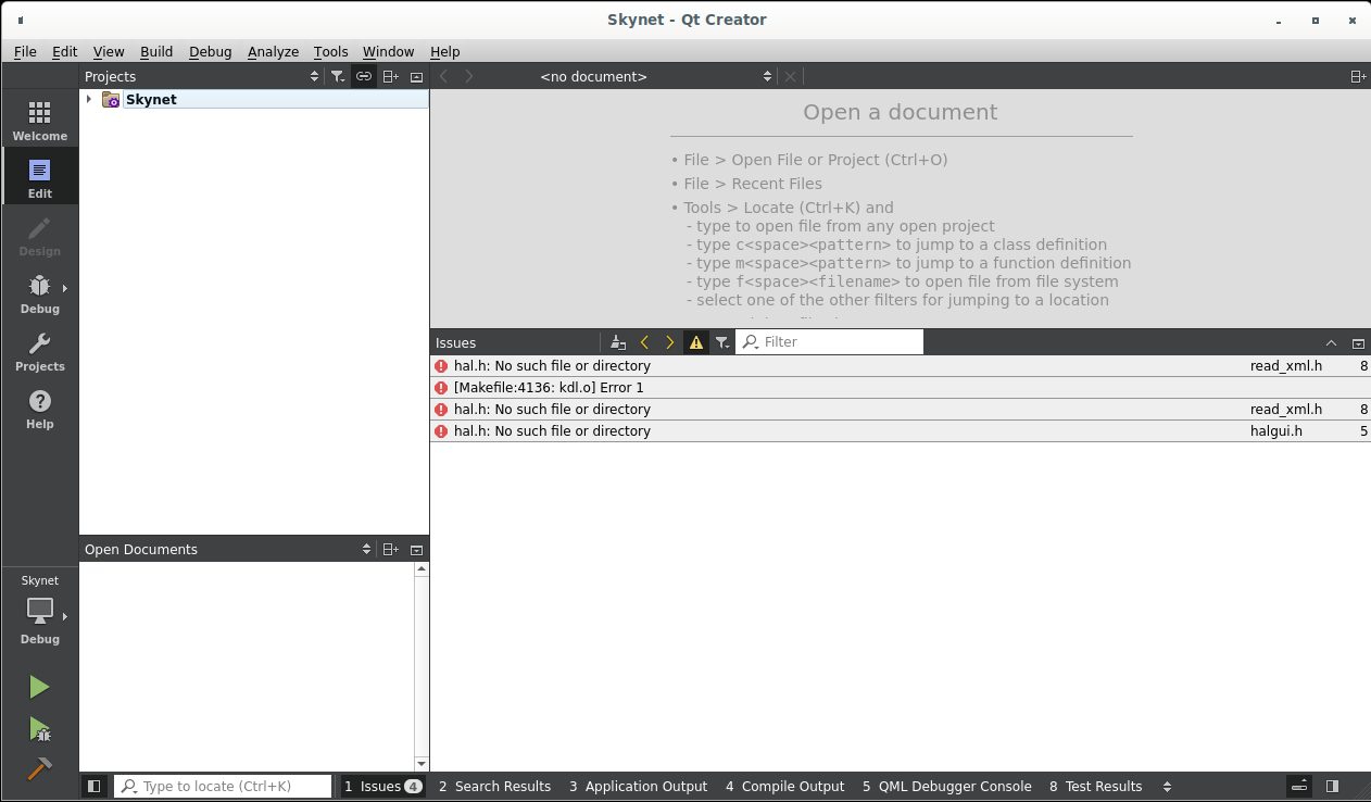

Hm, I seem to have broken things. I reinstalled your iso on a different computer and copied the folders "build-Skynet-Desktop-Debug" and "Qt_skynet_app" over to the desktop my work machine. However when I try to run Skynet.pro in qt-creator I get errors:

Hi Arciera,
This can be solved by checking the .pro file, this section points to hal, check your current hal includepath on your local pc :
#lcnc
INCLUDEPATH += /usr/lib/ \
/usr/lib/linuxcnc/modules/ \
/usr/include/ \
/usr/include/linuxcnc/
LIBS += -llinuxcnchal -lethercat -Iinclude -Isrc/emc/rs274ngc -Llib -lnml -llinuxcnc -llinuxcnchal -llinuxcncini -lposemath

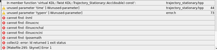

Ok, thanks. I guess that is because I removed the installed LinuxCNC and use a RIP install now. So I copied the "linuxcnc" folder into the /usr/include folder and it compiled a while before comming up with this:
I wonder if maybe I should just reinstall Linuxcnc through the package manager. Although I have been advised to remove that when using a RIP install.

Hi Arciera,
Ahh, i already thought about something like that.
Keep your Lcnc rip where it was compiled. Just link to the libs pointed out it in the pro file.
So your includepath's will be like : "/home/yourpath/linuxcnc/lib/" etc. Then it's ok.
It's a good practice, but reinstalling the iso takes 10 minutes, As the build-essentials for the rip are already in the iso.

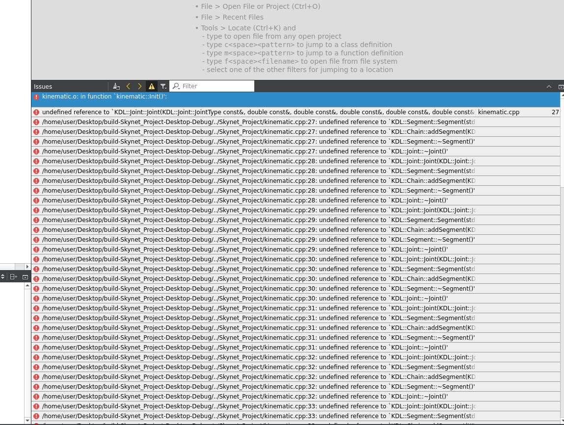

I get build errors about KDL. All reference about KDL seems to have been removed from Source and Header folders.
I also tried to build on a fresh ISO install.

Hi Arciera,
I think you have to look at the pro.user file of the project. Some of the links over there have to be aligned with your file structure.
