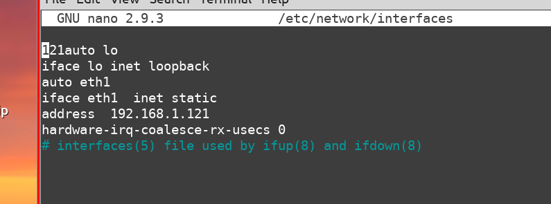

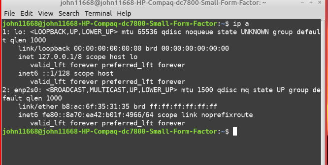

14 Apr 2022 15:46 - 14 Apr 2022 15:49 #240239
by john11668
Replied by john11668 on topic New install of Mesa 7i92 on TCL lathe
So I have edited and saved the file as shown
I have tried a number of IP addresses
192.168.1.1
192.168 .1.121 default
and even
169.254.61.149 This is the address given if I connect the card to a windows machine and look for it using C prompt and ipconfig /all . On windows I can ping the card using that address and it responds
So I reconnect to linux and try with ip a
This is what I get
I see nothing in that which looks anything like an ip address for the Mesa so really am fishing in the dark for something appropriate to use as the address in "/etc/network/interfaces"
Ideas appreciated

- robertspark
- Posts: 915
- Thank you received: 216
14 Apr 2022 16:14 #240242
by robertspark
Replied by robertspark on topic New install of Mesa 7i92 on TCL lathe
looks like Linux is using ip6 for your ethernet card. not sure how to force ip4
