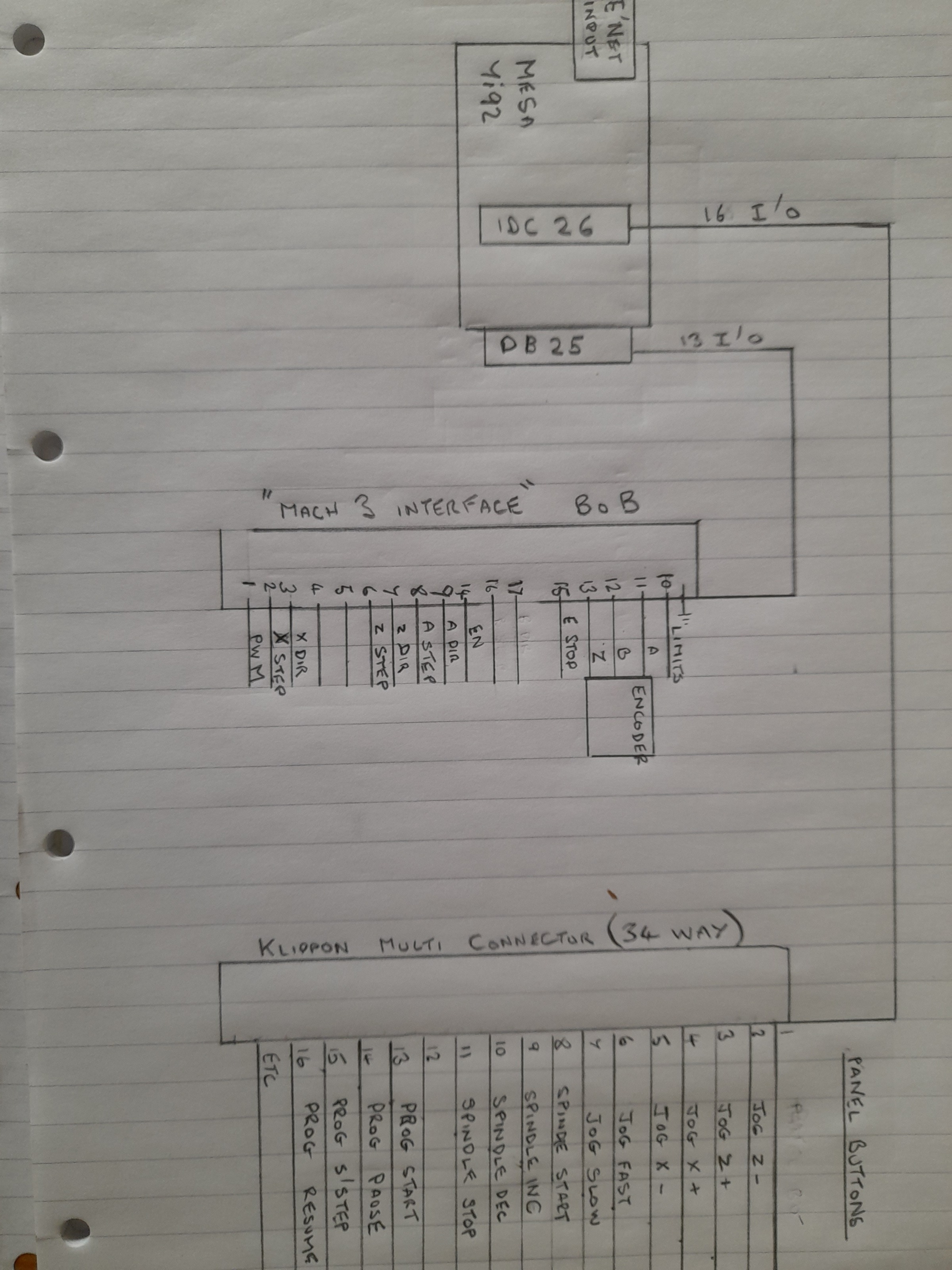

Thanks Robert but I am now used to gmoccappy so would prefer to stay there as long as it does not cause problems .
Wiring plan if it helps .
Basically DB25 is identical to my original BoB
IDC26 replaces my original second parallel port which only connected to panel buttons
3 encoder pins are as previous . I dont yet understand the full options of the encoder which connects to the driver using DB15 (I think)

With regards to your 34 way your connector, please be aware that the inputs are only 5v tolerant, ie any voltage over 5v will, as we say, "release the magic smoke". This is mentioned in the second paragraph on the first page after the contents.
The only issue with using 5v for I\O is that it may pickup some stray electrical noise depending on the wiring. Sometimes it can be a bit of a "hit & miss" affair. If you have already implemented an arrangement to mitigate the noise or are using some method of converting of using 24 volt I\O to 5 volt I\O you can disregard this.

I too would not recommend your other port interface with the 7i92.... I also think you may need a different firmware file too which frees up the second port for gpio
I have just designed and had manufactured an interface board for one of the spare 7i76e ports I have. it would not work for your application as it has the pins set as output. I put it in for manufacturer Wednesday and it's on its way from china.
I would suggest you do something similar
I'll post some info later, all SMT and din rail mounted by design.

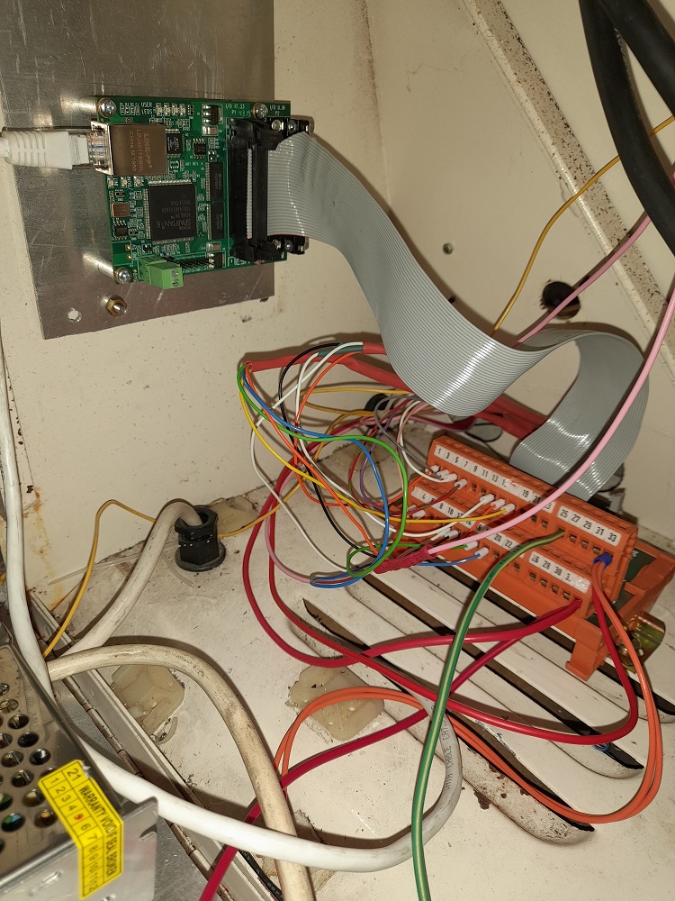

Just to clarify.
The Klippon is in effect a length of terminal strip . Each of the 26 IO connections on the IDC 26 can be connected to a button on the keyboard which ( when pressed ) grounds the pin . There are no functioning electronics in there
It is just a convenient way of connecting a the ribbon cable from the IDC pins to my button /panel wiring so would some additional bit of electronics be necessary

With the wiring hanging out in the air like that the chance of picking up electrical noise\interference is an issue. I would have tried to keep the ribbon strip as short as possible (shorter than what you have). Every wire acts as an antenna to s certain extent.
The use of ferrules is a very good idea, far better than trying to insert bare wire ends. Keeping the wiring neat and tidy is good practice, at the very least in aids in trouble shooting. It does take slightly longer to hook up, but it is well worth the effort.
One practice I have tried to keep to is have the power supply wiring on one side of the cabinet and the I\O on the other, trying my best to keep any crossing over to a minimum. This may not possible in all situations.

16 Apr 2022 11:40 - 16 Apr 2022 11:41 #240390
by john11668
Replied by john11668 on topic New install of Mesa 7i92 on TCL lathe
Wiring not complete yet and much of it will pull back into the panel area which is a bit of a Faraday cage . Needs a bit of slack for working on the switches anyway.
AFAIK all the higher voltage cables are screened apart from the stepper driver supplies which are at 60v but they do go via the e-stop in the panel.
There has to be some proximity particularly at driver connections but I was aware of this . can cross the bridge when we get there
