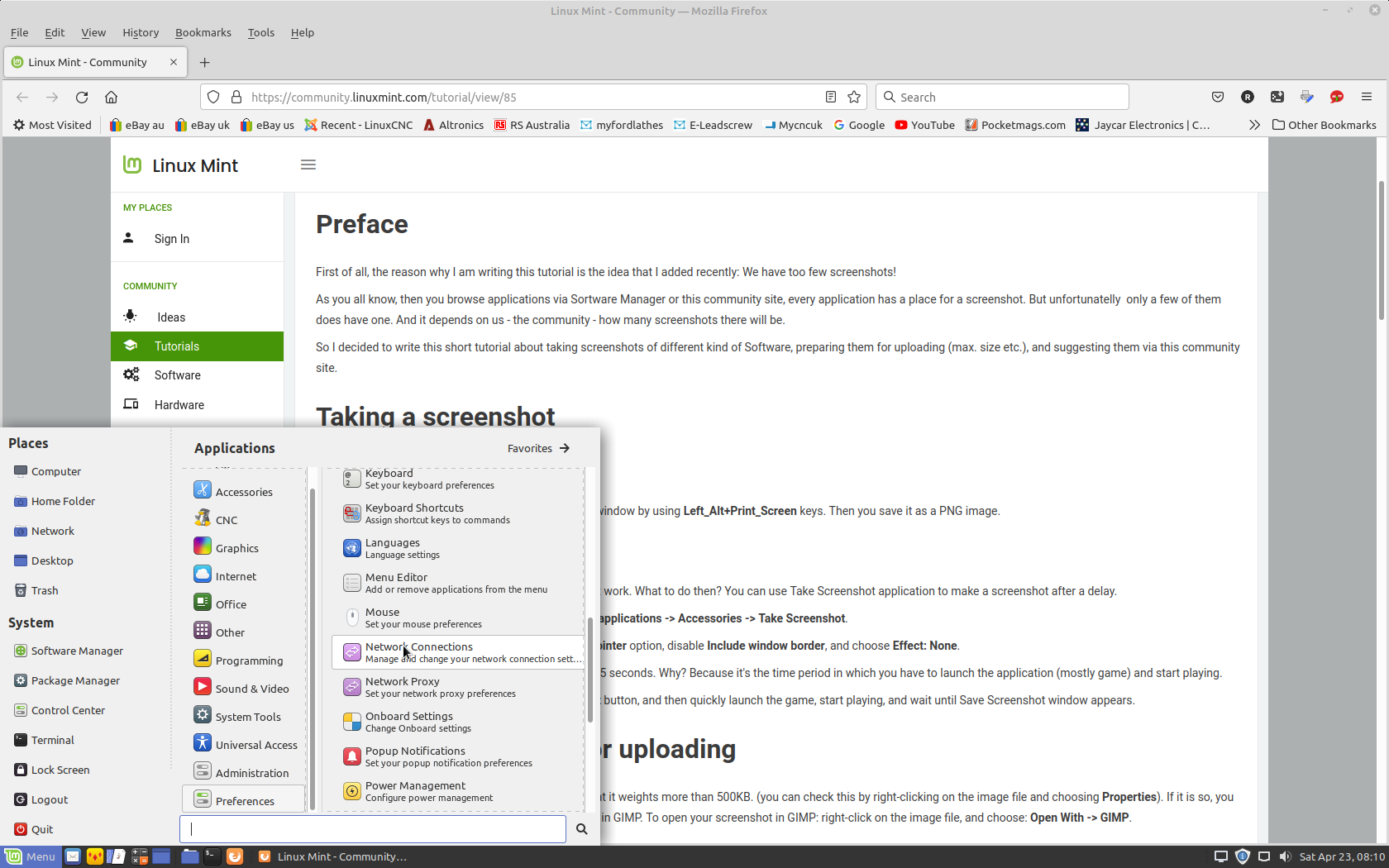

Menu / Network is not want you want
You need to use
Menu / Preference / Network Connections
But first I would revert the /etc/network/interfaces file back to it's original contents as shown here: forum.linuxcnc.org/39-pncconf/45604-new-...athe?start=50#240879
Then reboot.
Then you can use Menu / Preference / Network Connections to configure the USB to LAN adapter. Whilst doing this make sure that the MESA to PC cable is unplugged. All settings can be left be, except to change the IPv4 Setting "Method" to DHCP. This is assuming your router gives out addresses.
After this is done we can start on the MESA side of things.

Network connections via that route gives me just an empty pop up box .
At bottom left the plus sign allows me to add a connection . Now I am using a lan cable into a USB port so looked for a USB option but non evident in the hardware selection.
These are Bluetooth
DSL/PPPoe
Ethernet
infiniBand
Mobile Broadband
Wifi
So I am guessing the second DSL . so take me from there please
These are Bluetooth
DSL/PPPoe
Ethernet
infiniBand
Mobile Broadband
Wifi
