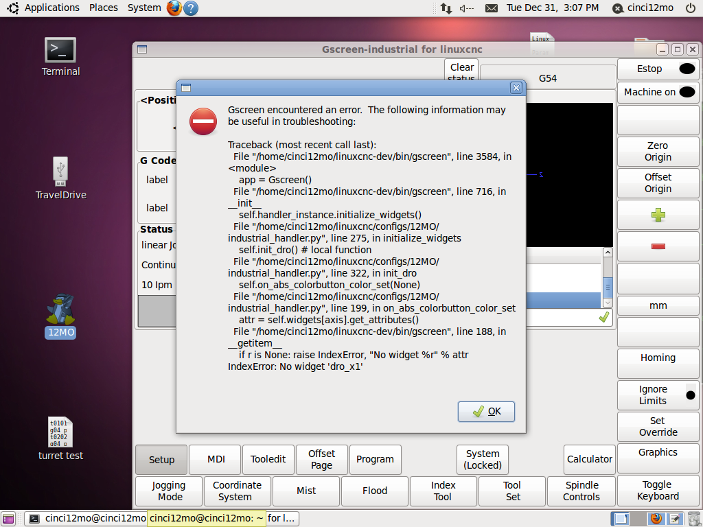

26 Dec 2013 23:22 #42032
by LAIR82
Hello Guys,
What is the proper format for the jog increment line in the INI file, here is mine,
INCREMENTS = 1.000, .1, .01, .001, .0001,
and I have tried numerous flavours of this and still get a fault when trying to change it.
Rick
Replied by LAIR82 on topic Gscreen - a GTK / Glade / Python based screen
Can you post the INI file.
I bet you didn't add the jog increment entry to the INI (TOUCY doesn't use it)
As for jogging - did you remember to click the on screen button 'jog' to enable jogging?
Chris M

- LAIR82
- Posts: 197
- Thank you received: 3
31 Dec 2013 07:16 - 31 Dec 2013 07:21 #42208
by LAIR82
I pulled that fix, now the increments work great. Thanks
But now I am back to trying to get the screen filled out again. I went into the glade file and clicked expand on all three boxes you mentioned and I keep getting a fault when trying to start up. I must have clicked/selected something else the other day when I actually got it to work. I will press on tomorrow and see if I can remember what I did.
Guess I need to start actually taking notes down on how I manage to stumble across making things work properly.
Rick
Rick
Last edit: 31 Dec 2013 07:21 by LAIR82.
