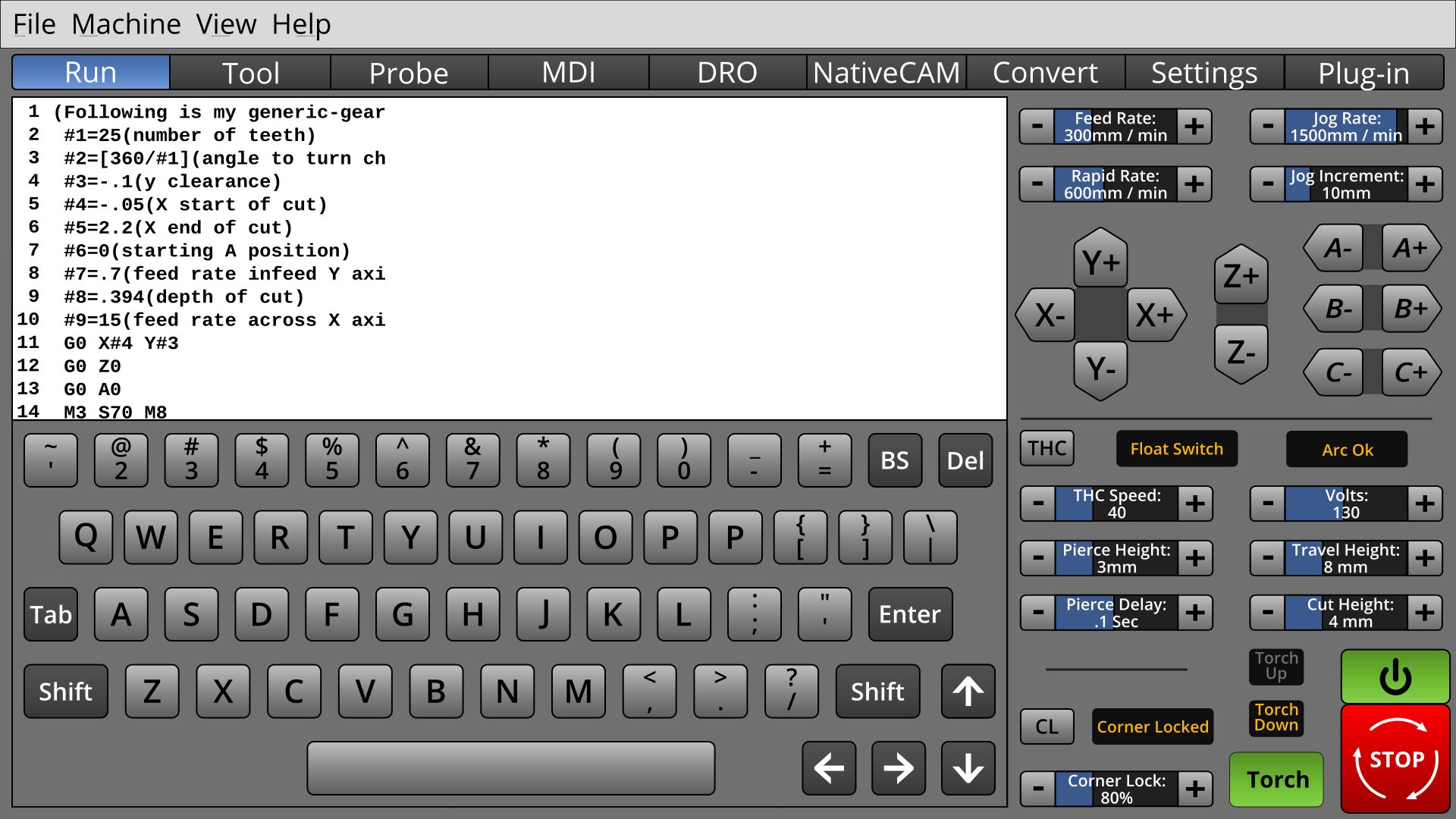

* Keyboard mockup now has spacebar, well and arrow keys : P The spacing varies from row to row. There's no scroll bars in the text window, but they would be there.
The on-screen keyboard needs a button to return to whatever called it.
The screen is unequally split horizontally to allow more room for machine controls.
A haunting question remains: DId Axis do it right by using a vertical strip on the right for machine unique controls?

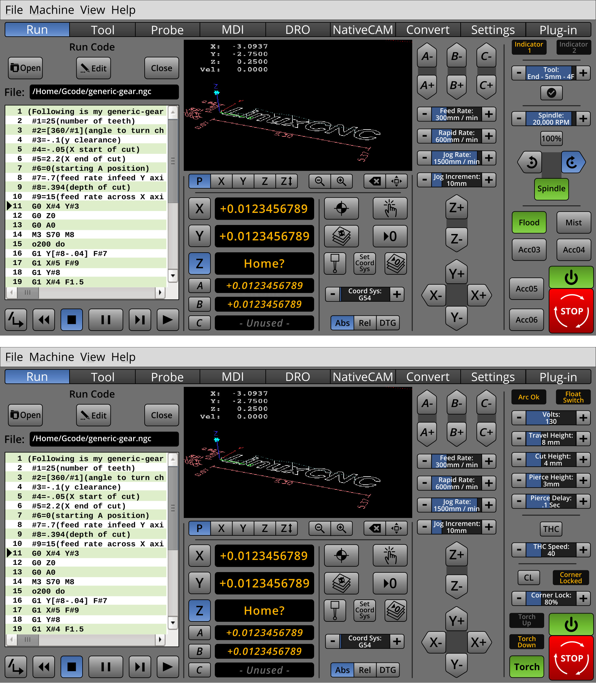

Well, this is the vertical experiment....
I broke up the direction buttons.
The indicators are smaller, so there can be more of them.
I will have to look at it with new eyes, but the Torch seems like a win, while the mill, seems like a win/lose, lose because the tool selector and the spindle control are as small as the others.
Comments?
Comments?

That looks easier to use to me, all related things in one column. I can live with that.

I like the new layout. It is not quite as aesthetically pleasing, but I think it is more practical. It makes sense to have the entire right panel machine specific, and potentially be able to be replaced with a completely custom panel. Technically, the power and estop buttons are common to all machines so they might should be somewhere else ...
One thing I would suggest considering is placing the X, Y and Z axis jog controls beside each other like the A, B and C controls. For me that is more intuitive than having them point in the direction of axis movement. But I understand that may depend on personal preference, as I tend to think of the jog buttons as increasing or decreasing the axis position values (which incidentally moves the table), instead of buttons for moving the table (with incidentally changes the axis position).
If you did move the X and Y job buttons, there would be room for the power and estop buttons below them ...
I am really enjoining watching this screen evolve and improve, keep up the great work!

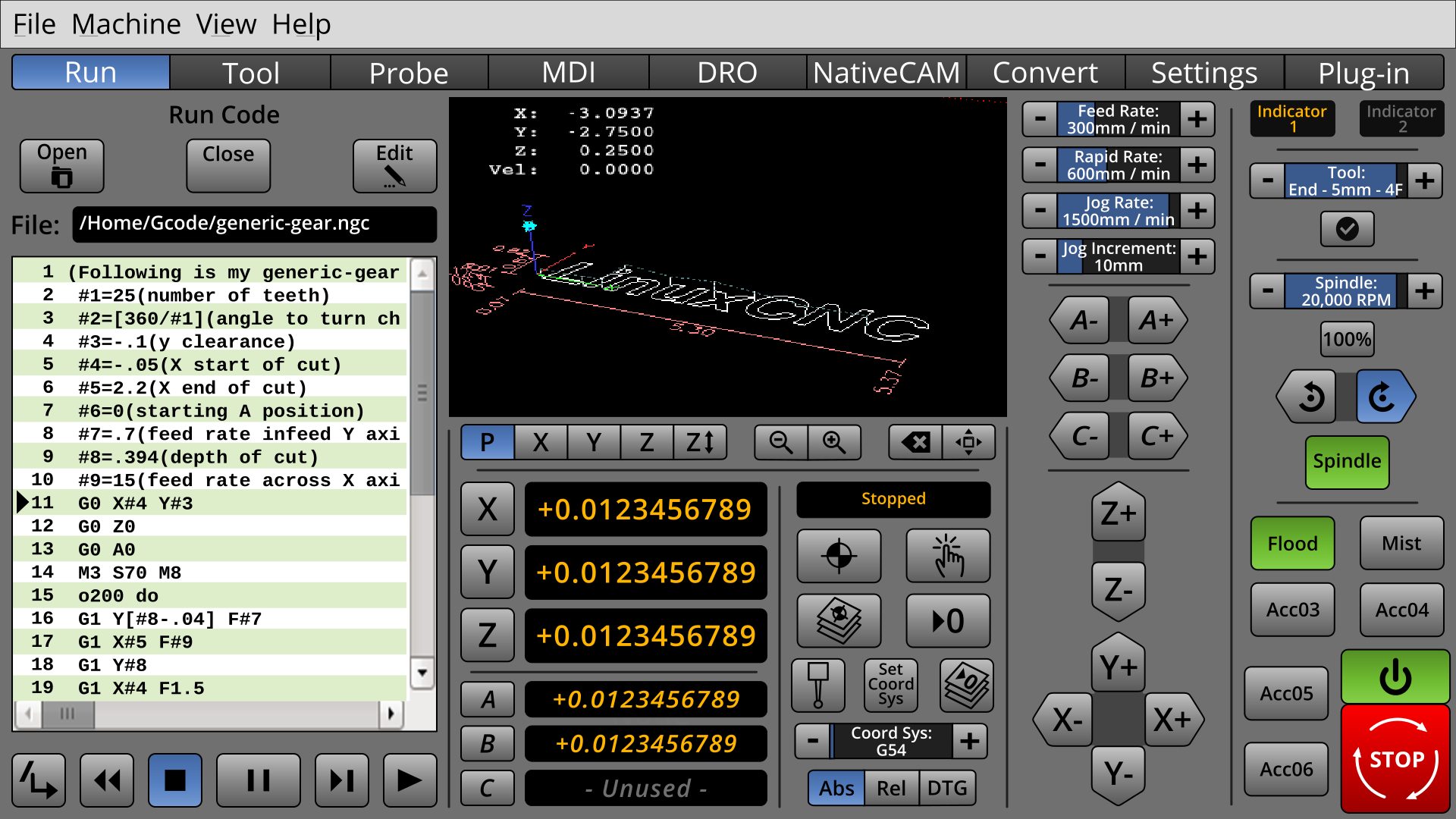

* Added a status indicator, though I've tried my best that what's going on can be summed up without it. I see it mostly as an error indicator.
* Because of the positive feedback, the way forward is with the vertical controls, such as in the last screenshots. I'm still moving controls around.
Originally, for mills, I planned to support 5 axis, but there's little difference between 5 and six, that I figured just to add one more, I wanted the user not to feel confined, nor TMI'ed.
I've tried to put the additional axis where the user doesn't have to look at them:
When the user is looking at the 3D window, 456 are at the bottom.
When the user is jogging 456 are at the bottom of the speed controls.
The hope is that a user would not have to relearn the control placement when walking back and fourth from a 3-axis to a 5-axis machine.
