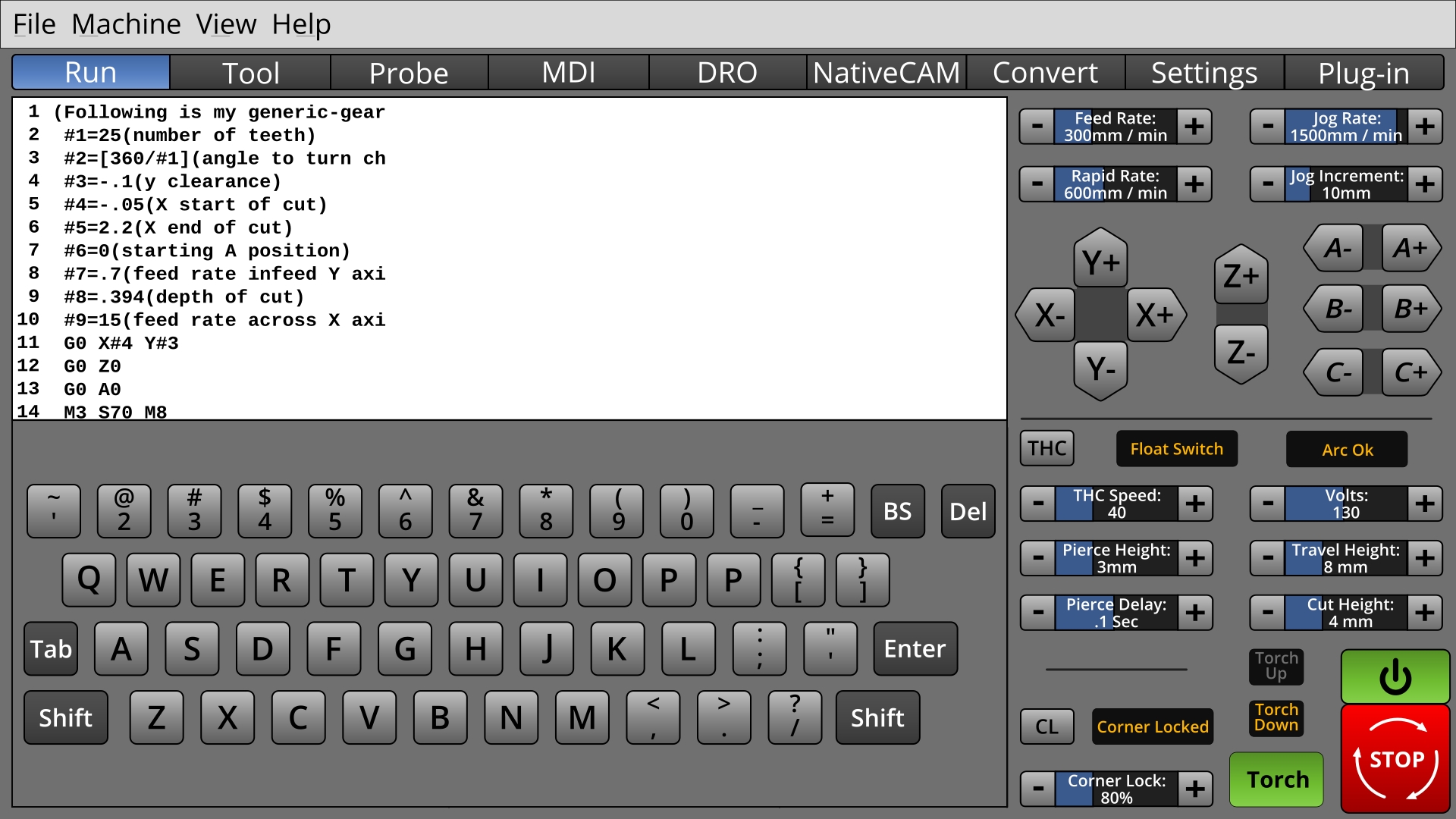

06 Jun 2018 21:54 - 06 Jun 2018 23:15 #111793
by BrendaEM
Replied by BrendaEM on topic A Widescreen Blender-Style Interface
* A rough on-screen keyboard mockup.
I would rather not ever cover up the machine EStop and power controls, but the user would probably have to be prevented from turning anything on when a keyboard or editing window is up.
This is the stuff that times time: to work out if things will work out.
Arrow keys should be fitted in there somewhere.
Edit: probably should have a spacebar, too : )

- Posts: 19899
06 Jun 2018 23:22 #111799
I think "Axis" was a poor choice in retrospect, but Gscreen, Gmoccapy and Touchy are all working OK in context. If it becomes a finished GUI then I will be typing the name a lot and favour a short name.
Replied by andypugh on topic A Widescreen Blender-Style Interface
Just to nip this in the bud: I am against naming things with names which are difficult to document.
