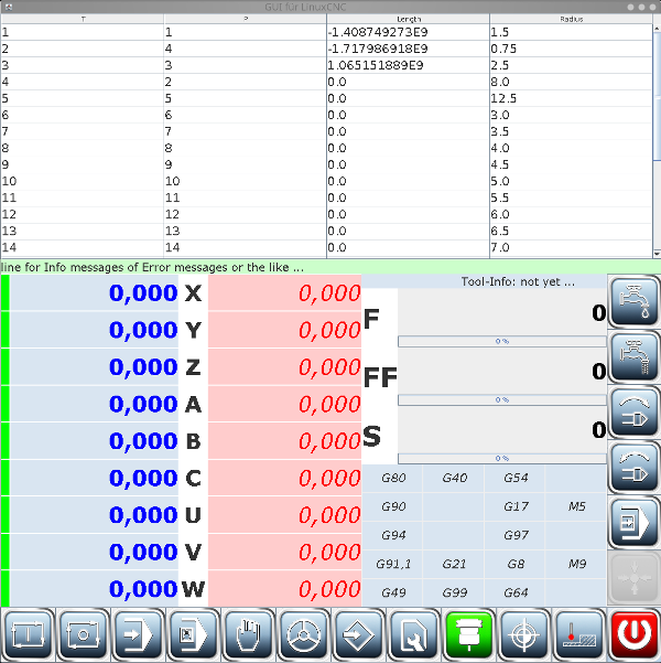

28 Sep 2019 18:49 #146499 by Reinhard
Java UI for linuxcnc was created by Reinhard
I'm pretty happy with the result of some weekend-codings ;)
The UI already works as a slave of axis, as well as standalone started from the linuxcnc config selector.
I found the tool definitions in status structure and the position dro change display according to the joint definitions.
What I did not find yet - how are the values from var-file synchronized between linuxcnc-tasks?
The point is, I want to add a page, where the offsets can be edited.
From what I found, the offsets are in the var-file. The status structure contains only the active fixtures - right?
So when I change non active fixtures or coordinate systems, how are they synched?
Do I write the var file from the UI or what is the right way to handle value changes?
I realized that the tool file is read from the linuxcnc-background-process and put into the status structure.
I did not find similar behaviour for the fixtures.

03 Oct 2019 00:42 #146922 by andypugh
Replied by andypugh on topic Java UI for linuxcnc
Most of the important data in LinuxCNC is passed about through the NML interface. Getting to that with Java might be something of a puzzle.
My understanding of the var file (and it isn't a very deep understanding) is that the file is only the persistent store to retain values through restarts.

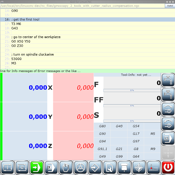

28 Apr 2020 07:24 #165918 by Reinhard
Replied by Reinhard on topic Java UI for linuxcnc
finally I was able to publish the project at github as JCNCSCreen .
Also available: basic docs .
If someone likes to try, I would be happy about feedback :)
cheers Reinhard

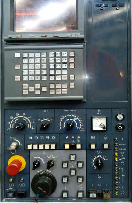

29 Apr 2020 05:09 #166056 by Reinhard
Hi Mike,
thank you for your interest.
I thought about that "minimalistic" - didn't think, that it goes into that drawer ...
On my last job, I travelled with the spindle in a cabin and I missed a moveable terminal a lot.
Now I'm working on a smaller mill with closed housing and stil without moveable terminal.
But this time, terminal contains a wheel and all known stuff from moveable terminals. So I don't miss it at all.
Current terminal looks like (pretty outdated, but so am I ;) ):
... and I'm going to build my terminal following that logic.
Of cause, I want all wheels and buttons be there as hardware controls.
Therefor the buttons in my app are used in the sense of a LED, not as usable buttons.
I hope to be able to manage control without the use of a mouse.
That might look weird in simulation mode, but I hope, its ok in real world.
So the ui-controll needs halui and my app is "just" a visualizer :)
I you miss anything, let me know.
cheers Reinhard
29 Apr 2020 07:03 #166058 by bbsr_5a
Replied by bbsr_5a on topic Java UI for linuxcnc
on thatt machine why dont you go for a XHC_hb06 handheld it holds all you need for movable terminal
and it is supported
