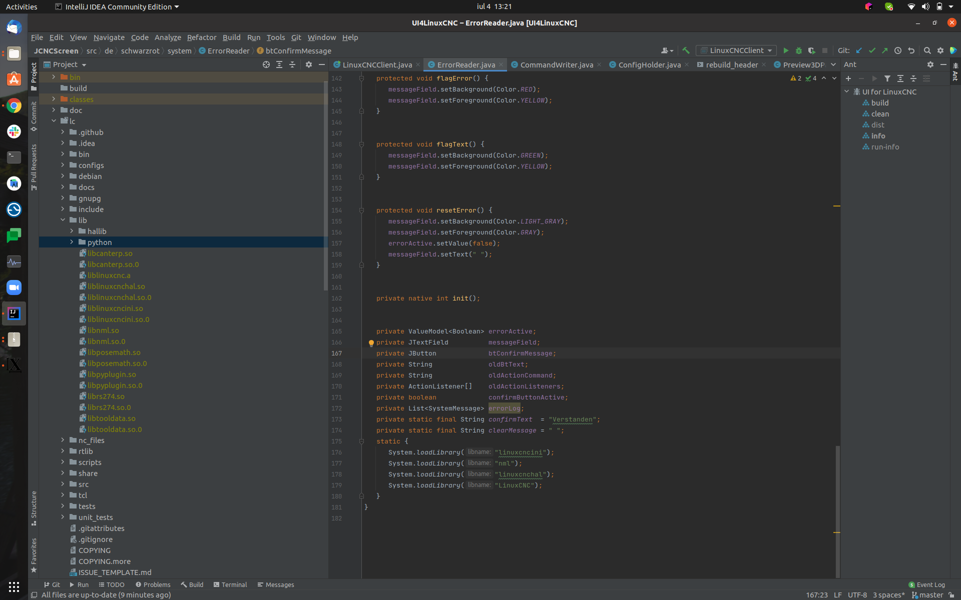

Just pulled the code, set up the dependencies, made the build, trying to get it running. I am using IntelliJIdea as an IDE.
The error I get when I try to run the app is:
local check: AppTitle == > JCNCScreen - frontend for linuxCNC <
populateTree ...
read ToolTable ...
Exception in thread "main" java.lang.UnsatisfiedLinkError: no linuxcncini in java.library.path: [/usr/java/packages/lib, /usr/lib/x86_64-linux-gnu/jni, /lib/x86_64-linux-gnu, /usr/lib/x86_64-linux-gnu, /usr/lib/jni, /lib, /usr/lib]
at java.base/java.lang.ClassLoader.loadLibrary(ClassLoader.java:2670)
at java.base/java.lang.Runtime.loadLibrary0(Runtime.java:830)
at java.base/java.lang.System.loadLibrary(System.java:1873)
at de.schwarzrot.system.ErrorReader.<clinit>;(ErrorReader.java:176)
at de.schwarzrot.app.LinuxCNCClient.<init>;(LinuxCNCClient.java:122)
at de.schwarzrot.app.LinuxCNCClient.main(LinuxCNCClient.java:494)
I have noticed that the ErrorReader class tries to load the following libraries.
static {
System.loadLibrary("linuxcncini");
System.loadLibrary("nml");
System.loadLibrary("linuxcnchal");
System.loadLibrary("LinuxCNC");
In the project I can see a folder named lc with symlink to the folder where linuxcnc was build from sources. Inside lc/lib folder I can see that it contains these libraries but all of them have lib in front of their names. See the attached screenshot.
If you have any ideas what I'm doing wrong..please let me know.

Did you built the project using ant?
or did you built it from IntelliJ?
If the later is true, you'll need to issue a "make" in native directory.
When you use ant, it will create a directory "runtime", from which start of the app should work. Below "runtime" you'll find a directory "misc" which contains a script, which includes the runtime parameters to start JCNCScreen.
Eclipse puts the compiled binaries into different locations, so eclipse needs different startup options too. May be its similar for IntelliJ?
On eclipse I have set the working directory to the path where eclipse puts the binaries, then I have VM-argumentsand finally I have application parameters set to:
-Djava.library.path=${workspace_loc:UI4LinuxCNC}/native:${workspace_loc:UI4LinuxCNC}/native/lc/lib
-splash:${workspace_loc:UI4LinuxCNC}/native/lc/linuxcnc.gifportrait
-base ../exHdr

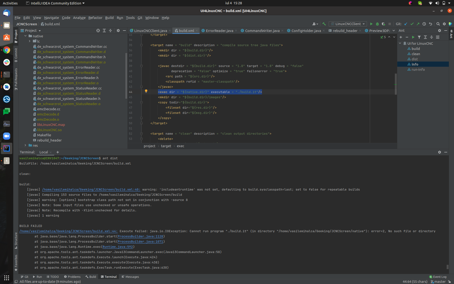

I was running from the IntelliJ, I've issued that make command and now some more files have appeared to that native folder.
Then I tried running ant dist from terminal, being in the JCNCScreen folder. Here is the output that I get.
Indeed the native folder does not contain any "build.it" file.
What I'm I missing?
What I'm I missing?

I changed native stuff from hardcoded build script to makefile and forgot to change ant-script.
Just issue a "git pull" and it should work.

Indeed it worked, it went a bit further but the zip was not yet created.
vasilemihalca@INV1047:~/Geeking/JCNCScreen$ ant dist
Buildfile: /home/vasilemihalca/Geeking/JCNCScreen/build.xml
clean:
build:
[javac] /home/vasilemihalca/Geeking/JCNCScreen/build.xml:40: warning: 'includeantruntime' was not set, defaulting to build.sysclasspath=last; set to false for repeatable builds
[javac] Compiling 153 source files to /home/vasilemihalca/Geeking/JCNCScreen/build
[javac] warning: [options] bootstrap class path not set in conjunction with -source 8
[javac] Note: Some input files use unchecked or unsafe operations.
[javac] Note: Recompile with -Xlint:unchecked for details.
[javac] 1 warning
[exec] make: Nothing to be done for 'all'.
[copy] Copying 49 files to /home/vasilemihalca/Geeking/JCNCScreen/build
dist:
[jar] Building jar: /home/vasilemihalca/Geeking/JCNCScreen/runtime/JCNCScreen.jar
[zip] Building zip: /home/vasilemihalca/Geeking/JCNCScreen/JCNCScreen-bin.zip
BUILD FAILED
/home/vasilemihalca/Geeking/JCNCScreen/build.xml:88: Problem creating zip: /home/vasilemihalca/Geeking/JCNCScreen/runtime/exHdr
Total time: 3 seconds
clean:
build:
[javac] 1 warning
dist:
BUILD FAILED
